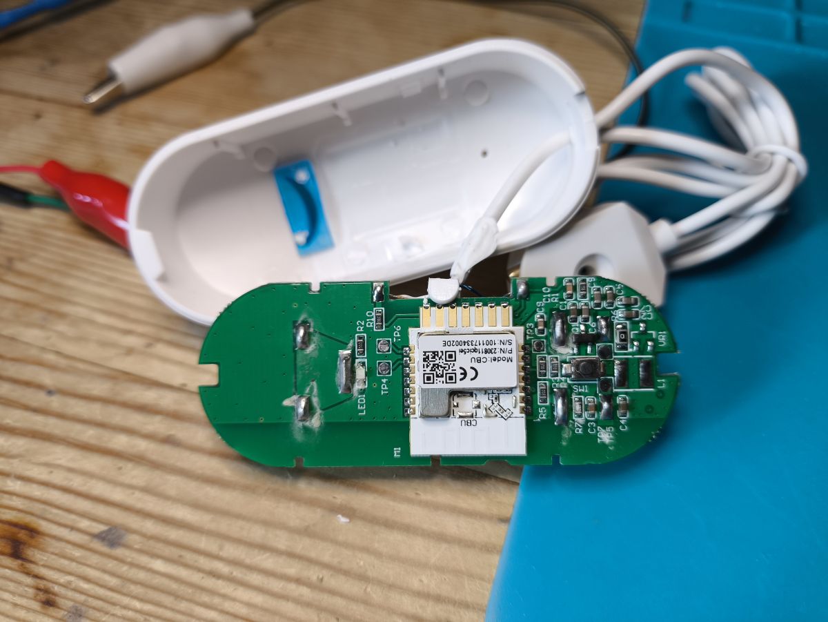

    Photo of a circuit board featuring a CBU module and a pinout diagram.

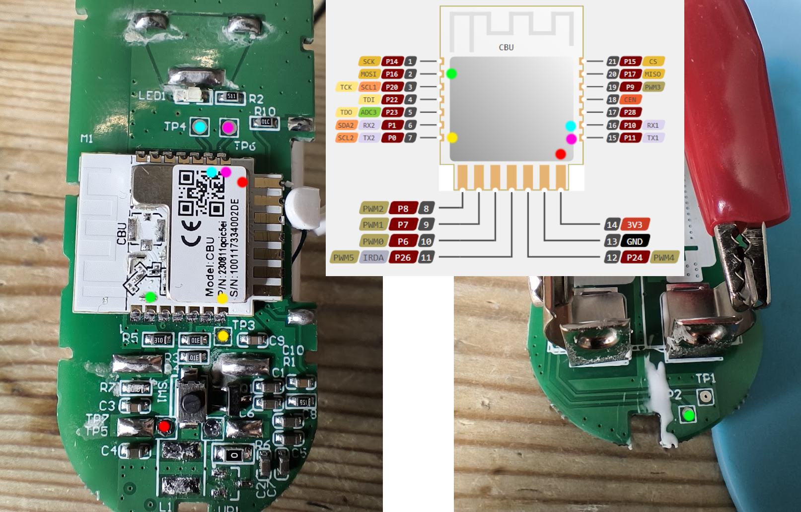

    Same situation as this device https://www.elektroda.com/rtvforum/topic4056568.html. Bought a few door contact/water leak sensors hoping for an XR809 module, but got CBUs and a CB3S. May as well post for the device list and somewhere for future discussions about each type for other users. This is a CBU/BK7231N version of this https://www.elektroda.com/rtvforum/topic4052871.html#21086916
    Factory dump attached. v1.0.6 so cloudcutterable.
    Screenshot of a water detection app showing the status Normal. Device update screen indicating no updates available. App screen showing water sensor addition. Packaging of water leak detector model SW100. Packaging of the Wi-Fi water leak sensor SW100 with a barcode. Electronic circuit of a water sensor with an open casing. Circuit board of the Smart Life Flood Water Leak Detector with visible electronic components.
    Easy UART is able to extract the pin config for this one
    there's mention of a sound pin and bz frequency but P8 doesn't trace anywhere I can see (not to L1 or URI missing component pads). The TP pads trace to:
    TP1 and TP5 (or TP7?) could not be determined. Maybe one goes to P21/SDA1 on the back of the CBU where I cannot reach.
    Basic starter autoexec:

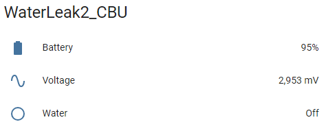

    Could probably get fancier with dry/wet sensor state, instead of on/off, in HA. And a nice automation to raise alarm and/or send an email when water is detected. Device won't currently stay awake if water is detected with above script.
    Device does wake from deep sleep on button push and on sensor state change. Successful MQTT connection required.
    Screenshot of the WaterLeak2_CBU device interface showing battery level, voltage, and water status.
    OBK template:
    https://github.com/OpenBekenIOT/webapp/commit/a29bbb6a5e69cf000c920834f31038ee75c9c5a1

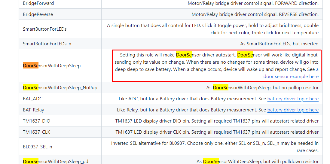

    Also, I wasn't yet sure if there was any practical difference between using dinput Vs door sensor. Door sensor obviously looks a bit wrong aesthetically in the gui but...
    I did use door sensor on the contact sensor with alarm device but was wondering if it should be changed for dinput.
  • DoorSensor pin also triggers driver autostart
    #4 21097621
    Posts: 14767
    Rate: 12906
    Oh the answer to the "difference" question is actually in our docs:
    Table with a description of DoorSensor function and its auto-start in deep sleep mode.
    DoorSensor pin is the same as dInput, it's just also linked to the driver and will cause driver autostart. That's because some of the users may prefer to have their devices working withour scripting and just setting a DoorSensor pin is easier than writing/copying autoexec.bat.
