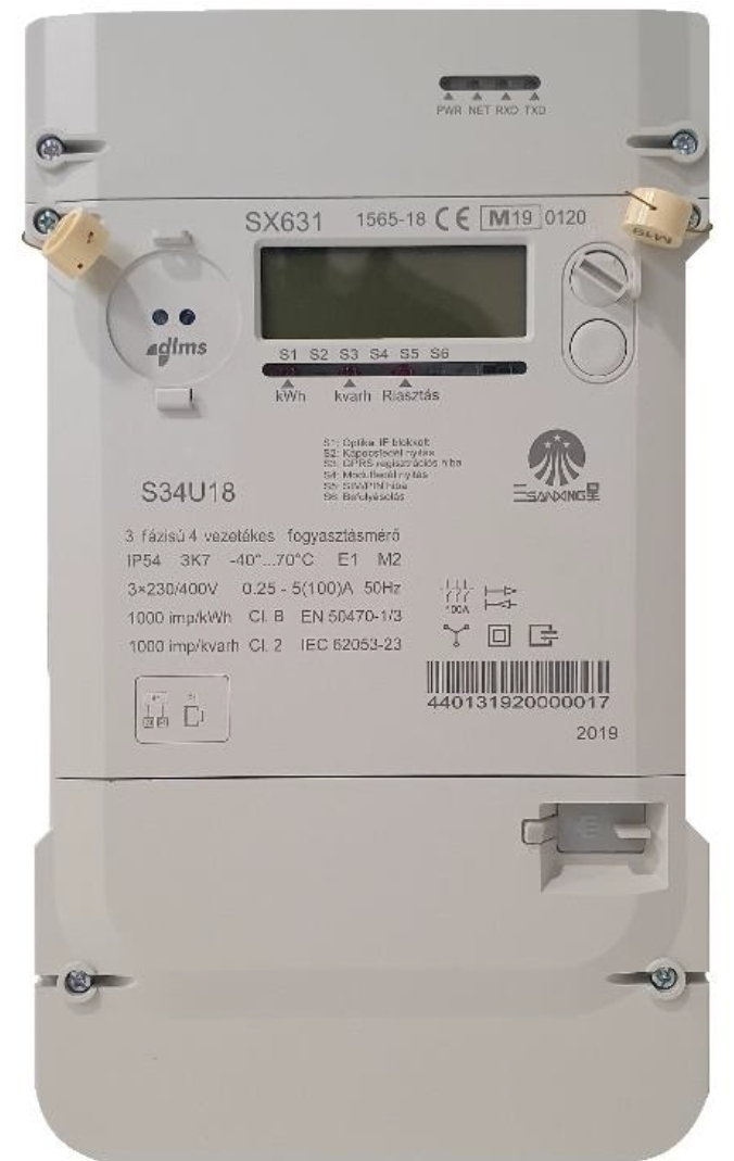

    I set up a 2-way counter for the PV with a symbolic name (I don't see another one): S34U18. For a few weeks I have no access to www.eTauron meter, and the LED on it marked "NET" is blinking yellow, so I suspect a problem with communication via the cellular network. If you know this model, please help - it looks like the one in the appendix:
    1.is there is any way / button to force communication, because you have been told to wait until the meter sends data, and this may never happen. Just in case, today I reported a transmission fault and it was even accepted
    2.Can I read the data from this meter directly on the computer, or how to do it?
    3. there is a poor mobile network in the place where the box is located - is it possible to add an antenna to this abacus?
    Regards

    In my case, the net diode flashes green in this meter, so you may have a problem with the range.
    However, the Tauron system does not see him. I hope it will surprise you someday.

    I have a version with sealed port P1 so I couldn't test:
    https://tasmota.github.io/docs/P1-Smart-Meter/
    They still assemble them at the Magyars and I found this solution there.
    It remains to wait, someday they will finally start the elicznik.

    I don't even know what this P1 port is, but the meter is sealed from top to bottom. The only thing I have available is a button for the carousel and an optical port. I'd be thrilled if one meter worked with this but I emailed them two days ago and it's still deaf.

    Do you have the same counter as in the photo in the first post?
    The P1 port is the RJ12 connector on the bottom right under the flap.

    I have this model of the meter, but the photo is with the cutout for this port. For me, the cover is completely full without any cutout and sealed, so I have no access to this port. As I wrote: I only have access to the optical port and one button to the OBIS carousel.
    I found this P1 that it is a telephone connector like for old dial-up and neostrada modems - ingenious, but unfortunately for me it lies under sealed plastic.

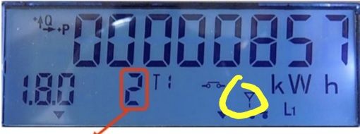

    You have a range indicator on the display.
    Upload a photo.

    The net LED flashes green.
  • #24 19660477
    keysim1986
    Posts: 10
    Rate: 7
    This LED flashes continuously. Regardless of the range.

    Unfortunately, I do not have the key to this box and it will not take a decent photo through the plastic sight glass. After entering the tauron elicznik website, there is no data in the computer and it does not enter at all on the mobile application - it hangs on the page with the tauron bulb logo distribution. There is no indicator on the display as I look - which one is it? Anyway, maybe I will call the Tauron hotline one day, so they will help.
  • #26 19660546
    keysim1986
    Posts: 10
    Rate: 7
    They won't tell you anything on the hotline. As already, write to eLicznik(_at_)tauron-dystrybucja.pl
    And the indicator is the one marked in yellow

    For me, there is only a triangle without these lines down.
  • #28 19660605
    keysim1986
    Posts: 10
    Rate: 7
    So no coverage. As a result, no transmission and therefore no data in the elicznik service.
