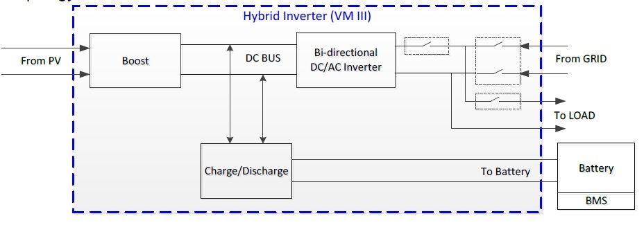

How should an AZO Digital ESB off-grid inverter be wired into a 3-phase house installation so it powers only a separate circuit without overloading the inverter, and should its earth/neutral be bonded to the existing grounding system?
Wire the ESB to a separate protected circuit after the main switch, bond the inverter N to PE at the meter/switchboard as the TN-C to TN-CS split, and do not ground the PV DC conductors; only the panel frames/structure and the inverter housing get PE [#20093464][#19848114][#20108698] The inverter has no galvanic isolation and no PE on the AC output, so the AC side behind it should be treated like a TN-S arrangement with RCDs and overcurrent protection on the inverter-fed branch [#19848114][#20093464] One working example connected the inverter feed from the meter bus through an extra small switchboard with protections, then disconnected the chosen house circuit from the main board and reconnected that circuit to the inverter output [#20093464] A phase-switch failure was attributed to incorrect N wiring, specifically not having the N path arranged as expected before the inverter output came up [#19688494]

    Hello dear group members,
    I have a question for rademenes 787.
    Is the N output of the ESB finally grounded? I.e. the TN-CS installation with N and Pe separation in the main one goes to the circuits?
    Do they work in this configuration?
    It's kind of interesting because:
    1. ESB series inverters do not have galvanic isolation, therefore there is no PE output on the AC output link.
    2. The lack of galvanic isolation means that with a correct system (no damage) everything can work, but if:
    a. you have grounded pv modules and the insulation of the panels is punctured, the inverter may catch fire
    b. you do not have a grounded pv installation, in the absence of galvanic isolation, in my opinion N at the output of the inverter may "float" (there may be differences in potential in relation to the ground), so I am very interested in whether you have grounded N from the ESB output??
    Thank you in advance for your answer.
    This is not the case with the grounding of the panels, the panels themselves, i.e. their housing/frame and the structure on which the panels are placed, can be grounded, only solar wires must not be grounded, neither plus nor minus in the absence of galvanic isolation, as stated in the "Safety Instructions" " in the Off Grid ESB inverter manual, point 11, quote. The inverter does not have galvanic isolation. Do not ground the power cables of the PV installation, it may damage the device."
    After that, the ESB is additionally connected to the ground using a dedicated screw on the housing.

    Fact:
    1. The ESB has no galvanic isolation
    2. ESB has no constant phase output!!!
    ...which makes the whole project very dangerous. Plugging into the inverter installation in this way may result in serious consequences.
    Is the N output of the ESB finally grounded? - YES, i.e. it is connected in the switchgear with the PE cable at the meter, so "as if"
    I.e. the TN-CS installation with N and Pe separation in the main one goes to the circuits? - Exactly as written above
