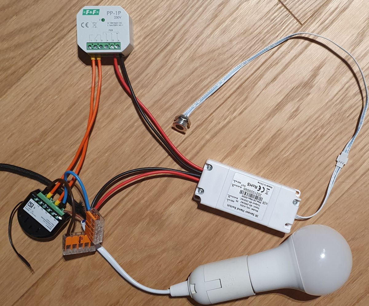

    I'm looking for a way to control the lighting under the kitchen cabinets both via IR switch and Fibaro dimmer. I would like them to work in parallel. Is there any way to connect the IR switch to the dimmer as a switch? Is there any way to do that?

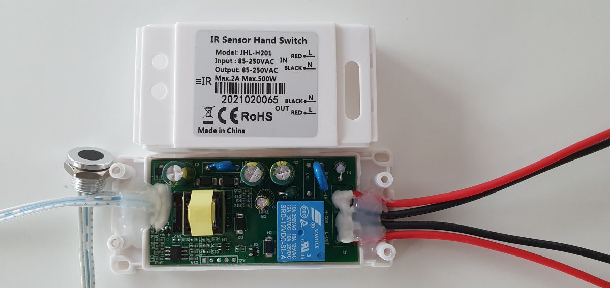

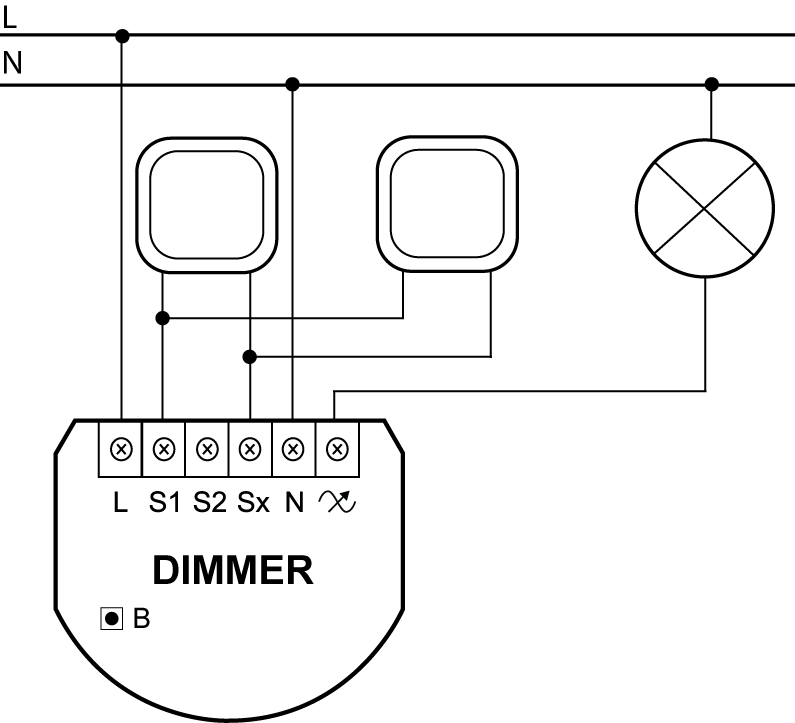

    It would be possible, but you would have to change the IR switch to output potential-free contacts instead of voltage, which you connect between S1 and Sx.
    An alternative is to put another relay with a 230V coil at the output of the IR switch.
  • #3 19677774
    eXistenZ666
    It works. Thank you!
