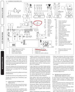

    As well as a connector on the motherboard for the controller, the oven also has some sort of connector for the BUS, but as there is no documentation available on this other than the one diagram below, it's hard to see what this is for.

    Re.1 I am not aware of anything. Maybe it uses Openthem or its own protocol.

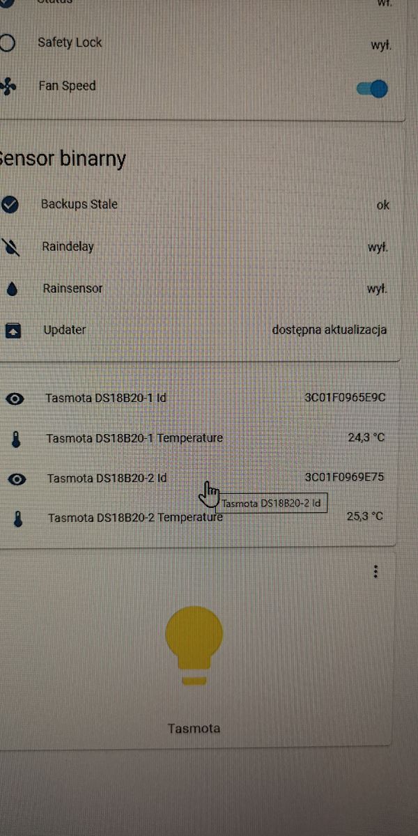

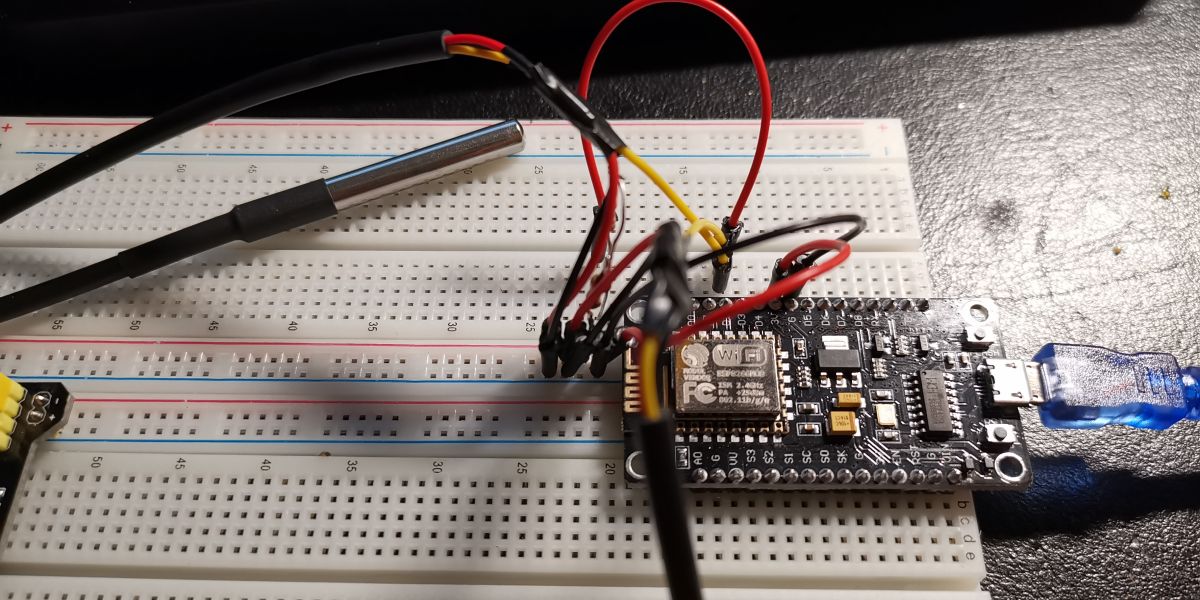

    Integrating Immergas Vitrix Superior 26kW ERP2 with Home Assistant for Metering .
    The project has started, tentatively the prototype looks promising, thanks for the tip.
    I just have some problem with the router, it kinda keeps disconnecting from the wifi of this module. Once it connects, it's ok, but when it restarts it can get into a pileup and breaks the connection every 10 sec.

    Read the logs from the Tasmota console. There it should write out what the problem is.

    Well, from my own. I wrote to immergas Poland. They were able to describe as much to me.
    "The boilers of the Superior series communicate with the controller via BUS protocol, 15-24 V supply.
    We do not have details of the protocol itself, I assume it differs from dedicated protocols."
    Representation for Poland. I don't assume in advance that they don't know, maybe they can't share. Surely such a Tybox controller manufacturer knows the protocol, because they officially support this cooker.

    Hello, I would like to ask you, if you have some progrss? I have the same boiler and would like to try to connect it to OpenTherm gateway conneted to ESP mcu board. I can’t decide where to connect the OpenTherm gateway. According to wiring diagram, I’m deciding between screws 42/43 (“smart” thermostat) or 41/44 (IMG-BUS - your way). In service documentation is screw 41 marked as GND, so it shouldn’t affect the dry contact between 40 and 41 (I hope).
    Now I!m in the situation - I have connected OpenTherm adapter (https://ihormelnyk.com/arduino_opentherm_controller), with added LEDs for Tx and Rx. I only see the Tx LED blinking, but not Rx. Surely I could have some mistake in the PCB (made on the prototype board), I know.
    But I would like to ask you, if you were successfull with reading data from IMG-BUS pins?
    Thank you in advance. Pavel
