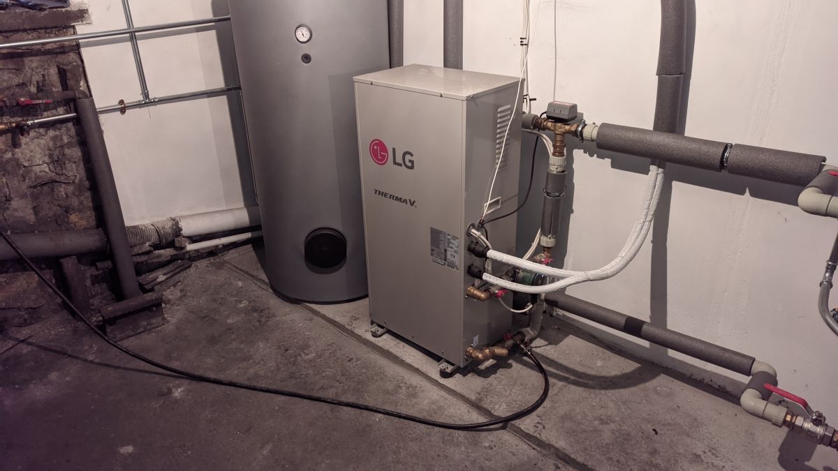

    Hello, I have such a topic, I want to protect myself against a power outage, exactly the protection is to apply to the heating system, in this case the heat pump, there are also three refrigerators plus small LED lighting, the first ideas fell on a power generator, but what kind? The heat pump has a power of 13 kW, the most important thing is that during frosts, in the event of a power failure, the installation does not freeze, I am asking experts on the subject to comment on this issue, how to protect yourself?

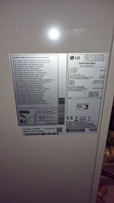

    I have already convinced myself that it is not possible to power the heat pump, he adds a photo of the plate from the pump, so the situation in the yard is frost and there is a power failure, what should I do to prevent the house heating system from freezing? Is a UPS for circulation pumps enough? Maybe someone out there has one and can give me an idea Heat Pump Protection: 13kW Emergency Power Supply & Generator for Outage - Types & Suggestions

    Mlucas wrote:
    The heat pump has a power of 13kw
    This is the "thermal" power, what current consumption?

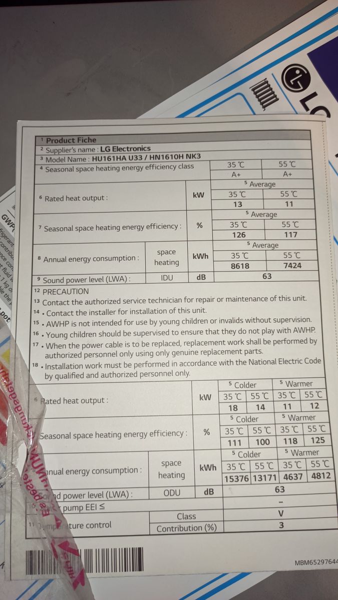

    Mlucas wrote:
    power to the heat pump is not possible
    And what does this mean, because in this table there are kW of heating power. The demand for electric power will be at least 2x lower (even in frost). I would be more worried about the sensitivity of the heat pump's electronics to powering the aggregate, which will generate low-quality voltage. It is about any deviation from the ideal voltage sine wave.

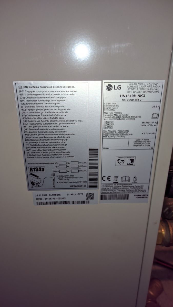

    If you believe that the 126% from the rating plate is the efficiency of the pump (the one with a heating power of 13kW), it turns out that it takes as much as 10kW from the network. But that's a bit too much...
    And no, sorry, the manual says that the COP of this pump is 4.26. So the power consumption is about 3 kW. However, this is a bit too optimistic, heat pump manufacturers usually slightly "cheat".

    Looking at the plate, it is max 4_5kW
    So nominally from 3 to 3.5 kW
