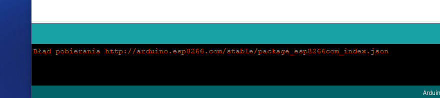

    I fired up Arduino today and my ESP 8266 board disappeared in the board manager.
    • Configuration of ESP8266 as UDP server with RS232 - IP 10.10.2.1, port 22000, AT? arduino.png (8.17 KB) You must be logged in to download this attachment.

    heyka
    Posts: 412
    Rate: 56
    is not visible
  • #18 17828720
  • #19 17828728
    heyka
    Posts: 412
    Rate: 56
    address is posted , but I have a download error message as I have attached on screean
  • #20 17828737
  • #21 17828743
    heyka
    Posts: 412
    Rate: 56
    At my place yesterday everything was OK, strange, Arduino doesn't like me. Something makes me think I'll stick with C and Eclipse

    heyka wrote:
    I fired up the Arduino today and the ESP 8266 board disappeared in the board manager.
    But how did it disappear, did you manage to install it? If you can't connect to the Arduino IDE somewhere, it's not likely to be a problem of network blocking software. Confirm by trying to fire up the library/board manager. The program in the first link from @khoam works OK, upload, test, disable what you don't need, upload, test, add what you need from the UART side (I recommend the serialEvent example), upload, etc.
  • #24 17829051
    heyka
    Posts: 412
    Rate: 56
    I can't upload because I don't have a board available in Arduino in the board manager, yesterday I installed it was available,and today I turned on Arduino and it's not there and I can't install it.
  • #25 17829056
    kaczakat
    Posts: 1748
    Help: 317
    Rate: 231
    Well, download again/uninstall/install, you didn't have the day before yesterday so it's a small loss too. It will go faster the second/next time. There are also ZIP versions, which do not require installation.
