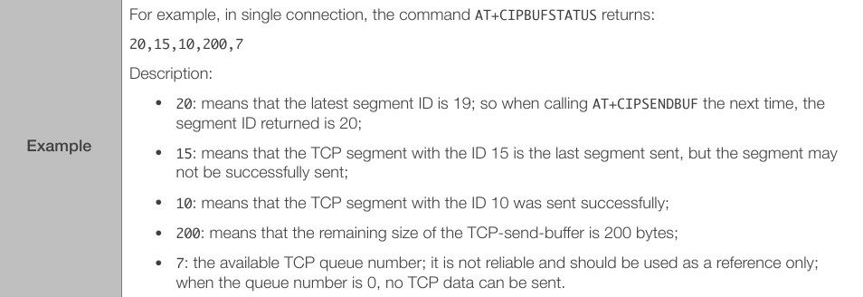

    I receive: 1,0,0,2920,8
    What does this mean? ;)

    khoam wrote:
    Run this AT+CIPBUFSTATUS a few times and see if anything changes.
    I run this command repeatedly (as you told me to do before) and each time I get the same thing, nothing changes.
