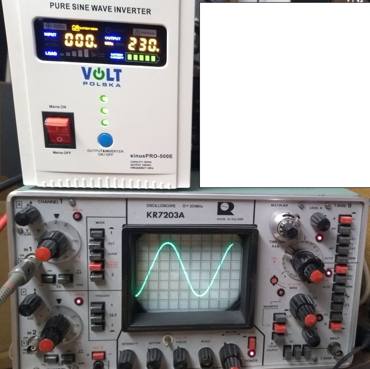

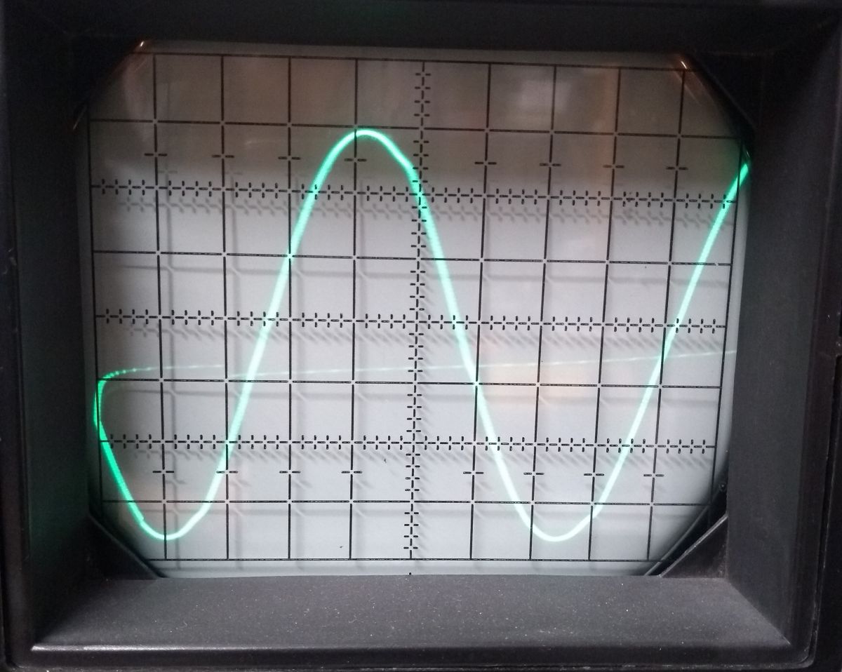

    hevet2 wrote:
    Real vorlog, not a fairytale
    Well, I promised, let's go. Saturday, traditionally a working day for cottage needs.
    I put together the "installation" of the emergency power supply for the circulation pumps of the boiler room, I do not post photos because I did not want to clean :)
    The most important - SinusPro500E, the waveform (damn, whether under load or without) looks like this (I blurred it unnecessary :P )
    Choosing a 2000W 4-Stroke Generator for Home: PSMtools PS-AP2600 vs Graphite 58G903 with AVR Choosing a 2000W 4-Stroke Generator for Home: PSMtools PS-AP2600 vs Graphite 58G903 with AVR
    I took the measurement with the converter disconnected from the mains, only the battery connected. Oscilloscope probe connected through a 1:100 divider (1M? and 10k? resistors ;)
    So it's not bad, the sine is quite shapely - it's powering the pumps after all, not the operating room in infectious surgery :)

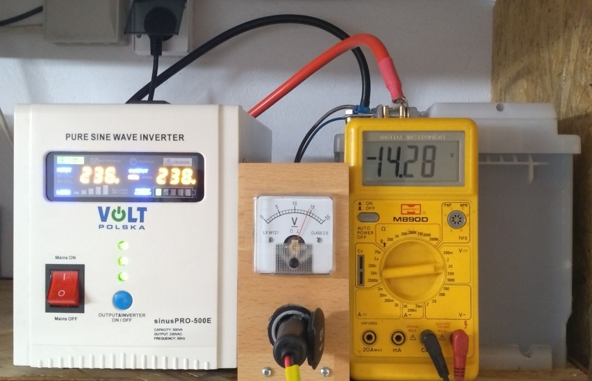

    Power plant included - added "panel" with a voltmeter and a 12V socket (from an ashtray from Mercedes W211, what!) Serving either for charging with a source other than the converter, or as a source, I don't know why, but ... Multimeter for the time of checking actual charging voltage. Normally, the system will be turned off - if something is wrong with the power supply, it is a matter of switching the power supply of the boiler room to the emergency set. Hence the voltmeter to view the state of the battery.
    In the picture in battery charging mode
    Not great quality photos, but I didn't feel like leaving my atelier to show such crap :D And that would be it.

  • #35 19732492
    hevet2
    Level 32  
    Posts: 1401
    Help: 216
    Rate: 619
    Vorlog has restored my faith in "Polish" companies ;) respect for the work done.
