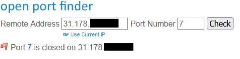

    gkwiatkowski wrote:
    Use some website to check for open ports and see if anything is open.
    I am using https://www.yougetsignal.com/tools/open-ports/
    But here I have a small eclipse, I use the "netstat -a" command on the server to list the ports, but it does not connect me to any selected one (shows that it is closed). How do I find some reliable port that should show the actual status? Must be in listening mode? All of mine are currently connected (busy).

  • Need a listening port to verify forwarding status
    #42 19735523
    gkwiatkowski
    Posts: 4683
    Help: 650
    Rate: 1230
    Ping, by default, is on and responds.

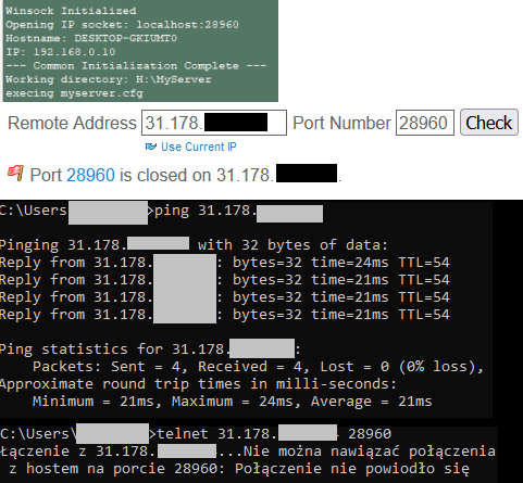

    When you run the server on your computer, do you have to give it its own IP address and port number? Maybe the port number alone is enough?
  • #47 19735590
    Aramis93
    Posts: 101
    If I don't manually point it to an IP, it starts by default on localhost: 28960
  • #48 19735598
    gkwiatkowski
    Posts: 4683
    Help: 650
    Rate: 1230
    Aramis93 wrote:
    And that's how it is supposed to start.
    Try scanning port 28960 now.
  • #49 19735630
    Aramis93
    Posts: 101
    gkwiatkowski wrote:
    Try scanning port 28690 now.
    I will answer graphically :D

    28960 is the TCP port on which this server is listening?
  • Need to verify local and external server access
    #51 19735708
    Aramis93
    Posts: 101
    Yes, it should, but now I check and although it shows in the logs that it works, even locally I cannot connect to it through the game client ... I have to check what is going on there, but this is when I get home. I just point out that I rummaged it all over the weekend, but it worked before that ;)
    At home, I will check locally, how it works, I will check externally, if the meatball continues, we will continue.
