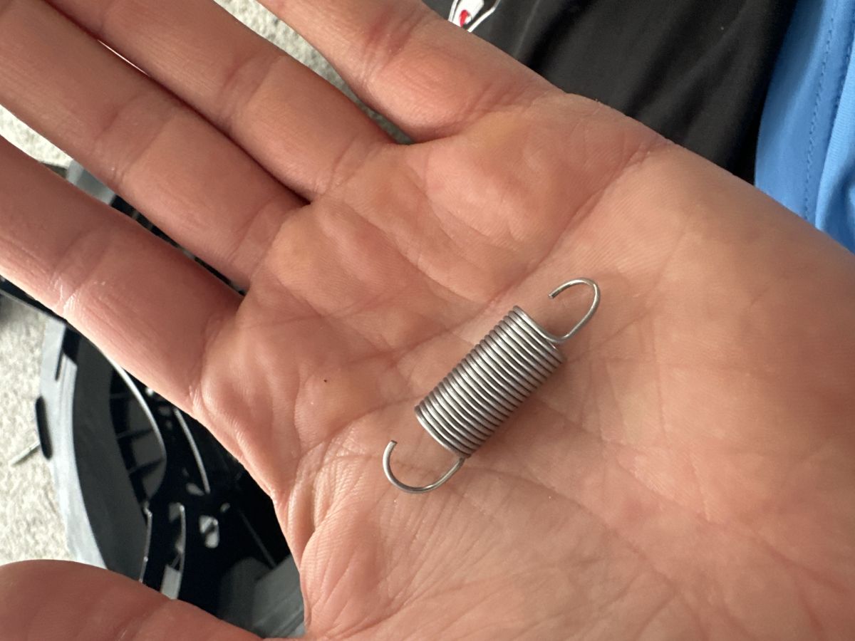

    Hello everyone,
    does someone know wherr this spring should be mounted? There are 2 of them. I forgot to take a picture when I was disassemblimg it.
    Trank you in advance.
    Small extension spring held in an open hand

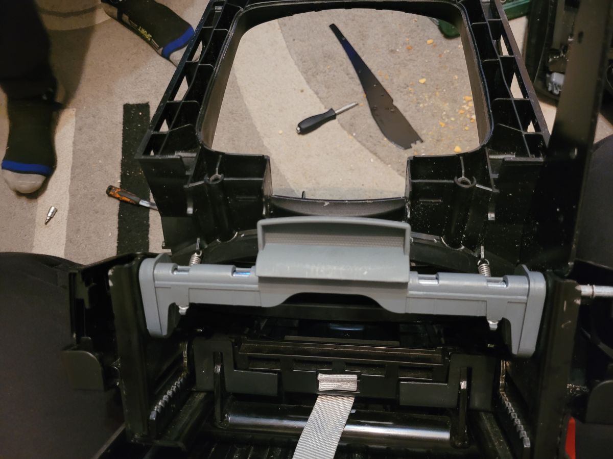

    Hi. Could someone please show in pictures where the bars should be fitted? I know the locations of three and the fourth one totally doesn't fit me.
    Spring com. above
    Inside a black plastic housing with a gray flap and side springs; a screwdriver lies in the background Interior of a black plastic housing with a gray piece and springs; tools lie on the carpet behind Close-up of a black mechanism with a metal spring and lever; a finger points to a part inside the housing.
  • Video links for spring and bar placement

    dimaoodm wrote:
    Hello everyone,
    Hi, I've solution for you, watch this: https://youtube.com/shorts/sVpm5JHUOPI?si=0iuPLIxOCGm7oUt3
    Proszę sprawdzić tutaj: https://youtu.be/HoQUM8HDR7M?si=49yoW2O6gZpkkK8J
