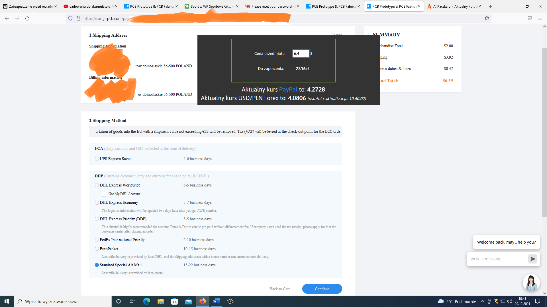

    @zgierzman I ordered the board by regular shipment, which takes a month. I will see the current prices soon (maybe something has changed). I remember that the first order was for PLN 8 ($ 2 with free shipping), then about PLN 30, and if you ordered 2 or 3 projects in one shipment, each subsequent order was for + $ 4 to the basic price.
    Added after 30 [minutes]:
    zgierzman wrote:
    It has become a bit more expensive recently. I paid $ 12.66 for 10 100x100 tiles at the end of September, which is about PLN 50 at today's rate. Shipping is $ 7.66, or about PLN 30. As of today, the cheapest shipping is actually $ 10.50.
    Another thing is that $ 5 for tiles and (even) $ 7 shipping (I can't remember cheaper) is a bit more than PLN 30 :-)
    You scared me a little that it was so expensive :cunning: I have it as it was and always the price of $ 2 for the first order in a package, I don't know what it depends on.
    Screenshot of an order summary page with shipping options.
