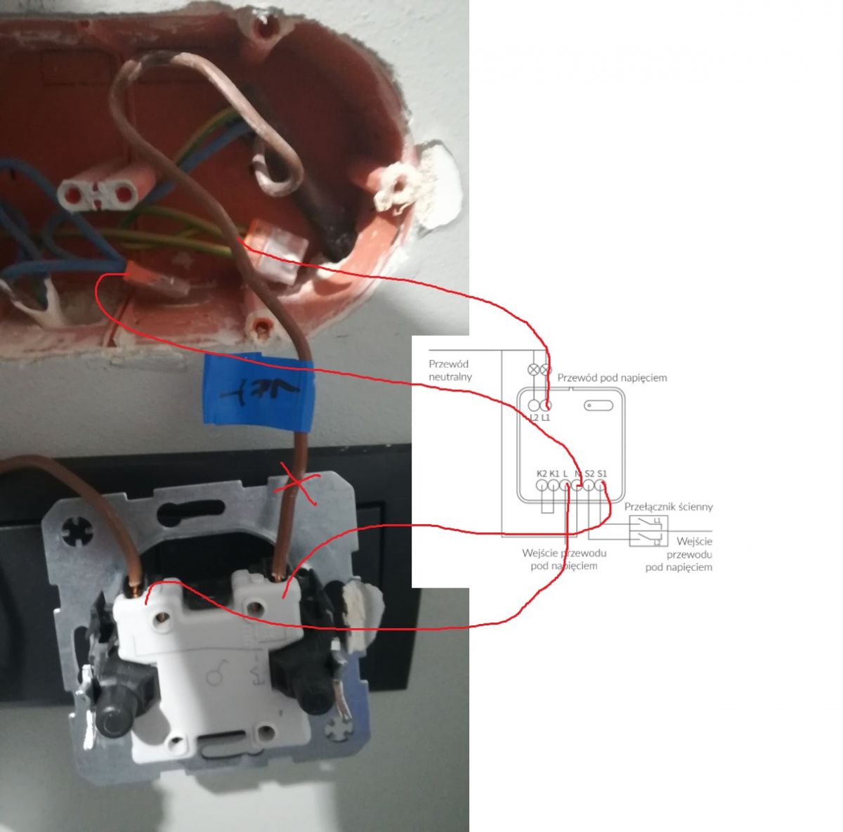

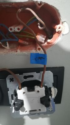

    Hi, I would like some help with connecting the YLAI002 module to a switch, single, one external light.

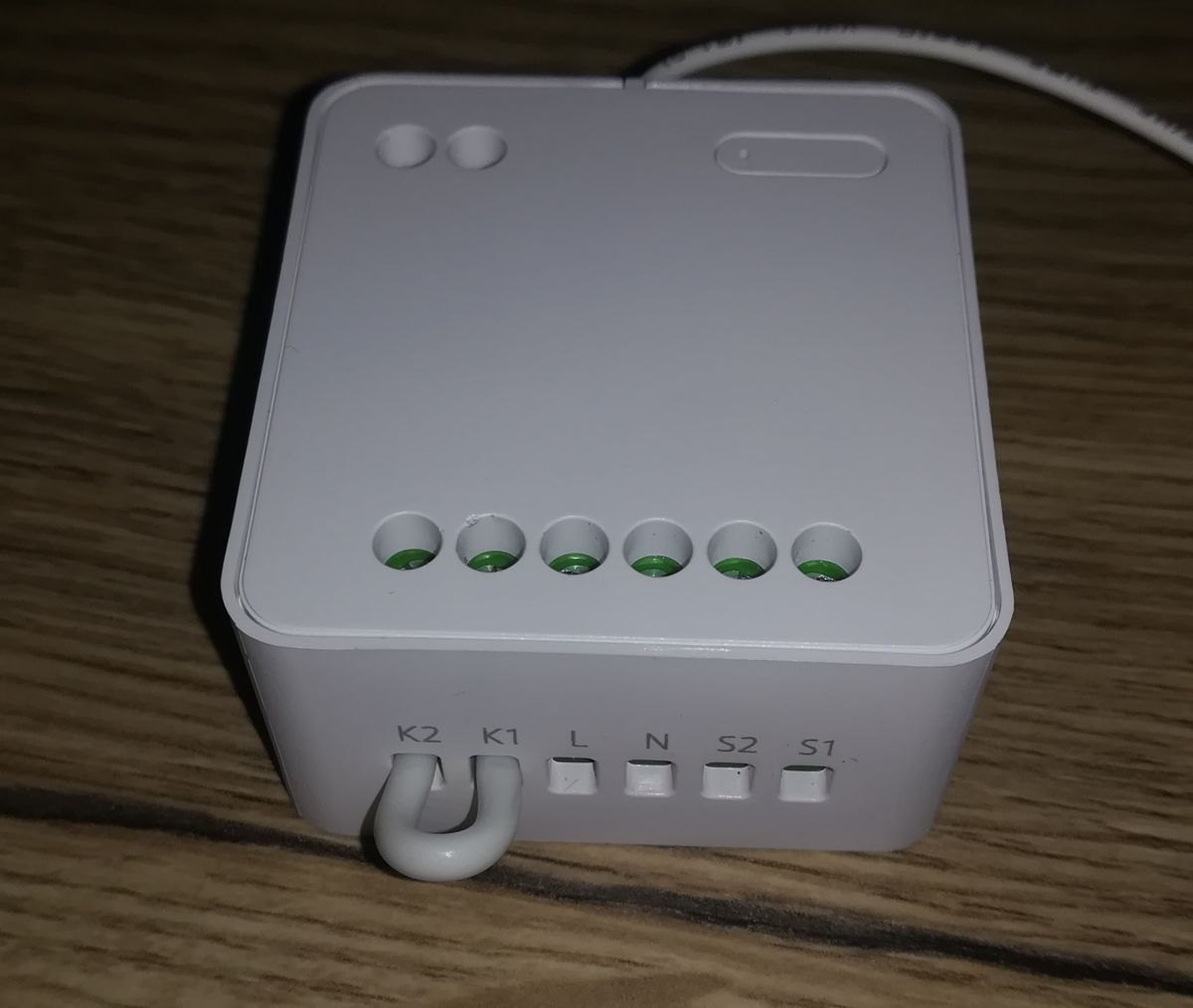

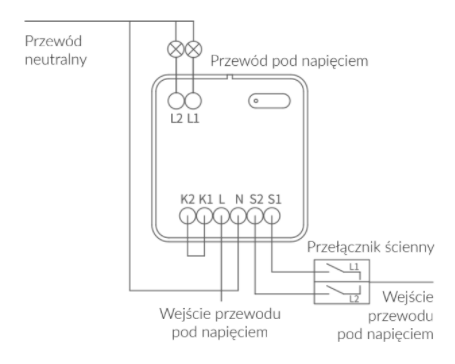

    As below in the photo, the current (L) enters the switch on the left side, while the L cable from the light point enters on the right side (with the blue sticker). The neutral N in the background can be seen to be spliced into the Wago. I am also attaching a diagram of the module and a real photo of it.
    To the L in the module, I connect the current cable from the switch (i.e. the left one from the switch I plug into the module).
    To the N in the module I connect? Should I connect another wire to this Wago connector from N and plug its other end into the module in the N field?
    How do I connect the connector to this module? What about the L cable from the light point (the one with the blue sticker, currently plugged into the connector on the right).
    Thank you for your help!

    How do I connect the YLAI002 module to the switch? Cable connection problem. .
    With blue sticker rewrite and the others new
