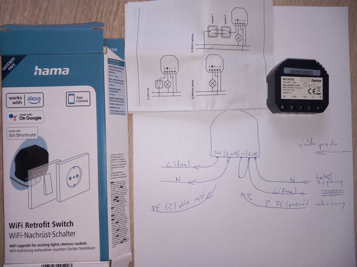

    Hi.
    I have a problem with connecting the flush-mounted control module from Hama.
    I don't know if I understood the instructions correctly.
    I would only like to connect the module between the power cable and the socket - I'm not interested in connecting the light etc.
    I have attached a drawing and I would like to correct or confirm it if necessary.
    I have no idea where to plug in the earthing cable (PE - protective conductor).
    Also from the instructions it appears that on the output "Lout" I would have to plug in the neutral cable "N" - I do not know if this is a correct connection.
    Please help and possibly a breakdown of what to plug in where.
    I only want to control whether the socket will be powered or not.
    Greetings
    Photo of a Hama control module with instructions and connection diagram. .
    Directly into the socket. The control module does not require this connection.

    As you can see, PE is not needed for this device. There is no "N" coming out of the lout, only the phase connected to the bulb as in the diagram. Look at how the bulb is switched on and how the switch is connected.
    Otherwise, from the instructions, I would have connected the neutral "N" cable to the "Lout" output - not sure if this is the correct connection.
    From the controller the output is the phase (L), which you connect to the socket. The other connection to the socket is the neutral (N) cable. This will supply a continuous N and intermittent L to the socket via the controller.

  • #6 20972246
    gulson
    System Administrator
    Posts: 29525
    Help: 150
    Rate: 6122
    This was reported as harmful advice. If it is PE, then it must be used, this is what the manufacturer has deemed responsible for. Please do not be taken in by the above post.

    >>20971935
    Only into which ports do I connect the cables that feed the L and N module?
    I have here 3 ports Sw Lout and Lin.
    Only into which ports do I connect the cables supplying current to the L and N module?
    The "SW" port is only used to connect a switch to control the module "manually", in addition to the remote control. This is an additional function that in this application:
    I would only like to connect the module between the power cable and the current socket - I am not interested in connecting lights etc.
    It is unused.
    To the module you connect:
    SW port - You do not connect anything.
    Link port - You connect the "L" wire from the power cable.
    Port N - You connect the "N" wire from the power cable to the socket. You are additionally branching the "N" cable to the module (N port) in order to power its electronics.
    L port - You are branching the "L" cable from the power cable to the module (L port) in order to power its electronics.
    Lout port - You are connecting to the socket.
    Please note that connecting the "PE" cable to the socket is necessary. Do not interrupt the continuity of the "PE" wire.

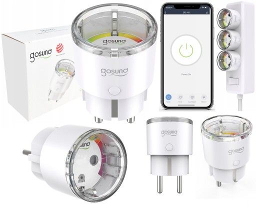

    A simple way to implement a socket in a smart home system is to buy something in a similar way to:
    Gosund smart plug with packaging and mobile app display.
    I mean the shape, size and method of connection. The specific choice is already up to the buyer :-) .

    #10 20976626
    grzegorzmaczura
    Posts: 6
    Thank you for your clear post.
    I know that this may already be too much, but if you could outline it for me I would be very grateful - I want to make sure I am not making a mistake.
    Of course I am aware that someone will immediately write about me that I am a layman and should not ask silly and seemingly obvious questions. He who asks... :)
    First of all, I do not expect too much - just do not write back as if anything.
    Thanks anyway for the earlier reply.
    With regard to the wifi-controlled socket - this is indeed a simple solution which I have already used elsewhere, but in this one case I must use the control of a flush-mounted module to be connected to a 220v socket.
