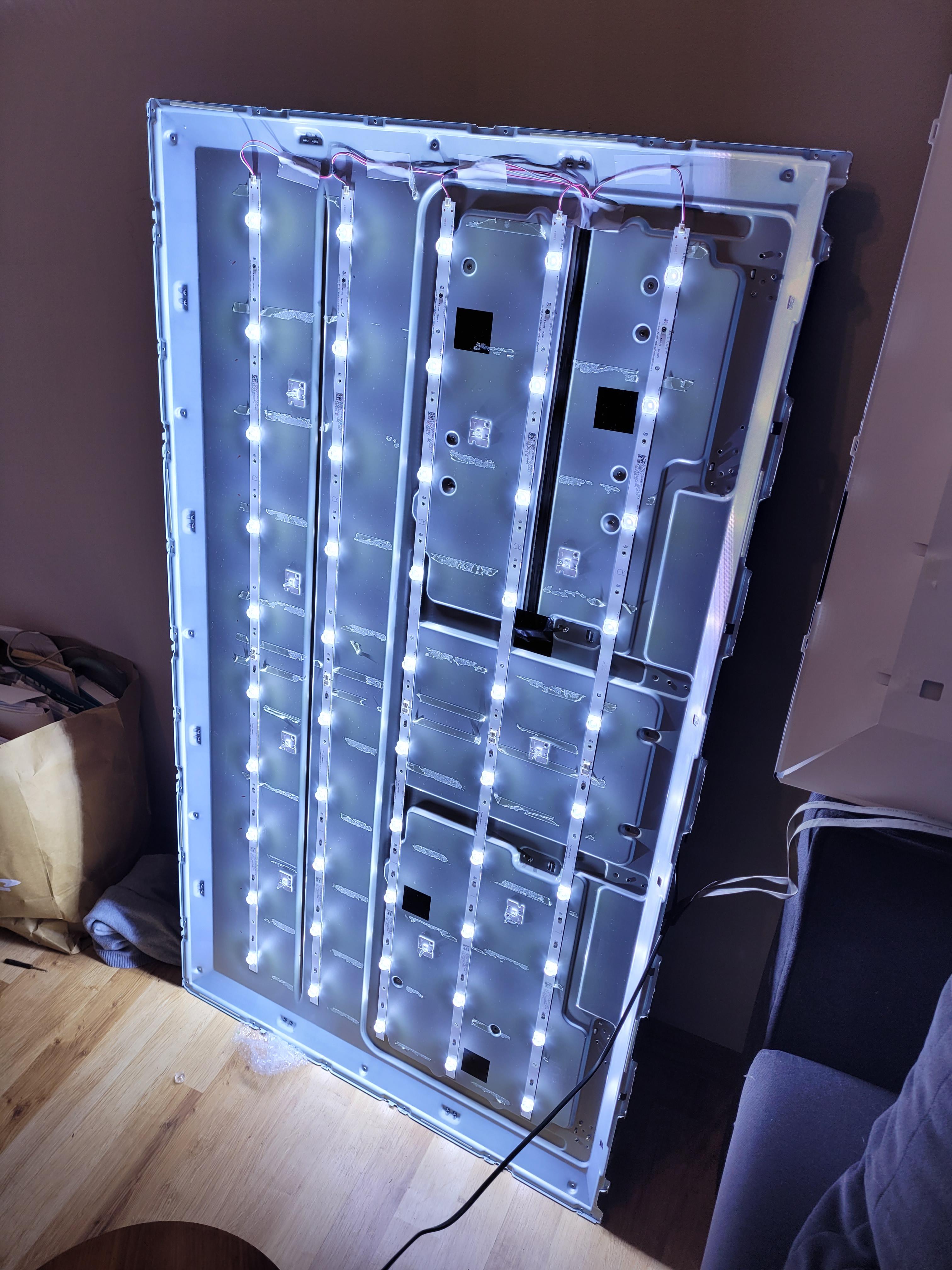

How can I diagnose a Philips 55PUS6754/12 TV that has sound but no picture, only a brief backlight flash on startup, and decide whether the fault is in the LEDs, backlight driver, or another module?
This symptom points first to a backlight problem, most often the LED strips or their strip-to-strip connections, and you usually cannot confirm it reliably without opening the TV and the panel [#19870487][#19870551][#20199096] The T-con is not the same as the inverter/backlight circuit, and the chance that some other electronics have failed is described as minimal compared with the backlight itself [#19870551] In this model, reported repairs found damage at the connections between the LED strips, and replacing the whole set of strips was recommended instead of changing only one faulty strip [#20199096][#20242439] One user replaced all strips and the TV came back to life; the later fault check showed damaged connectors on the R and L strips [#20245514] Be careful when dismantling the matrix, because on Philips sets the panel can be glued to the frame and the job can easily damage the screen if done without experience [#19870487][#20242439]

    Thanks, Gentlemen. Everyone after the brew 🙂
    I replaced the strips all with new ones and the TV came back to life.
    In addition, I checked the cause of the failure later. The problem lay in the connections of the R and L strips. There was damage to the connectors.
