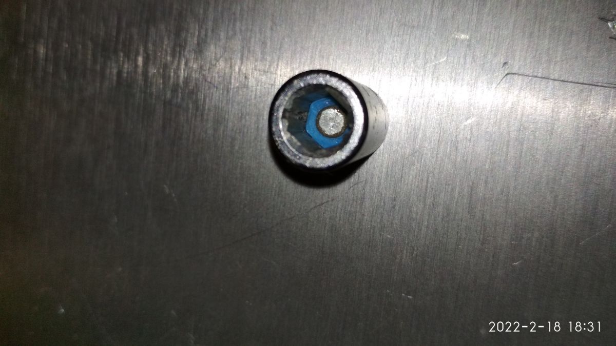

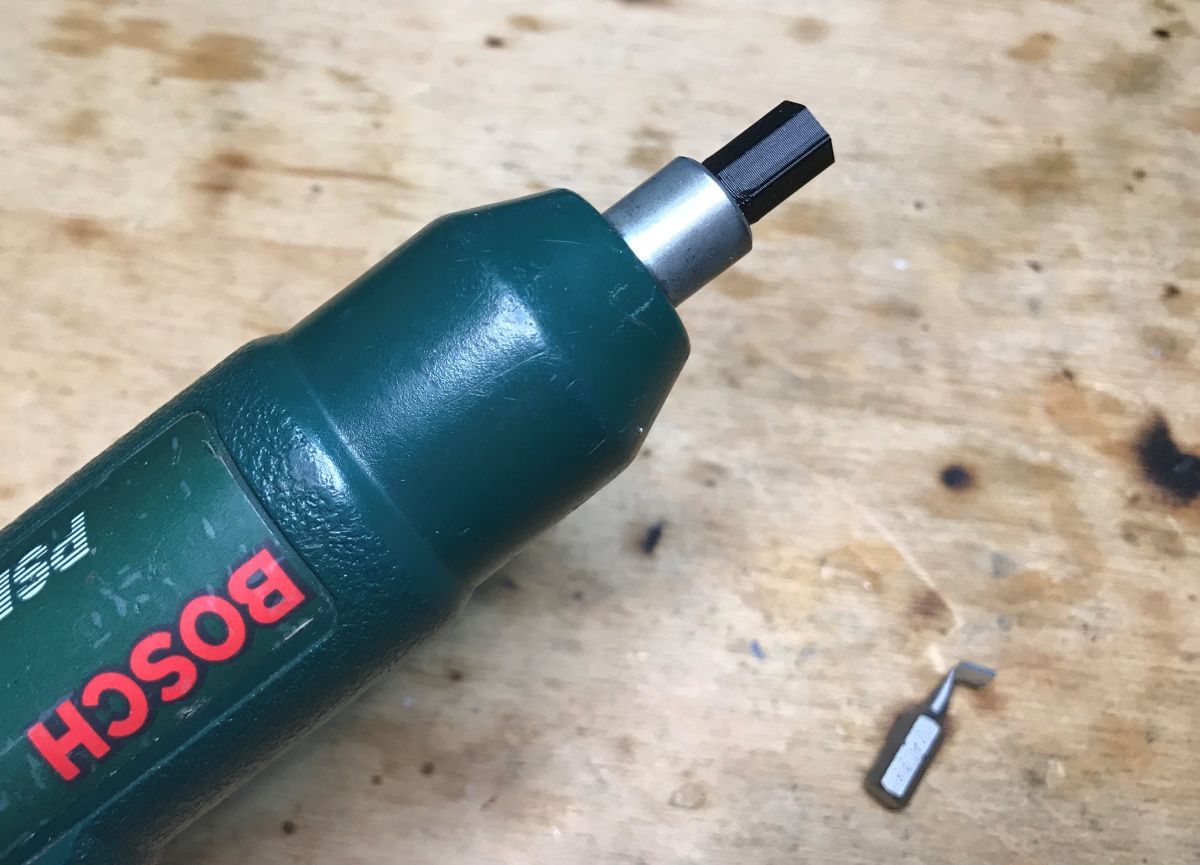

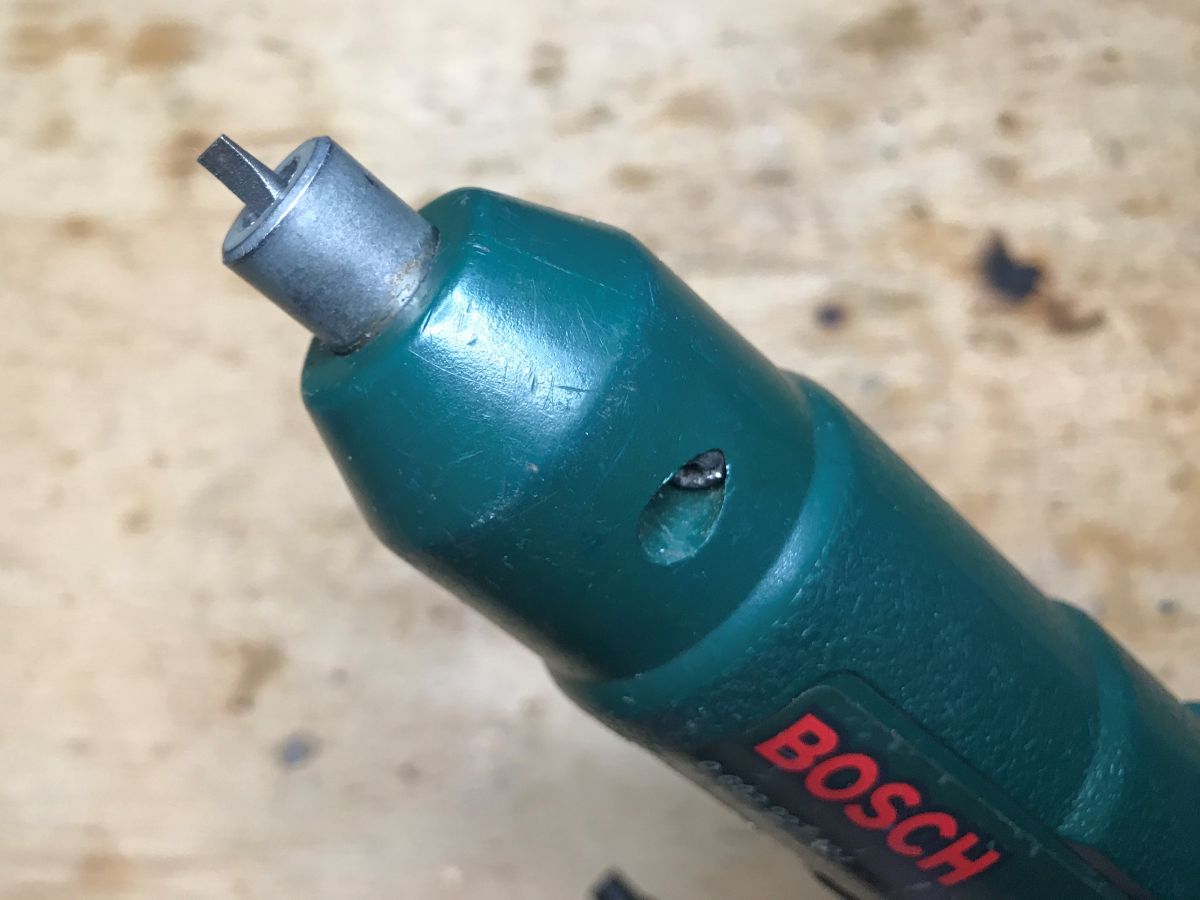

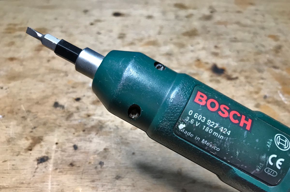

    Here I will present what I think is the smallest practical 3D print for an electronics engineer that I have found myself using in a big way, a bit adapter for a small cordless screwdriver. It all started when I got a faulty screwdriver to repair, obviously without any bits and with a dead battery. I replaced the cell inside with an 18650, along with a module for charging directly from a micro USB (very convenient!), but I had a bigger problem with the bits - none of mine fit this screwdriver (not only did they not stick, they fell in too deep, with barely a tip sticking out). To that end, I designed a tiny adapter, which I'll present here.
    Adapter design
    Bit without adapter in screwdriver:
    The smallest practical 3D print for an electronics engineer - bit adapter
    The thickness of the bit socket is 5/16" (approximately 0.79375cm).

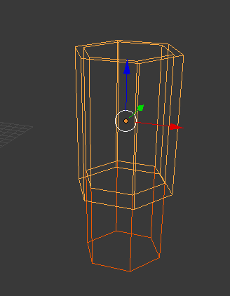

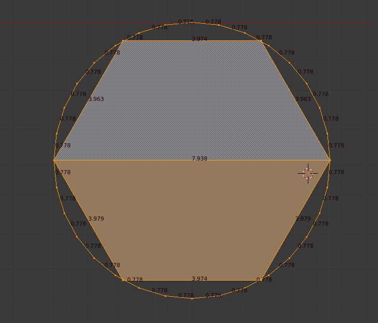

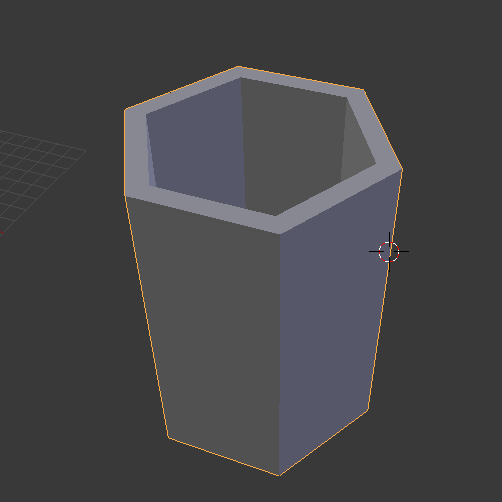

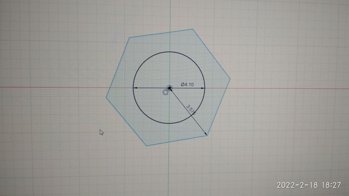

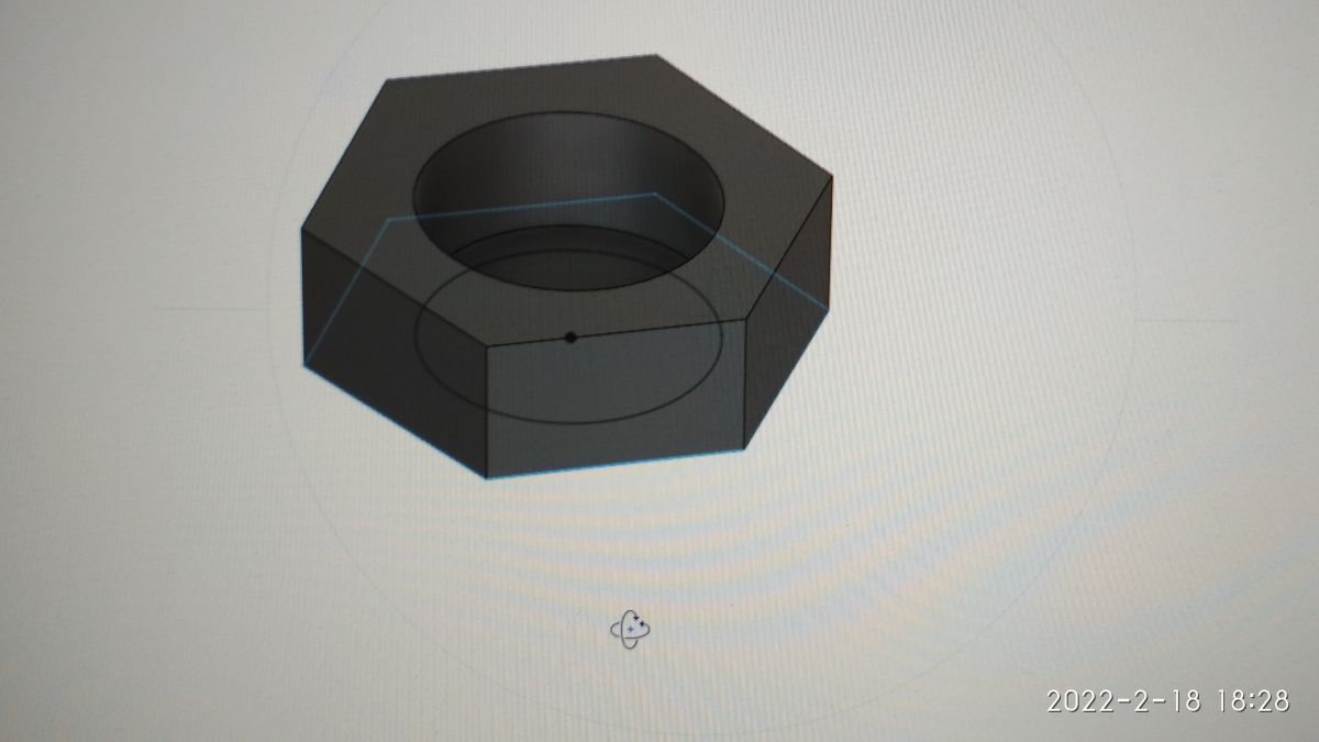

    I made the model in Blender:
    I selected the thickness on the screwdriver side so that it would go in tight and hold solidly, as I will not be changing it. On the bit side I relied heavily on the magnet.

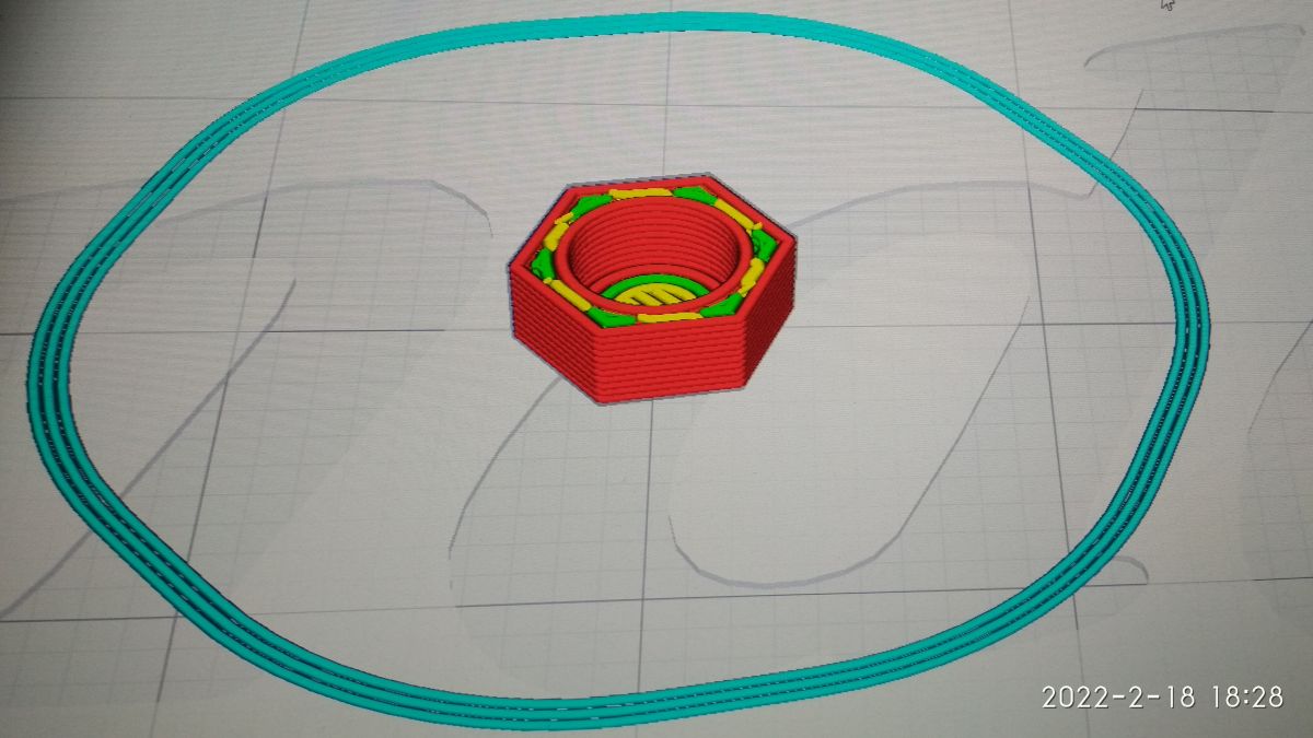

    I used PLA filament. I printed on my Ender 3 PRO.
    I didn't get the dimensions right the first time and had to print twice, but with the price of the filament and the size of this object it's pennies.

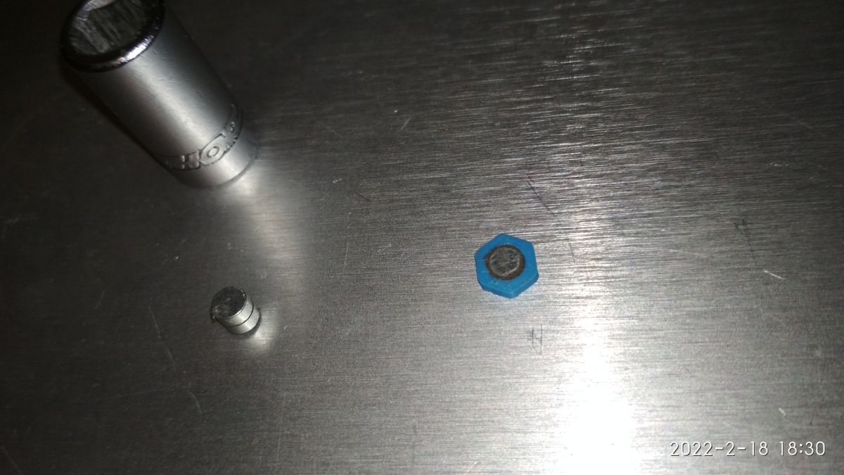

    Now it's time for the magnet - without it it wouldn't make sense. as the bits would fall out of the adapter:
    Attaching the magnet with a dropout:

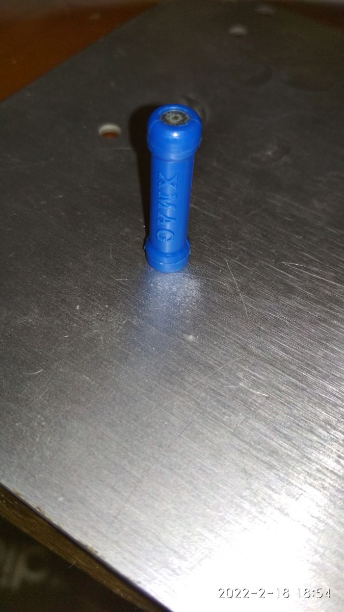

    Finished:
    The adapter does its job perfectly, the magnet holds the bits, you can unscrew and screw in. The more protruding bit makes it easier to access the screw head.
