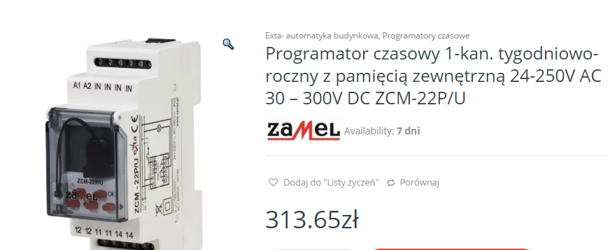

  • #2 18796785
    Mol
    Posts: 1168
    Help: 152
    Rate: 103
    For example, something like this, only a little expensive ZEG-ZCM22/PU

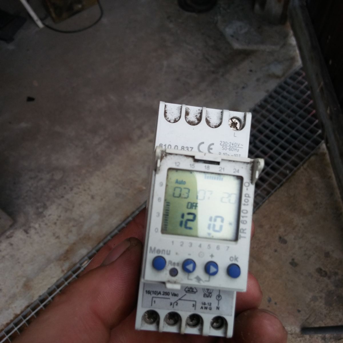

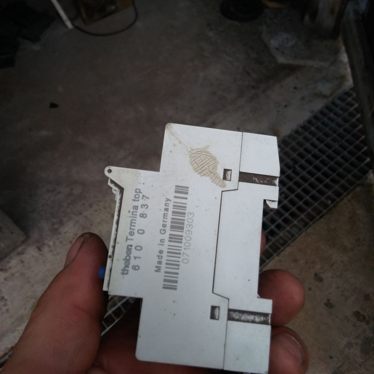

  • #4 18796815
    Mierzejewski46
    Level 37  
    Posts: 5077
    Help: 339
    Rate: 1069
    I can send you for half price. Hardly worked 230V Controller for Monthly 5-Minute Well Water Pump Activation 230V Controller for Monthly 5-Minute Well Water Pump Activation .
  • #5 18797687
    bhtom
    Posts: 4498
    Help: 446
    Rate: 604
    Welcome,
    Colleague @Mierzejewski46 can you explain how on a weekly timer you only set a switch-on interval of 30 days?
    Greetings.
  • #6 18797772
    Mierzejewski46
    Level 37  
    Posts: 5077
    Help: 339
    Rate: 1069
    Ha. Good question. It won't set. I myself don't know what I have8-O .
  • #7 18798589
    bhtom
    Posts: 4498
    Help: 446
    Rate: 604
    Welcome,
    Mol wrote:
    For example, something like this , just a bit expensive ZEG-ZCM22/PU
    This Zamel won't quite work either, as each on/off programme has to be entered manually into the memory, you run out of programmes - the timer stops switching the pump on/off. The author simply wanted an interval of 30 days regardless of the date.
    Regards.

  • #11 18799553
    Mierzejewski46
    Level 37  
    Posts: 5077
    Help: 339
    Rate: 1069
    bhtom wrote:
    This Zamel won't quite work either, as each on/off programme has to be manually entered into memory, the programmes run out - the timer stops switching the pump on/off. The author simply meant an interval of 30 days regardless of the date.
    And he won't be repeating the programme. Will it loop? Because the one I showed is a weekly fact, but once set it works for a whole year.
