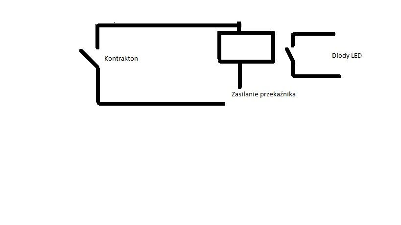

    With these LED parameters, the current drawn is 2A. So using the Satel K1 reed switch alone will be impossible. You need to use a relay to switch the LEDs with it.
    Added after 11 [minutes]: .
    As if you wanted to make the LED power supply yourself using a reed switch then you can make the connection according to a diagram like this.

    Grzegorz740 wrote:
    If you wanted to make the LED power supply yourself using a reed switch then you could make the connection according to a diagram like this.
    Probably not too much, the reed switch is NC, in which case it will be powered all the time when the door is closed.
    sosarek wrote:
    I would nevertheless go for an end switch, even one such as https://sklep.avt.pl/wlacznik-krancowy-drzwiowy-hy06.html or as written
    This is also NC :) it will light up when closed.

    alster1 wrote:
    This is also NC will light up when closed.
    Well what is the problem of adding a relay? ;)

    alster1 wrote:
    This is also the NC it will light when closed.
    As a remedy for NC/NO at the wrong time -.
    you can make two magnets, one in the door classically, the other behind the reed switch. So that the fields cancel each other out when the door is closed.
    The rest depends on implementation, power of diodes, supply voltage etc.
