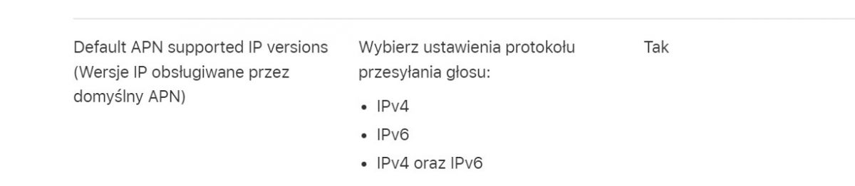

    #15 19910197
    LiSoQuan
    Posts: 8
    KOCUREK1970 wrote:
    LiSoQuan wrote:
    I will also try excluding the IPv6 cell as you wrote
    Not in the cell, and in UPC you have to turn off IPv6.
    If you do NOT have modem/bridge option in CB, then you have active IPv6:
    :arrow: https://test-ipv6.com/
    Already in the first post I wrote that I have IPv4 in CB - if I didn't have it, I wouldn't be able to use DMZ and redirects.
    But maybe you unintentionally solved the problem, or rather discovered the problem. Yes, ipv6 in mobile - this is the problem . Orange pushes (like everyone else) everywhere ipv6 and this is the main problem. Theoretically, you can change to ipv4 but not on iPhones and this is another problem.
    in mom's orange
    APN: "internetipv6" and we have ipv6 i
    APN: "internet" for ipv4
    but for some reason changing to "internet" doesn't give mobile net at all. In the net more such problematic situations in iPhones and ipv6
    So I guess the problem has been found, but there is no solution yet, right?
    UPDATE
    Official info, Apple only supports ipv6 in its mobile devices
    UPDATE 2
    Problem "solved" - I have to turn off dualsim, i.e. to be able to connect via the mobile network, I must have only one active sim card - is it another problem with the iPhone
