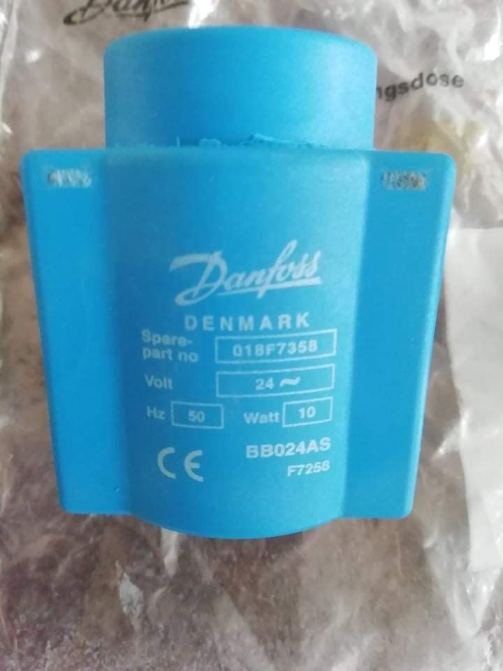

    I have a problem with the selection of a transformer for a Danfos BB024AS solenoid valve, I purchased a Zamel TRM 24 transformer but it turned out to be too weak Selection of a more powerful transformer for Danfos BB024AS solenoid valve - insufficient Zamel TRM .

    This zamel is only 15VA, with poor efficiency.
    Get a transformer of at least 25VA
