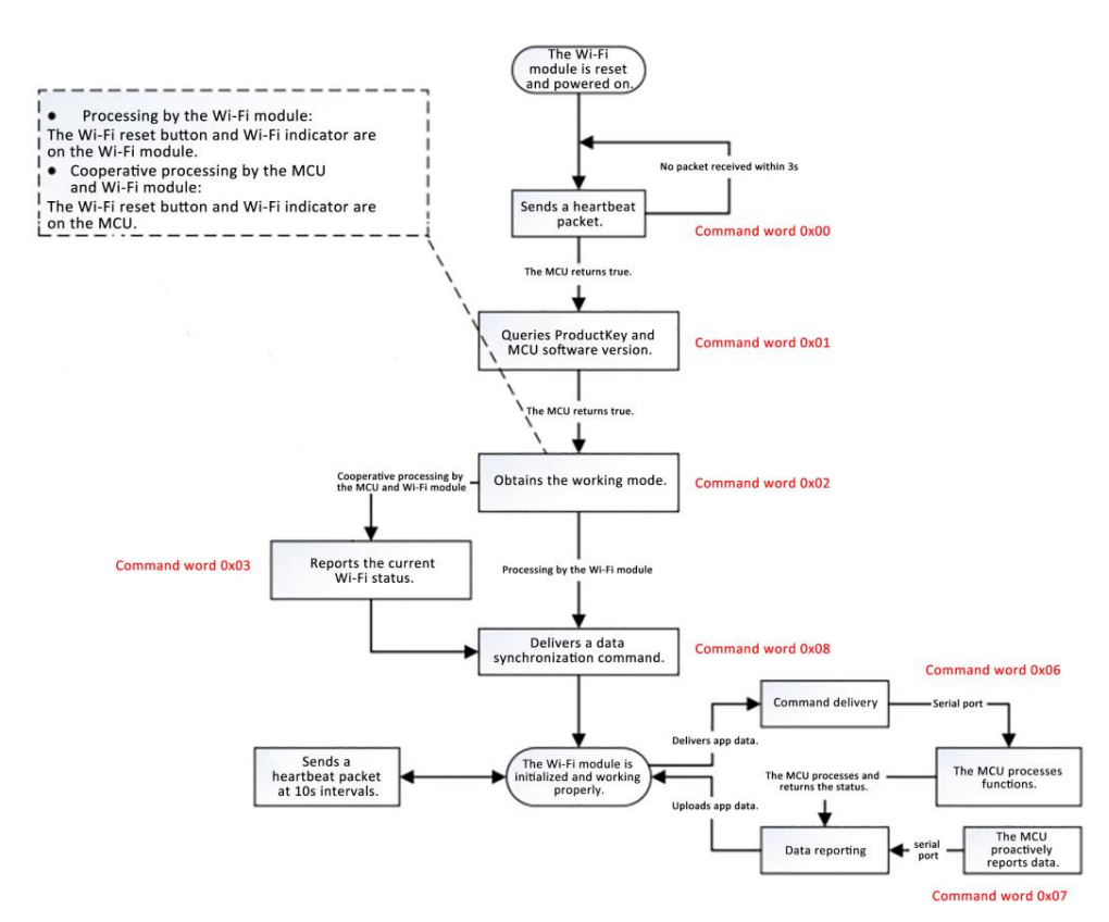

    In theory, the TuyaMCU protocol requires initialization by reporting the version and operating mode of the device, but in practice it seems to me that this is not necessary - neither Tasmota nor my firmware at the moment performs full negotiation with the microcontroller, we basically only send and download immediately data.
    Below is a state diagram of TuyaMCU according to: Tuya:
    Block diagram of the Wi-Fi module communication process with MCU.

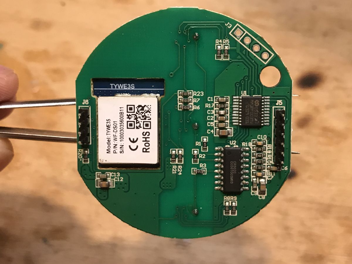

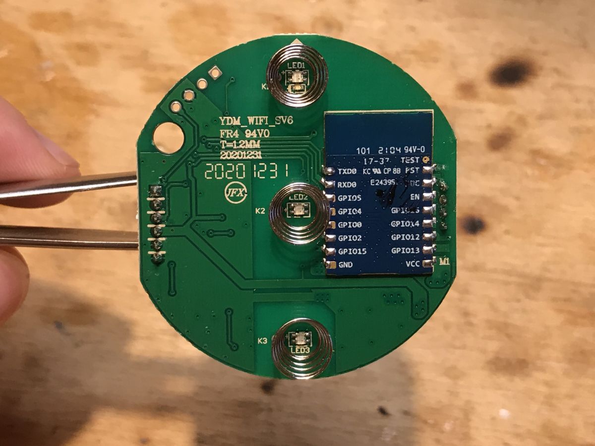

    Let`s look at the first example product divided into a WiFi module and a microcontroller. It will be a WiFi-controlled dimmer, WF-DS01:
    WiFi dimmer switch in an open box on a wooden surface. Wireless Wi-Fi dimmer and user manual.
    Close-up of a round PCB with electronic components. Round printed circuit board with various electronic components and a module labeled TYWE3S.
    Diagram:
    Electrical schematic of WF-DS01 TUYA dimmer.
    Electrical schematic of TUYA WF-DS01 dimmer.
    Inside there is TYWE3S (WiFi module with ESP) and the MM32F003 microcontroller. We also have a third chip here that supports touch buttons.

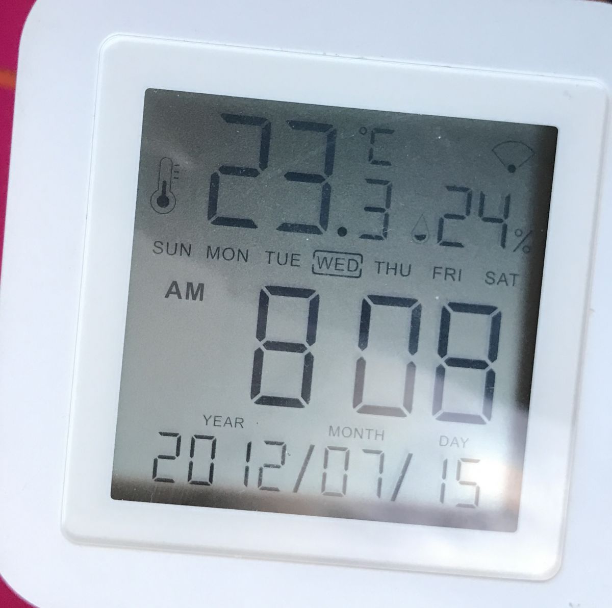

    The third example of a device using TuyaMCU could be the TH06 clock/thermometer/hygrometer/calendar:
    Smart thermometer and hygrometer with graphs on a phone screen.
    The microcontroller inside is not signed and the WiFi module is WB3S. The large chip in the middle is the TM1621B display controller.

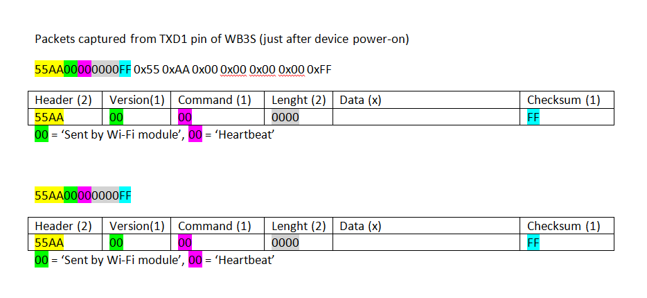

    You need to start by capturing packets.
    We capture packets by simply connecting the RX line of our UART converter, first to TX and then RX from the board (both lines work).
    TuyaMCU uses baud 9800.
    On the computer side I use RealTerm and the Capture option:
    Screenshot of the RealTerm program used for capturing serial data.
    We can analyze the collected data in a free hex viewer program, e.g. xvi32, or in the RealTerm options set it to save bytes as ASCII (human readable) and then all you need is a notebook:
    Screenshot of a hex editor program displaying binary data and corresponding ASCII text.
    It`s easy to get lost in such a large number of bytes. For convenience, I transferred the results to Word, where I could color the background of individual data sections, i.e. highlight the heading, type, length, checksum and so on:
    Table showing data packets captured from TXD1 pin of WB3S, detailing header, version, command, length, and checksum.
    This is how I collected the entire "conversation" between WB3S and the microcontroller, data in both directions. I will analyze them in the next paragraph.
    TH06 - package content in practice
    I collected the packets shown below just after the device was booted up so that they also included the initial negotiation and the microcontroller descriptor packet.
    NOTE: I have omitted some lesser known (less important) types of packages here. Full communication in the .doc attachment.

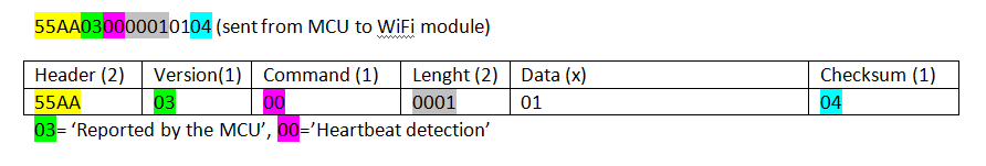

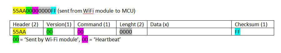

    First, the WiFi module sends `heartbeat` and the MCU responds to it:
    Diagram showing the structure of a data packet sent from a WiFi module to the MCU.
    Diagram showing a message sent from MCU to WiFi module with header, version, command, length, data, and checksum.

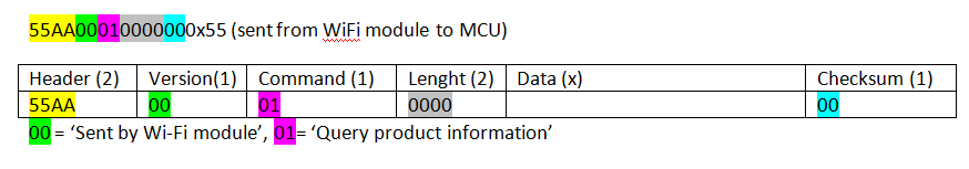

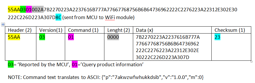

    Then the WiFi module sends "Query product information" and the MCU responds to it:
    Diagram of a message sent from Wi-Fi module to MCU.
    Screenshot showing hexadecimal data sent from MCU to WiFi module.
    The response from the MCU contains ASCII text, more precisely in JSON format:
    {"p":"7akwzwfwhukkdsib","v":"1.0.0","m":0}

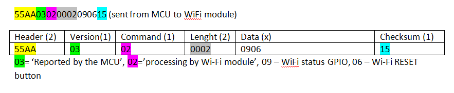

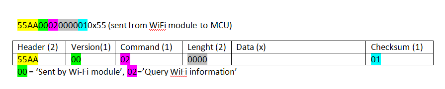

    Then the WiFi module sends "Query WiFi information":
    Packet data sent from Wi-Fi module to MCU in text format.
    Diagram showing the data structure sent from the MCU to the Wi-Fi module.
    The answer to this also includes the roles of the pins (where is RESET, etc.).

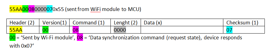

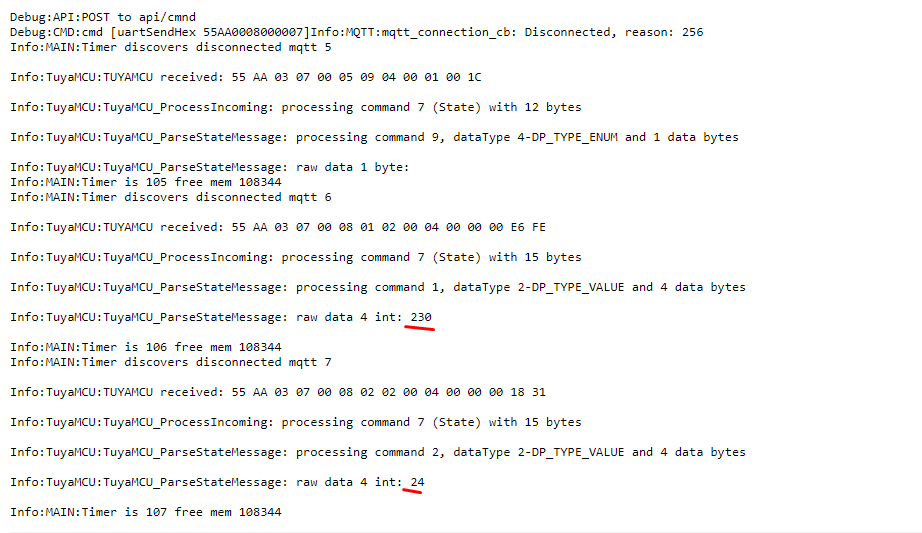

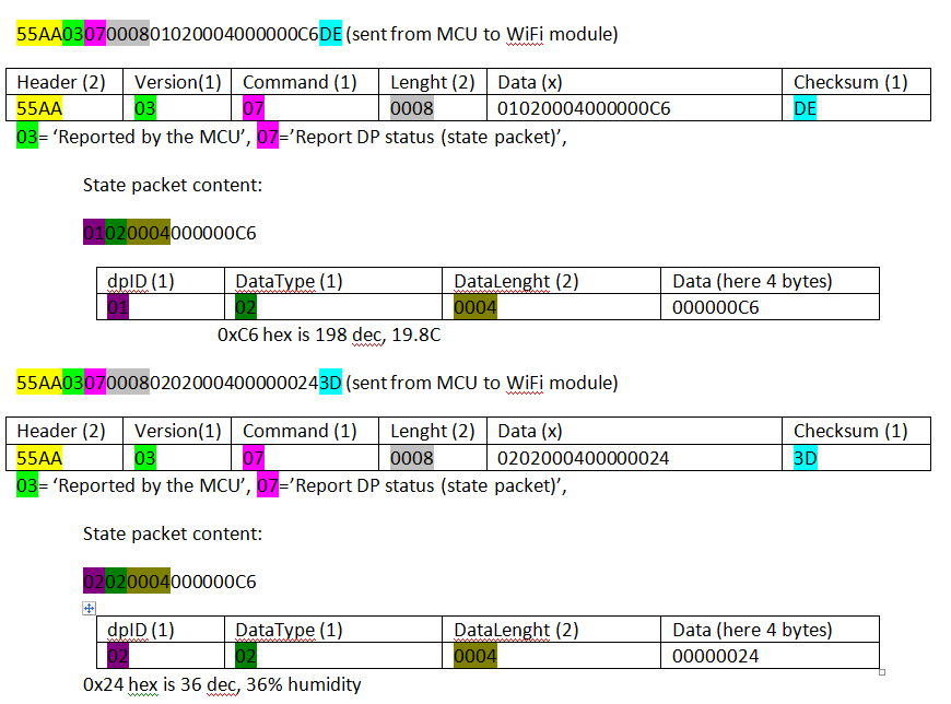

    Then the WiFi module asks about the device status, and more specifically about the temperature and humidity readings (done by the MCU):
    Segment of a message sent from a Wi-Fi module to an MCU with described fields.
    Several packages may come in response to this. In the case of this device, three came, I will show two of them here:
    Diagram showing data packets from MCU sent to WiFi module.
    The temperature information obtained in this way is then sent to the Tuya cloud, so you can also create graphs, read them remotely, etc.

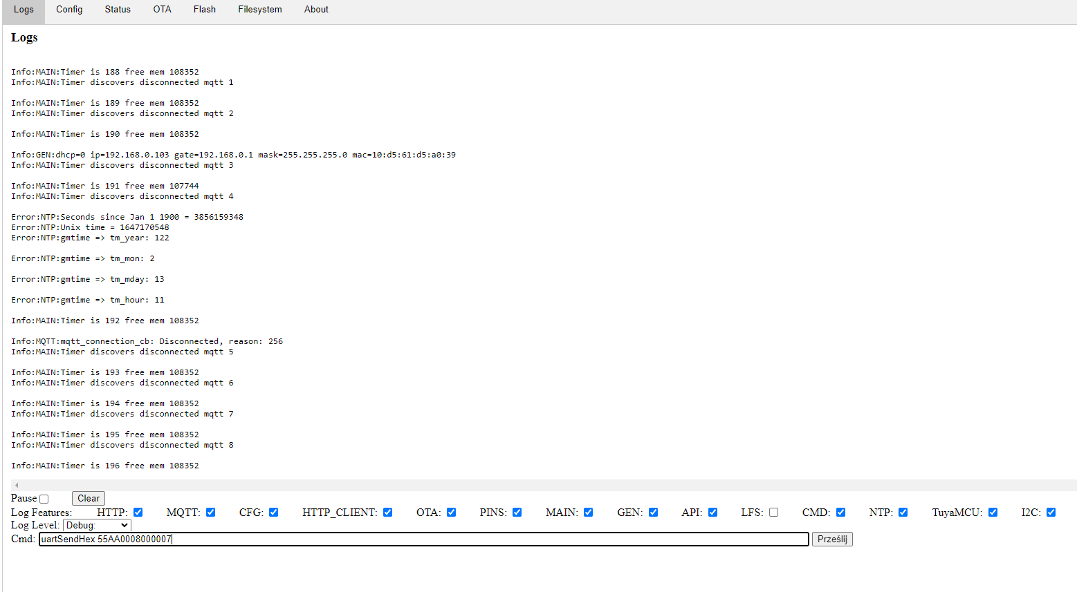

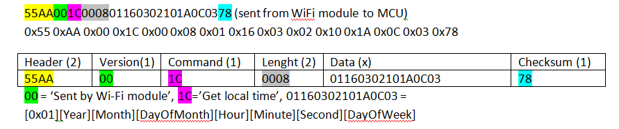

    There is still communication in the other direction - the time is downloaded by the WiFi module from NTP servers and sent to the MCU in the following packet:
    Communication frame diagram between Wi-Fi module and MCU.

    This is what the function that creates it looks like:
    Code: C / C++
    Example of use:
    Code: C / C++
    Result:
    Digital clock displaying temperature, date, and time.

    First, however, I need to manually send a query about the device status (the screenshot shows the web panel from the WiFi module):
    Screenshot of a log console displaying error and connection information.
    Then I receive 3 packets, temperature and humidity values marked in the screenshot:
    A fragment of a log with debugging messages and TuyaMCU state information.
    230 or 23.0 degrees and 24 (% humidity). This is consistent with the readings from the display (well, the temperature had already changed by a fraction of a degree before I took the photo):
    Digital clock display showing temperature 23.3°C, humidity 24%, day of the week WEDNESDAY, time 8:08 AM, and date July 15, 2012.
    In this way, we can both send and receive data via TuyaMCU. We are able to read the device status and set it.
