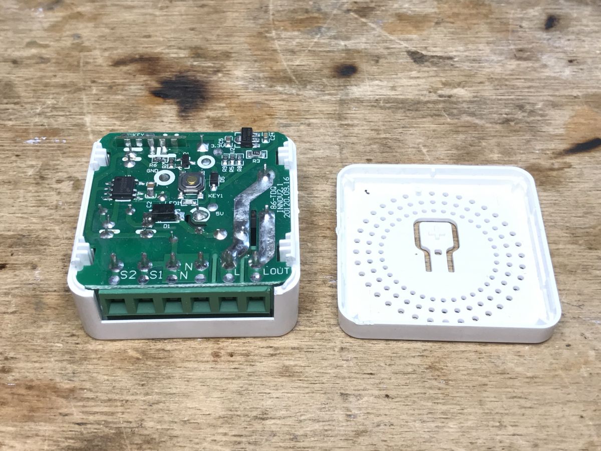

    To upload the firmware, remove the plastic cover:
    ZN268131 WiFi Smart Switch that allows you to connect a bistable button ZN268131 WiFi Smart Switch that allows you to connect a bistable button
    From the bottom you see the 5V transformerless power supply (AP8506), behind it there is a 3.3V LDO regulator providing a stable 3.3V for the WiFi module, then the (KEY1) button, connection of the board with the WiFi module (only 5 signals go there, actually 3.3V, GND, output to the relay (through Q1 transistor) and two inputs - one for the large bistable button, the other for the small one on the housing.
    After removing, you can see the WiFI module (WB2S or BK7231T, I don't know why without a metal case this time), there are also some protections (fuse resistor F2, blue varistor) and a filter on the input (two electrolytic capacitors, EC1 and EC2, and a choke between them) ):
    ZN268131 WiFi Smart Switch that allows you to connect a bistable button ZN268131 WiFi Smart Switch that allows you to connect a bistable button ZN268131 WiFi Smart Switch that allows you to connect a bistable button ZN268131 WiFi Smart Switch that allows you to connect a bistable button ZN268131 WiFi Smart Switch that allows you to connect a bistable button
    Programming ZN268131
    Never attempt to power the relay from mains and flash it at the same time! Power it separately, via 5V connected before AMS1117:
    In addition, only the RX and TX need to be connected to the WB2S pins:
    Initially, I tried to do this:
    Unfortunately it did not work. It quickly turned out that the RX pin is also used here as a button and the pull up resistor on this signal interferes with the programming.
    The solution is to temporarily cut the track so that it can be easily repaired and clip on the WB2S side:
    These 4 cables are enough.
    The rest of the programmer is a USB to UART converter in 3.3V mode and a separate power input (I can not take 5V from USB, because to reboot the device I have to connect and disconnect the power, and when I use USB for this, the relay will take too much current and USB from the USB will reset and the USB to UART converter will be "lost" and the programming will fail):
    Programming procedure:
    1. in bkWriter 1.60 select the batch, start programming
    2. while waiting, disconnect and connect the 5V power supply to reboot
    3. the module should program itself without errors
    This is for the BK7231T - for the BK7231N use a Python programmer.
    After programming, fix the cut path:

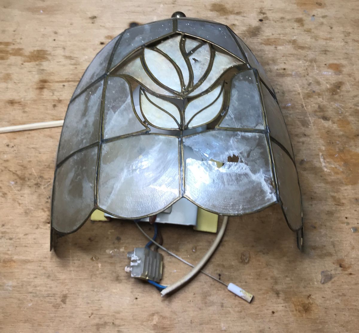

    For example, you can convert an old lamp (yes, also saved from e-waste):
    Use the original switch:
    Connections, additionally I made a joint on a wire so that pulling it by the cord does not tear it out:
    Ready:
    From now on, the lamp still supports its old button, but it's also smart. For example, you can turn off all the lights (including the lamp) from the Home Assistant when you leave the house.

    piratee
    Posts: 69
    Hello groupers.
    Has anyone configured the above-mentioned mini smart switch, but with the CB2S (BK7231N) on-board chipset?
    How is the module configuration set up?
    Is the pin 24 pad from the CB2S module used when switching on the relay?
    (during soldering, the path broke off and this is from the outside of the thin one)
    Regards
  • #18 20384429
    Posts: 14754
    Rate: 12876
    It all depends on the device model. There are different versions in circulation. You need to open the case and check which pins go where. Free IO can be freely used and configured. If, for example, you dropped the P24 pad from the module, you can use the adjacent P26 if it is free, and if not, another of the free pads.
    Post detailed photos
  • #19 20385158
    piratee
    Posts: 69
    Photo of the board and description of the connections (at least those paths that I was able to track down)
    It seems to me that the TX, RX, P6, P7 do not have pin pad tracks pulled up.
    I do not write about the power supply because I normally log in to the software.
    Regards
  • #20 20385415
    Posts: 14754
    Rate: 12876
    In general, these TX2 and RX2 could also be used rather. Maybe not TX2 because it's a log output, but RX2 can be controlled from the beginning with software....
    These pads look free?
    That pad on the side is your soldered wire is it?
