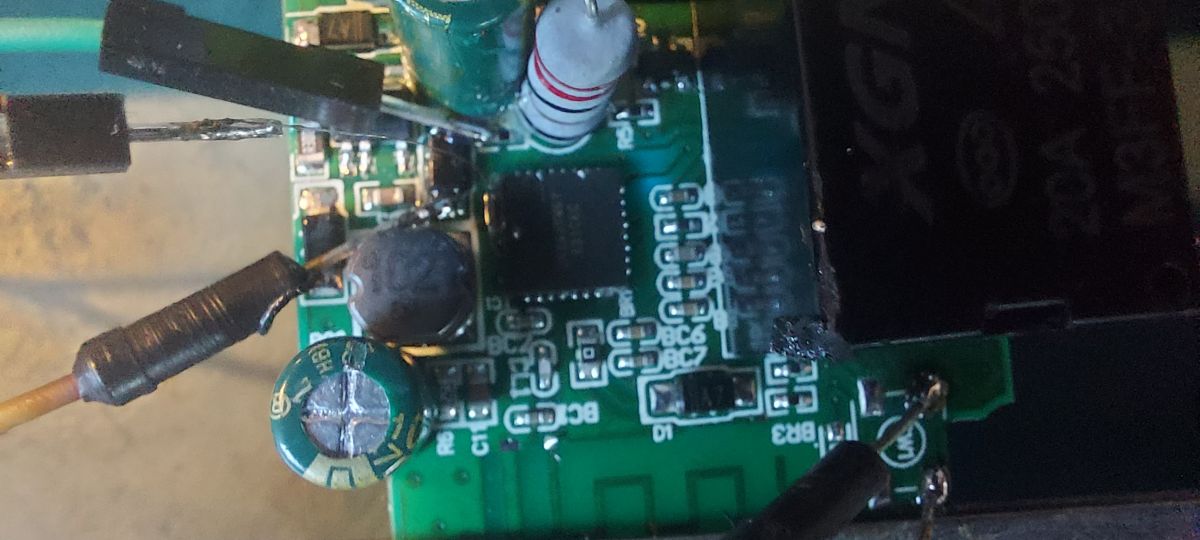

  • #31 20389189
    piratee
    Posts: 69
    I no longer power everything from 230V CB2S is soldered to the shallow, so when checking I have to watch out for high voltage
  • #32 20389196
    Posts: 14677
    Help: 656
    Rate: 12705
    Remember that even if you disconnect 230V, the capacitors can hold some current and cause a painful shock.
    Depending on how well you are soldering, seriously soldering the LED with a resistor to the appropriate IO and mass (or VDD, if you prefer) with the correct polarization (because you know that the diode has an anode and a cathode) will tell you in a minute whether the IO data works or not.
    Unless you're doing something else wrong, e.g. you set IO somehow strangely .... but there's nothing to break here, P9 is P9 and that's it. P8 is P8. Etc. On the WWW configurator, we use normal IO naming, such as Tuya

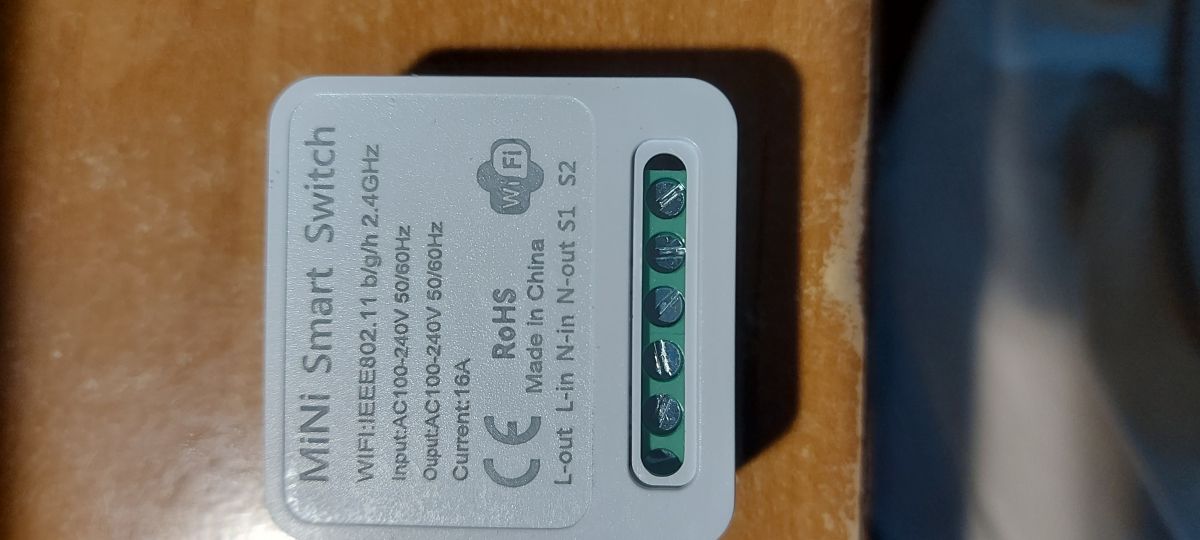

  • #34 20496080
    anthonythomas
    Posts: 40
    Rate: 16

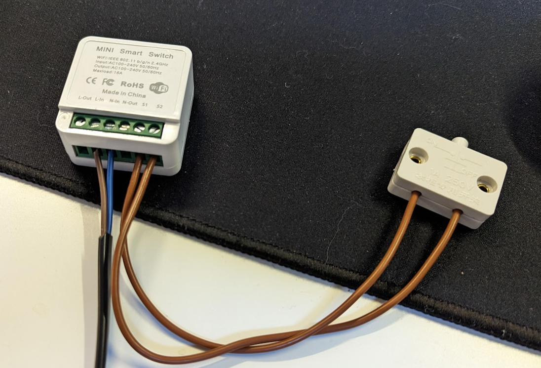

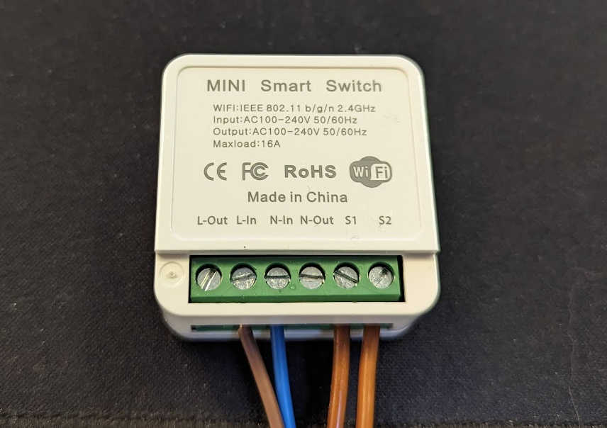

    I have bought some very similar switches in the AliExpress Choice Day sales.
    Used tuya-cloudcutter to flash OpenBK (didn't even setup in SmartLife app - just went straight to cloudcutter)
    > By manufacturer/device name
    > Aubess
    > 16A Mini Smart Switch
    > 1.2.1 - BK7231N / oem_bk7231n_control_switch
    OpenBK7231N_UG_1.15.597.bin
    Pin settings are possibly different to other versions - these work for my device.
    LED_n - 7 - ch1
    Rel - 8 - ch1
    Btn - 10 - ch1
    TglChanOnTgl - 26 - ch1
    Toggle tested with a simple switch.
    ZN268131 WiFi Smart Switch that allows you to connect a bistable button
    ZN268131 WiFi Smart Switch that allows you to connect a bistable button ZN268131 WiFi Smart Switch that allows you to connect a bistable button ZN268131 WiFi Smart Switch that allows you to connect a bistable button

    Thanks, added as add Mini Smart Switch 16A 1 Gang Shunshun:
    I wasn't been able to find any other marking or name on the photos you attached.

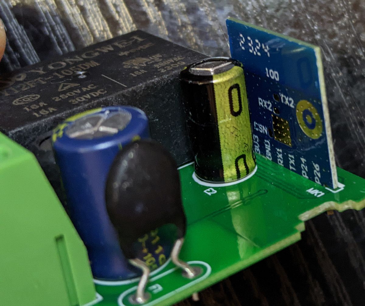

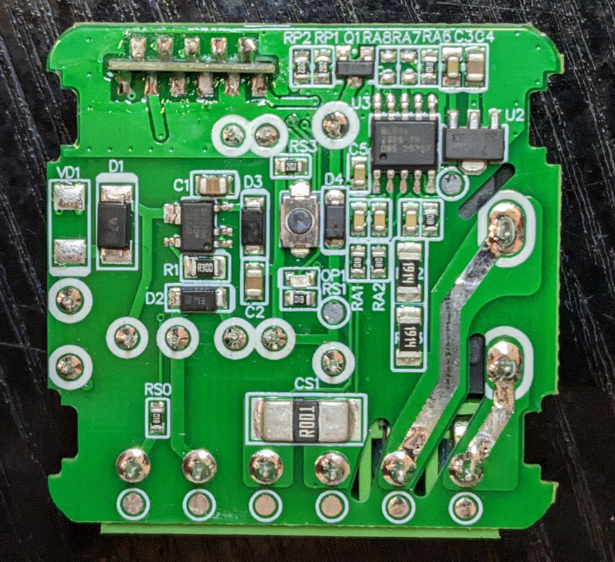

  • #46 20968472
    StrangerIV
    Hi all,

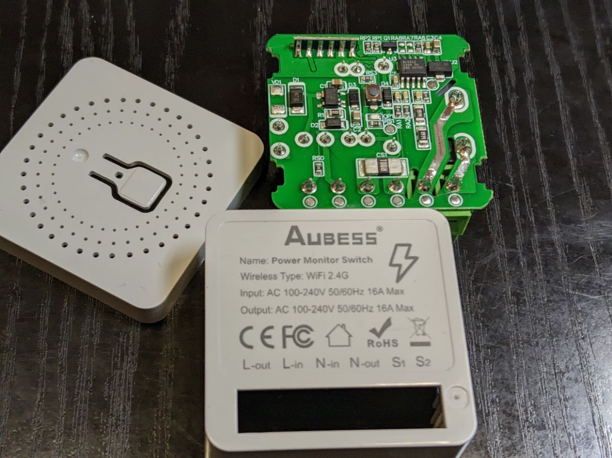

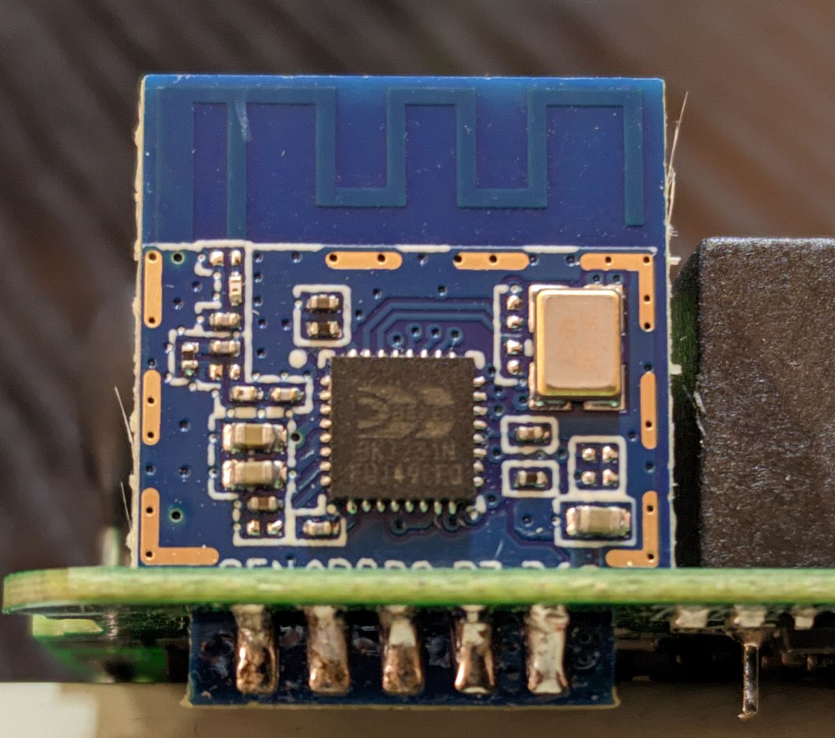

    just wrote your great firmware to my device. One hint: I have two usb-to-uart devices, so I connect my Aubess Power Monitor Switch 3,3V line to one of them, and Rx, Tx and Ground to another. So when I was asked to re-plug power, I did it on first usb-to-uart, and my data link stays intact on second.
    My device is slightly different. Here's some photo:
    Interior and casing of Aubess power monitor switch with a circuit board. Close-up of a printed circuit board of an electronic device with visible components such as capacitors and screw terminals. Close-up of a green PCB with electronic components and a cut trace at the top. Close-up of an electronic module with visible traces and components on a circuit board. Close-up of an electronic board with components, including capacitors and a module, with visible markings.
    On the second photo, at top of board, you can see cutted route. It is Rx1, cutted to avoid interference with other devices on board, in my case it is BL0542 power monitor.

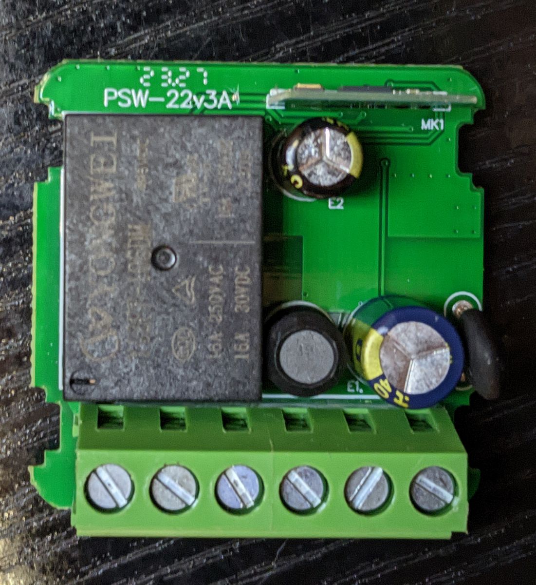

  • OpenBK pinout for T34 smart switch
    #47 21363483
    kicius
    Posts: 30
    Another very similar switch on sale AliExpress chip T34 (note altered pinout).
    Used BK7231 EASY Uart Flasher to flash OpenBK
    > DIY Smart Switch
    > OpenBK7231N_QIO_1.17.812.bin
    Pin settings probably differ from other versions - these work on my device.
    LED_n - 6 - ch0
    Rel - 15 - ch0
    Btn - 24 - ch0
    TglChanOnTgl - 11 - ch0
    TglChanOnTgl - 14 - ch0
