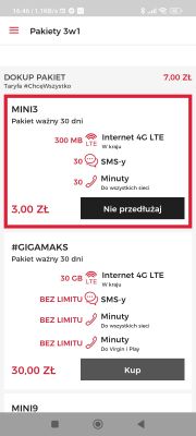

    I don't see the mini 3 package on the Virgin website, only 9.
    There are no limits in play for companies for 15 gross

    This offer may no longer be available on the website, but it is still available in the Virgin app

    Virgin mobile MINI 3 is enough for me. It costs a whole 3 zlotys :) - 300 MB Lte, 30 text messages, 30 minutes per month. If you run out, 1 GB for PLN 1, 400 text messages for PLN 3.

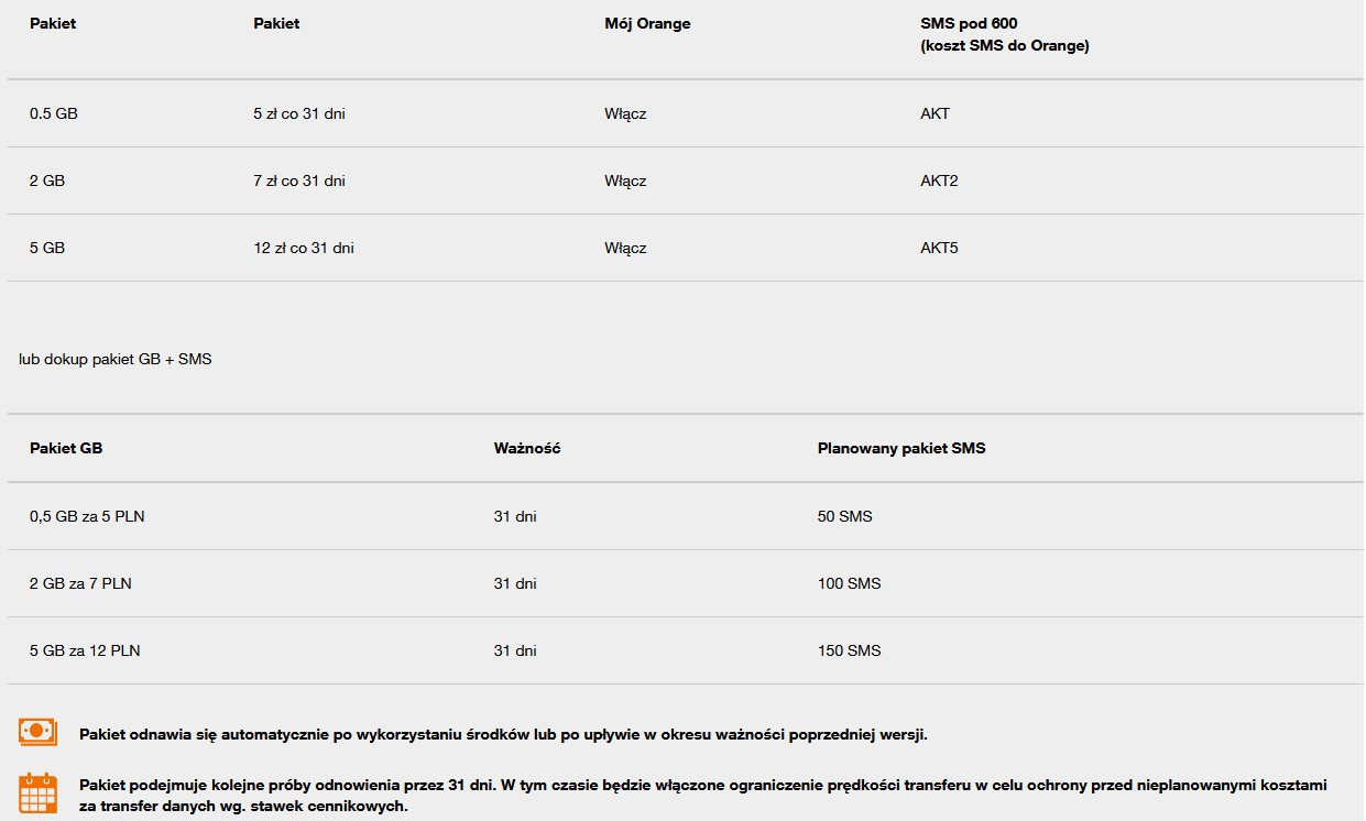

    If I understand correctly, the offer is actually not that bad. PLN 5 per month, including 0.5 GB Internet package and 50 SMS,
    Do I understand correctly?

    Orange IOT is a typical tariff for such devices, and Play From New is probably a regular phone tariff? Is it OK to use such a SIM card with a "human" rather than "machine" tariff?
    PS. And what amounts of data and SMS per month should be expected with a standard alarm system?

    In Play From New there is a bundle of 100 sms to "other networks" for 5 PLN, valid indefinitely.

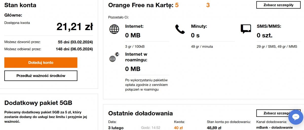

    Orange Free prepaid with the service "A year of account validity" enabled without any additional packages.
    The last recharge in February this year, since February "ate" less than 28,- pln
    The system normally used, Integra 256 control panel with INT-GSM module
    Screenshot showing the Orange Free prepaid account status with information on available balance and top-up options. .

    The system sends me daily push notifications on and off standby, in addition to this come notifications of other events, practically every day I use the application, for me this is a sign that the system is working and with the GSM module is also OK.
    I do not see the slightest sense that in addition to the above comes to me daily test transmission.

• Orange IoT: PLN 5 / month, 0.5 GB data, 50 SMS, dedicated APN “iot” [Elektroda, ropam, post #20091482] • Play OdNowa: 1 GB pack PLN 5; 100-SMS pack PLN 5; inactivity fee PLN 3-5 [Elektroda, bhtom, post #20345170] • Fakt Mobile: Account + funds valid 365 days after PLN 5 top-up; call/SMS 0.15 PLN; 1 GB = PLN 3 [Elektroda, adversus, post #20701772] • Plus/Plush: Activate “year validity” for PLN 10; SMS 0.35 PLN; lack-of-traffic fee PLN 3 [Elektroda, Alpha, post #20091540] • Play telemetry subscription: 100 SMS + 20 MB for PLN 3.50 net / month [Elektroda, Alpha, post #21311407]
Which prepaid SIM is currently the cheapest reliable option for alarm panels?
Orange IoT costs PLN 5 per month and includes 0.5 GB data plus 50 SMS, enough for most control panels [Elektroda, Robinson74, post #20832053]
