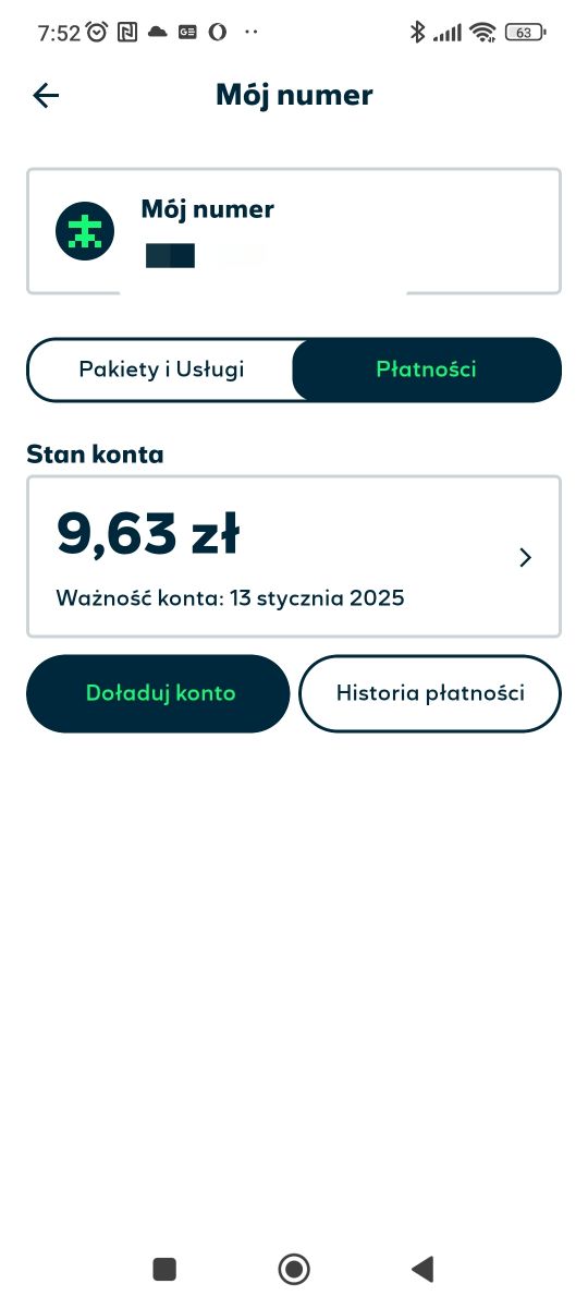

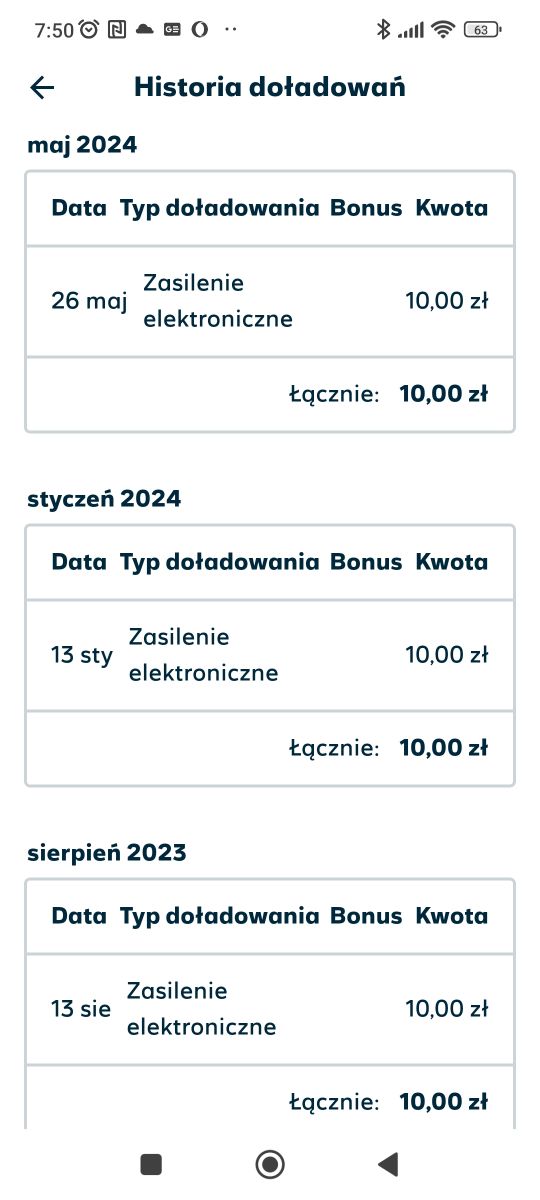

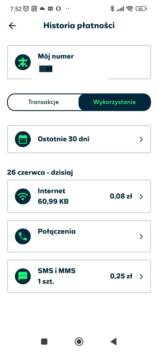

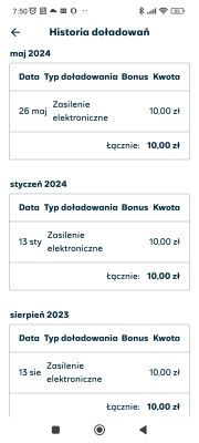

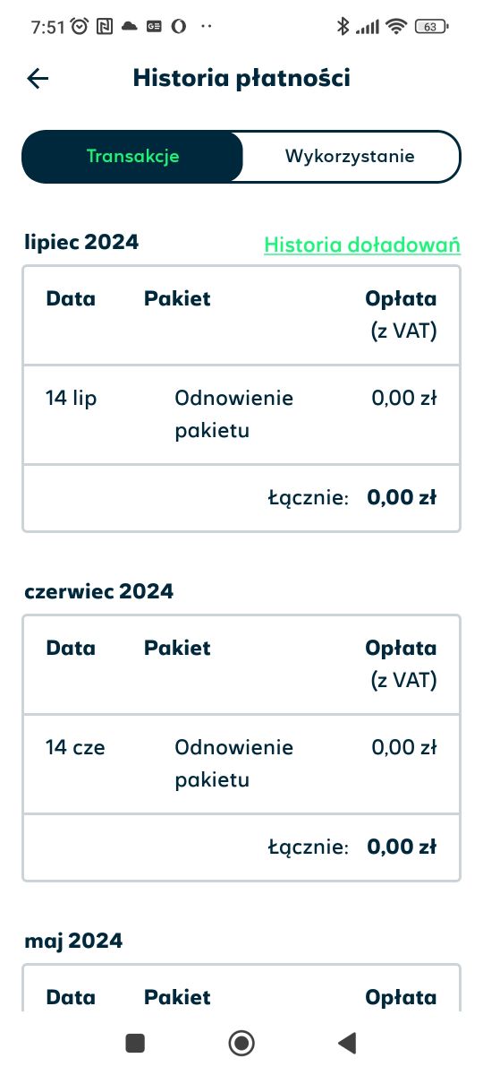

    I write as it is. In January I paid £10 to extend my account for a year, then topped up in May with £10 and I still have over £9 from that.
    I attach screenshots from the app.
    Screenshot of an app showing payment history and phone usage. Screenshot from an app showing account balance of 9.63 PLN and validity until January 13, 2025. Screenshot from an app showing the payment history with completed transactions for May, June, and July 2024. None of the package renewals incurred costs. Screenshot from an app showing the user's account top-up history for August 2023, January 2024, and May 2024.
