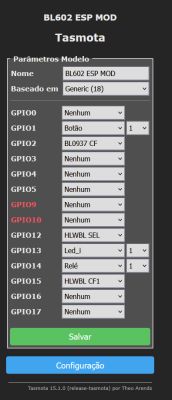

    Tasmota configuration screen with GPIO settings for BL602 ESP MOD
    For now to replace the BL602 to ESP-02S
    the energy meter its not working yet
    {"NAME":"BL602 ESP MOD","GPIO":[0,32,2720,0,0,0,0,0,2592,320,224,2656,0,0],"FLAG":0,"BASE":18}

    its weird because its say
    GPIO2 = Primary output channel (channel0_pin) – relay
    its gpio15 on esp8266 but the relay just wokr on GPIO14
    its ok:
    GPIO20 = Channel / relay indicator LED (channel0_led_pin)
    GPIO17 = Primary button input (key0_pin)
    I'm based on this map

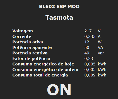

    I figured out now.
    Just need to calibrate the energy meter sensor.

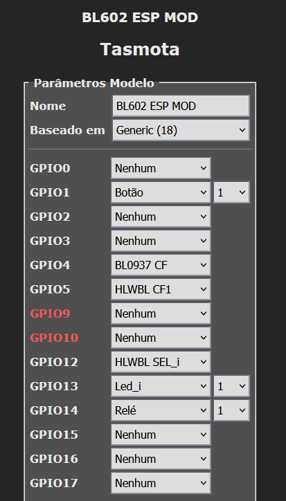

    {"NAME":"BL602 ESP MOD","GPIO":[0,32,0,0,2720,2656,0,0,2624,320,224,0,0,0],"FLAG":0,"BASE":18}
    Tasmota interface screen showing energy usage data and device status ON
    GPIO configuration for BL602 ESP MOD device in Tasmota interface
    you have to go to the console and set
    I use a light 15w for example for calibration
    VoltageSet 213 (example)
    PowerSet 15.0 (example)
    CurrentSet 70 (0,070A)
    also SetOption21 1 to show voltage when is off
    Tasmota dashboard showing voltage, current, and energy consumption data

    It's worth to mention that you need to connect a known, measured load first, and then enter calibration values. Beginners may be reading our threads.
    So, good job, is it fully functional now?
  • #35 21793429
    tadeu1
    Posts: 83
    Yeah, it's working right now. It's weird because the map from BL602 to ESP GPIO won't match. I have to try each one.
    Yeah, you all right about the calibration. I use a 15 W light to do that. Thanks a lot, guys, for your support.
