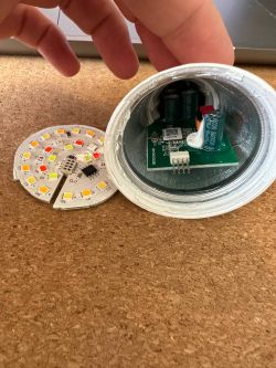

    Well, how your bulb looks like? Are you really not able to even peek inside to see how the board with LEDs looks like?
    BP5758D_Map is not necessary. It just changes the order of colors, eg. changes the swapped Red and Green channels or Blue and Cool Warm, etc, etc. For testing, you can have any Map or just the default one, at least you should be able to see some colors.

    As far as the bulb goes, this is what i have:
    LSC Smart LED E27 806 lumen (RGBCW)

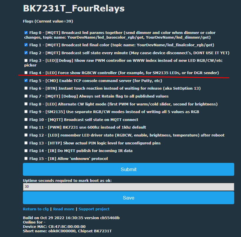

    If you want controls to appear for BP, then you should check the flag in options, "Always show RGBCW controls" or something like that...
    Yes! that did the trick! fully working now...

    No problem. Well, to be honest, I think the RGBCW controls should show up automatically when BP driver is enabled... I may just enable them if any of LED drivers are running.
