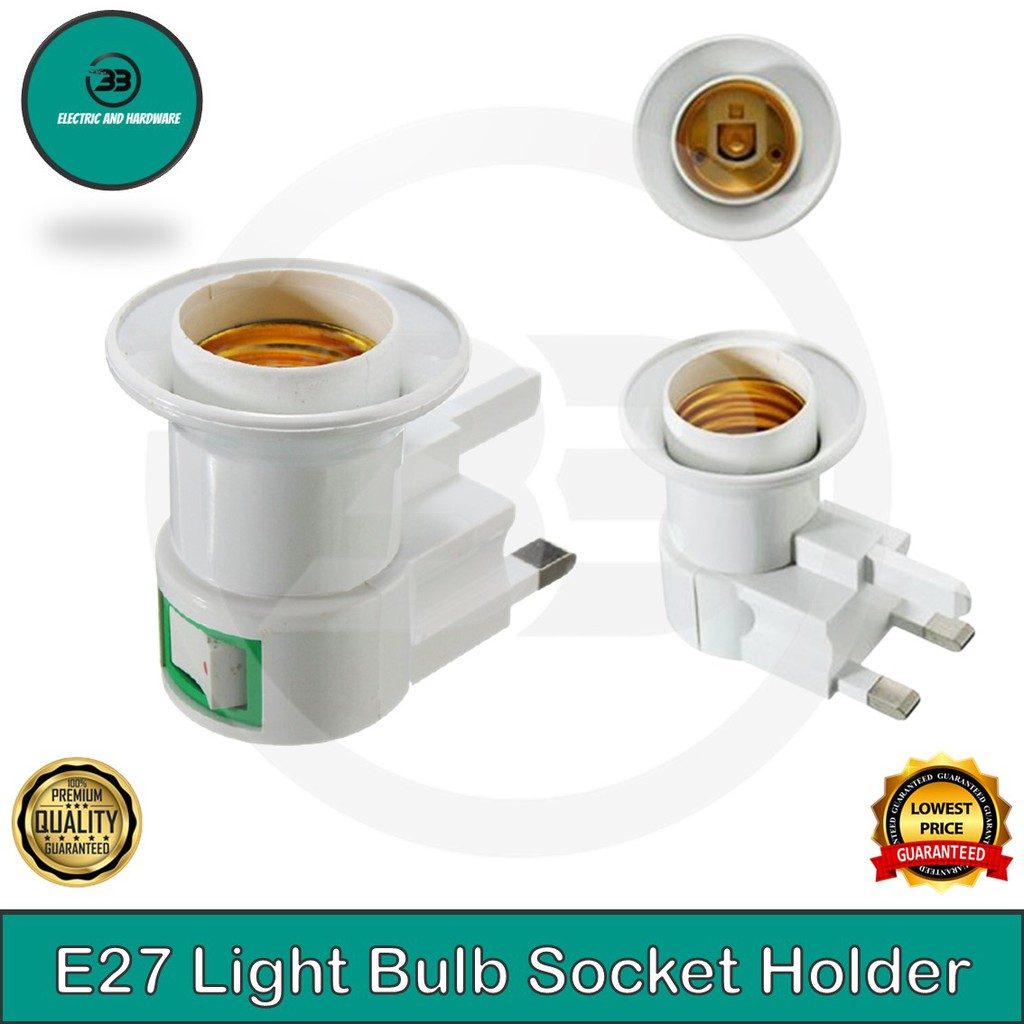

    As for the bulb teardown, you can use something like this to remove the bottom cap, insert 3/4 in then pull slightly until they pop off. Easier to put the cap back in, and less damaging than using pliers.
    White E27 light bulb socket holder with plug, switch, and visible internal contacts.

    Interesting little device you showed there, that indeed should help with the process! Funny enough the other day I watched a random video why the ones underneath exist in the US where you sometimes seem to find light sockets at the bottom of a wall - it's the inverted version of what you showed :)
    Light bulb to electrical socket adapter with plug
