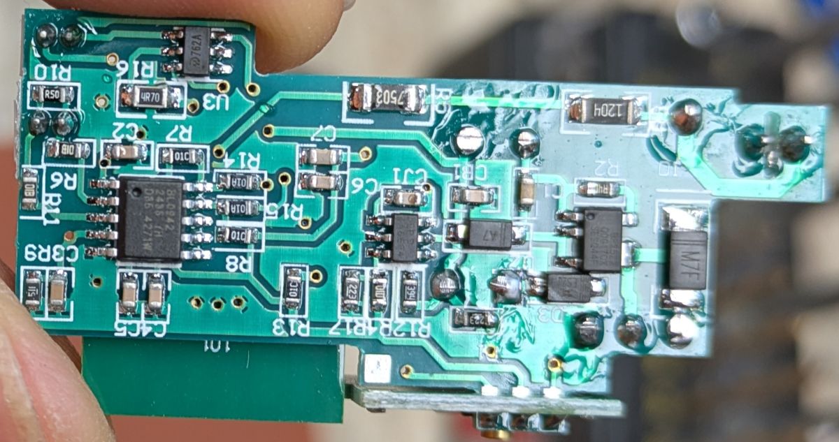

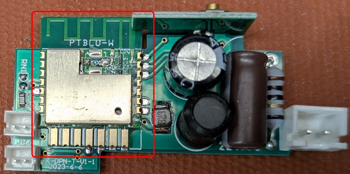

    I'm looking for help to identify the module and thus the pinout (for flashing) for the wifi module in a EARU EAKCB-EWE-M "circuit breaker" that I just bought off AliExpress
    https://www.aliexpress.com/item/1005006189189642.html
    ** Update: with wonderful help from forum members, the EAKCB-EWE-M circuit breaker and associated PTBLU-W wifi module are fairly well documented. Follow this link to get teardown info and pictures, pin out, and other details: https://www.elektroda.com/rtvforum/topic4129041.html#21598413 **
    I've verified that it works with ewelink so I'm hoping I can flash it with new firmware (e.g. OpenBK or Tasmota). I'm attaching pictures of the front and back of the circuit board containing the wifi module.
    FRONT of circuit board (Wifi module circled in red)
    EARU EAKCB-EWE-M WiFi Module Identification and Pinout for Firmware Flashing
    BACK of circuit board
    The only marking I see is "PTBLU-W" in the silkscreen and searching the web comes up empty. There are no markings on the RF shield no matter which angle I look at it. Based on a post I found, I was hoping it would be the PSF-B module mentioned in: https://www.elektroda.com/rtvforum/topic4068651.html but no such luck.
    I'd use a sonoff device, but they generally have a current limit around 20A or less (for a single channel); I need to monitor and control a higher current (30-35A for my EV) and this has a relay rated for 60A.
    Thanks in advance for any help you can offer.

    That's a very interesting module, I haven't seen it before. Would you be able to remove the metal shielding with hot air so we can check which chip is inside?

    Could be an esp32 (wroom-06)
    Looks like cbu, but it’s running ewelink firmware

    I don't have a hot-air tool to remove the metal shielding but I was able to bend back the top right corner. The chip is a BL602.
    I would be happy to post a dump of the code if I can get get it. To get the dump, I need to know pinout of the module. I noticed in another post there's a CBU module that has the same number of pins (7 pins on each side): https://www.elektroda.com/rtvforum/topic4000643.html Although it's not identical (the one in the post has circuitry for temperature, and it runs Tuya code), they may be similar enough to try connecting.
    I found a site with the pinout for the CBU - https://developer.tuya.com/en/docs/iot/cbu-module-datasheet?id=Ka07pykl5dk4u so I'll try and see if that pinout works.  By tracing the circuits on the back of the main PCB I can at least verify the +/- supply pins.

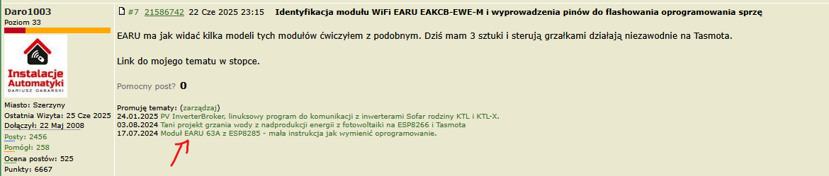

    EARU has as you can see several models of these modules I practiced with a similar one. Today I have 3 pieces and they control the heaters work reliably on Tasmot.
    Link to my topic in the footer.

    @Daro1003 I am very interested in any details about your modules and how you reset them. Your post says there is a link to your topic in the footer (of your post), but I don't see any footer or link? Can you try republishing to include the link? Thanks
    As there is none as there is:
    EARU EAKCB-EWE-M WiFi Module Identification and Pinout for Firmware Flashing .
    And if you don't see it here it is: https://www.elektroda.pl/rtvforum/topic4065799.html
    As you can see my EARU module had a different ESP8285 chip so it was easier for me to do.
    I recommend getting one and you can change the software and use the module without any problems. I currently have three of these that control the heaters.

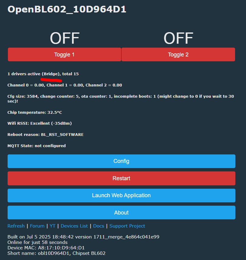

    @p.kaczmarek2 THANK YOU very much for your help. The suggestion to try a different USB -> UART converter worked. I'm still a little puzzled why my other converter didn't work for the BL602, but the important part is that I have a solution! Thanks also to @Daro1003 for all your info.
    It turns out I was able to peel away the metal shield using a pair of pliers. That allowed me to figure out a lot more about the module. I've made a lot of progress: I have plenty of photos, a backup of the 2M flash, an almost complete pinout for the PTBLU-W wifi module, and the OBK configuration for the circuit breaker. For the purposes of anyone doing a web search, the main circuit board for this circuit breaker is labelled "YK-DPN-T-V1-1" and dated 2023-6-6. Where is the best section of the forum to post all the info - here in this thread or somewhere else?
    I still have some things to figure out:
    - The relay is bi-stable, so I need a nice simple way of controlling it.
    - If I load the BL0942 driver manually, everything works perfectly; if I load it from the startup command, the unit becomes unreachable. I don't know why this happens. I think a work-around is to load the driver after a delay, but I saw a recent post saying delay and delay-ms don't (yet) work in the backlog command.
    - On the wifi module, GPIO22 from the BL602 appears to connect only to a 200K resistor that goes to 3.3V. I can't figure out what this is supposed to do or why it has been included in the circuitry.
    It's the national holiday in Canada at the beginning of next week, so I'll complete this thread and answer any questions in the middle of next week.
    Thanks again for all the help.

    I don't have BL602 at hand at the moment, but it seems that BL602 has LFS and scripting enabled, so after recent changes backlog with delay should work as well.
    Is BL602 startup command multiline?
    If so, you don't even need backlog, you could do:
    delay_s 5
    startDriver BL0942
    Of course, this doesn't change the fact that BL0942 shouldn't crash on startup.... @insmod any ideas?

    Confirmed on BL602 1.18.127
    delay_s 5
    startDriver BL0942
    Will reboot loop the device until it goes to safe mode. Didn't check the output log on it at all but will plan to do it at some point and report back.
    Boot log shows BL602 reboot loop with no IP assignment
    #19 21593308
    Posts: 5236
    Help: 450
    Rate: 920
    same. Nothing in log though, just loops.

    1.18.95 https://github.com/openshwprojects/OpenBK7231...mmit/5916fbd8a7703368aa07891822261f6b75c5f0f2
    Added after 9 [hours] 41 [minutes]:
    in startup command or autoexec for me on 1.18.90 does not cause boot loop.
    extend the delay to 10s on 1.18.127 and it seems to be OK.
    enable flag 26 ([UART] Use alternate UART for BL0942, CSE, TuyaMCU, etc) on 1.18.127 and the log out no longer goes silent after starting bl0942 and does not boot loop with delay_s 5

    @divadiow - I have a working config now, but still experiencing some problems. e.g. I haven't figured out how to use the BridgeFWD/REV roles for controlling the relay. In one of his last postings https://github.com/openshwprojects/OpenBK7231T_App/issues/667#issuecomment-1429877635 , valekCN referred to creating documentation ("I have not yet updated README will do it soon"); either it's not yet done and/or I'm not sure where to look. Other issues are almost certainly related to me being very new to OpenBK and just learning how things work. Thanks.
    P.S. Please let me know if my teardown isn't in the right section of elektroda.com and I'll move it!
    P.P.S I have a dual-pole version of this circuit breaker arriving in a few days. Hopefully it uses a known wifi module and not an entirely new and different one!!

    #25 21598472
    Posts: 5236
    Help: 450
    Rate: 920
    cool.
    I don't know much about the BridgeREV and BridgeFWD roles. I don't think I have ever had a device that needs them.
    Assuming it needs the bridge driver, it doesn't look to be enabled on BL602 though
    https://github.com/openshwprojects/OpenBK7231T_App/blob/main/src/obk_config.h#L178
    here's a build with it enabled: https://github.com/openshwprojects/OpenBK7231T_App/actions/runs/16091030578

    ProfAnderson
    Level 4  
    Posts: 18
    Rate: 10
    Completed a teardown of the unit; this allowed me to trace the wiring and determine pinout. I got help along the way from forum members - Thank You!
