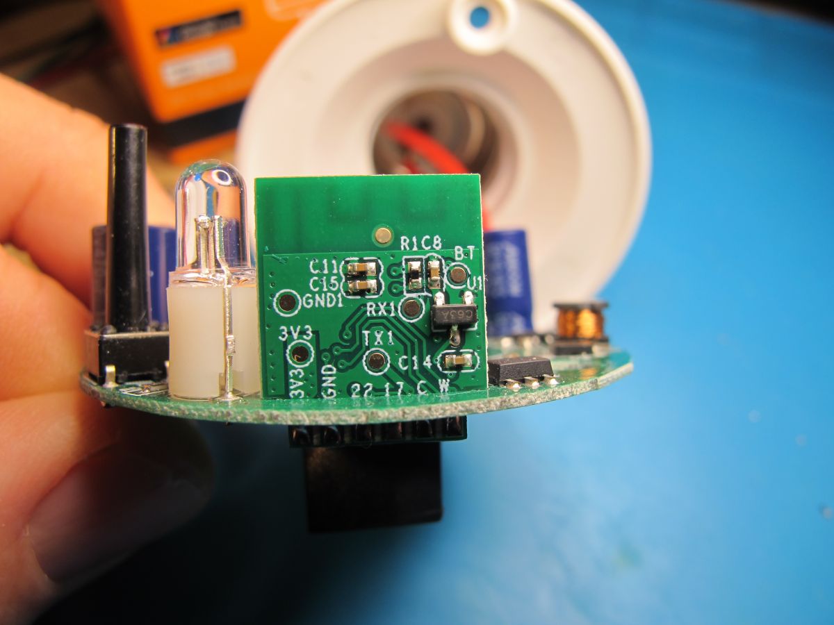

    I got a new IOT device and it came with a BL602 on a breakout board. I am not sure what the layout of this board is and how I would connect to get it flashed. If anyone can provide me with some tips that would be great.

    It should be very simple. It has all required pins on the back side of the board. See:
    - 3.3V
    - BT (bootloader)
    - RX1
    - TX1
    - GND
    It's all that's needed. You should follow my guide at:

    Thank you for the reply. Maybe you could highlight which pins correspond to which.
    3 volts is obvious but the rest may not be. Also for future reference of anyone else. Especially which pin is boot on the picture.

    BT = BooT = Bootloader.
    RX from board should be connected to TX from UART to USB converter, and TX from board should be connected to RX from USB to UART converter.
    (UNLESS someone is using non-standard naming on board, then please switch RX and TX).
    Are you aware that you should use 3.3V power supply for that? 5V connected to 3.3V pin would burn BL602.

    bl602newbie
    thank you very much for your answer and your tip.
    What I meant was which pin corresponds to which pin on the board.
    so 3v3 pin is obvious the 3 volt pin
    Gnd is obviously ground
    but then it's only written as 22 17 C W
    maybe if you could specify
    22 = ?
    17 = ?
    C = ?
    W=?
    and I'm not sure if we need the pins on the back of the board.

    Well, if it's a RGBCW bulb, then C is a cool white channel, W is warm white, R is red, G is Green, B is Blue.
    I don''t know about L and A, can you show the whole device you have?

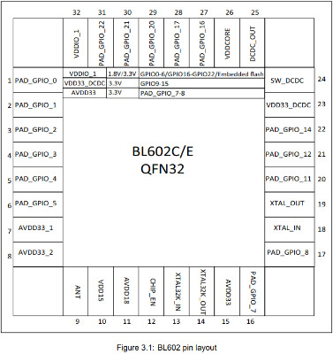

    also, have you tried looking at this image? You can see where the dot mark is on your photo: BL602 IoT Lamp Breakout Board: Pinout Layout & Flashing Tips

    Well that is the issue. Figuring out the pinout from the chip diagram to the actual board.
    So we know we need for example TX and RX and the BOOT pin but which pins are those on the actual PCB board that are labeled using that combination of letters.
    I am really not good at following the traces on the board. I suspect that these letters and numbers mean something but I'm not experienced enough either to know what they are referring to.
    I can't post a link to the product but it's just a lamp holder. It's a socket for a light bulb nothing else. It should just turn a bulb on or off.
  • Pinout identification by aligning the first pin mark
    #8 20103128
    Posts: 14755
    Rate: 12880
    This is very simple. You align the pinout image just so it matches the dot mark (first pin) and then look at pins.
    See:
    Your photo is a bit blurry, so I am not able to tell 100% which pin goes where, but as you can see, I marked pins with colors....
    This is what I do to find out the pins of unknown module. I have never seen your module before.

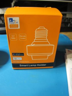

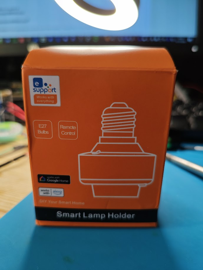

    I believe the topic of the thread is this device, which does indeed come with an SM-028_V1.3 module
    Packaging of a smart lamp holder E27.
    If correct I'll flesh this post and its profile out.

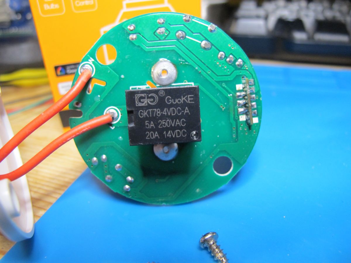

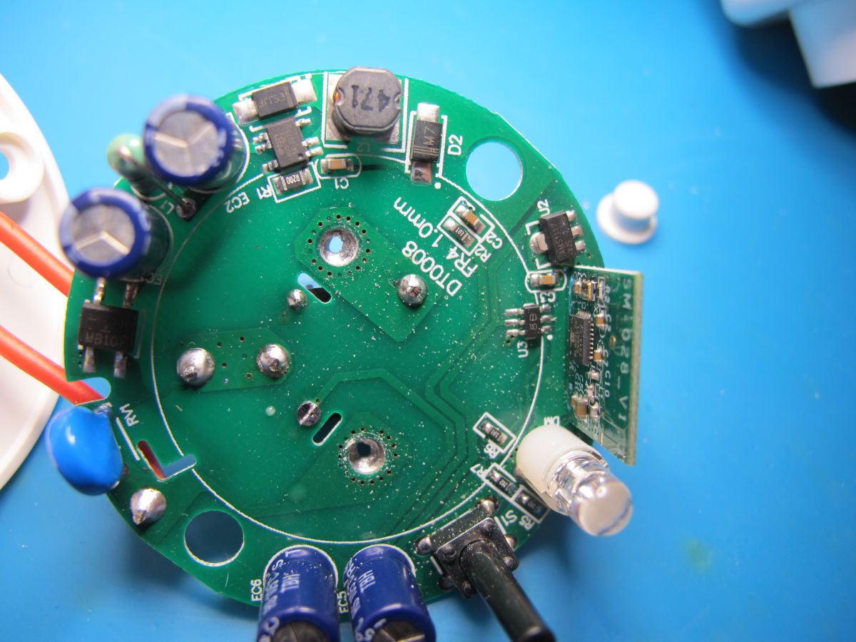

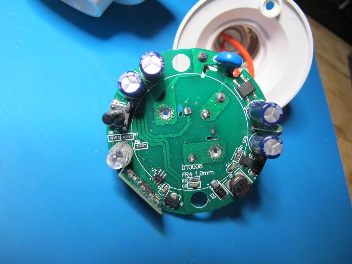

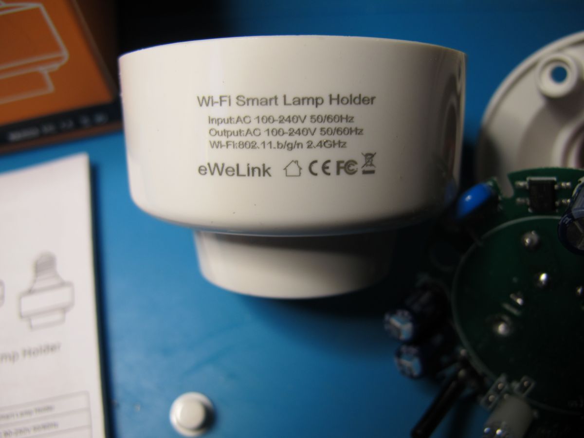

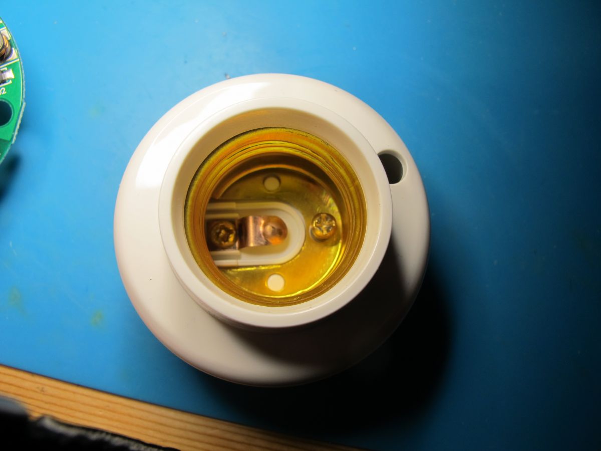

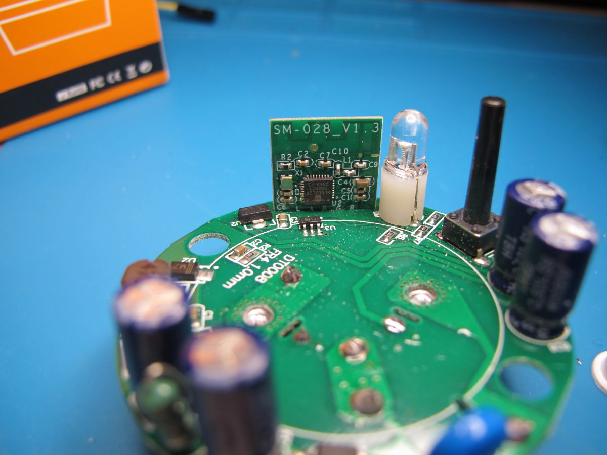

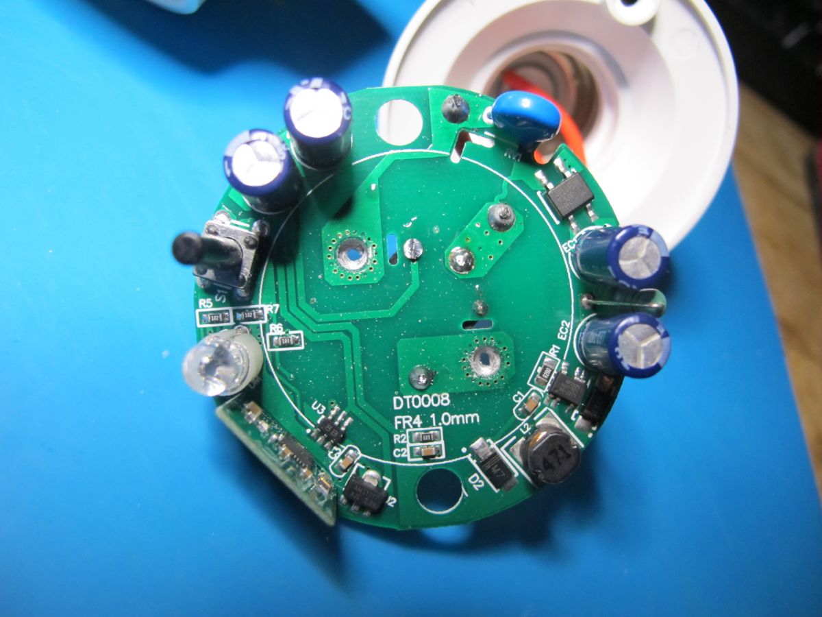

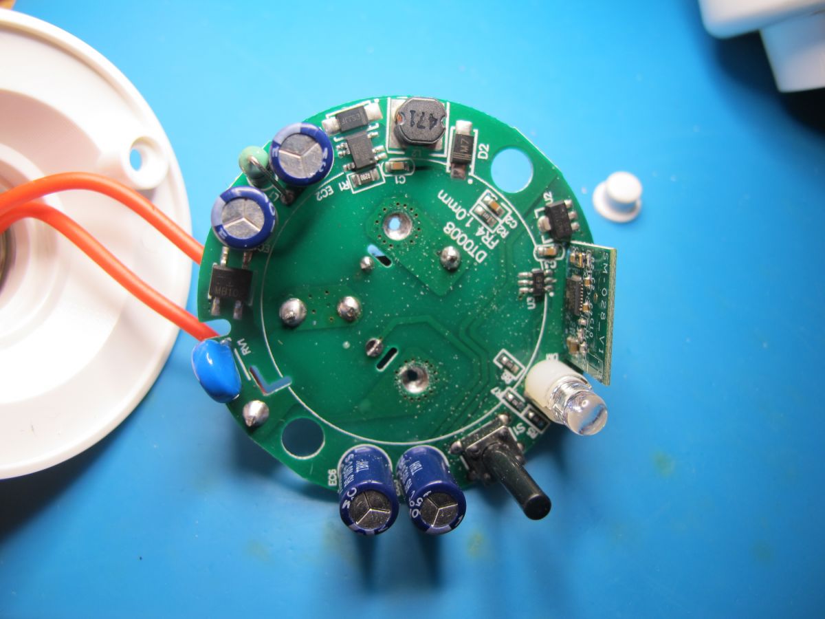

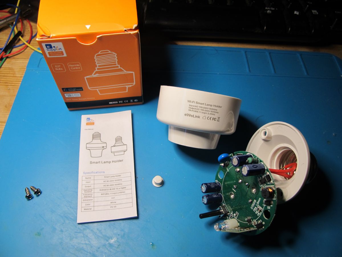

    95% sure I have the device in question. The template on devicelist doesn't contain any pin assignments so I suggest it be changed to:
    Orange box with a smart E27 lamp holder. View of Smart Lamp Holder on a table with box and instructions.
    Close-up of an E27 lamp socket showing metal contact elements. Close-up of a circuit board with electronic components. Close-up view of the circuit board for an E27 smart lamp. Close-up view of a circuit board with several electronic components. SM-028 V1.3 PCB with electronic components. Interior of an E27 smart lamp holder showing electronic components. View of a circuit board with electronic components and markings. Circuit board with electronic components mounted in an E27 lamp holder. Device circuit board with visible electronic components on a blue background. Smart Wi-Fi Lamp Holder by eWeLink with visible technical specifications.
    boot log:
    the assignments at the end of the log seem to suggest the red LED (wifi status is blue - P22) is GPIO0 but this doesn't appear controllable, PWM, LED, REL etc
    So the behaviour with this template is the blue LED is flashing until wireless is connected, then it's off
    the red LED comes ON with the bulb ON - ie the relay closed. perhaps it serves as a warning that the socket is live, rather than a signal the bulb is off.
    Factory firmware backup attached
    https://github.com/OpenBekenIOT/webapp/pull/162
    • flash.bin (2 MB) You must be logged in to download this attachment.

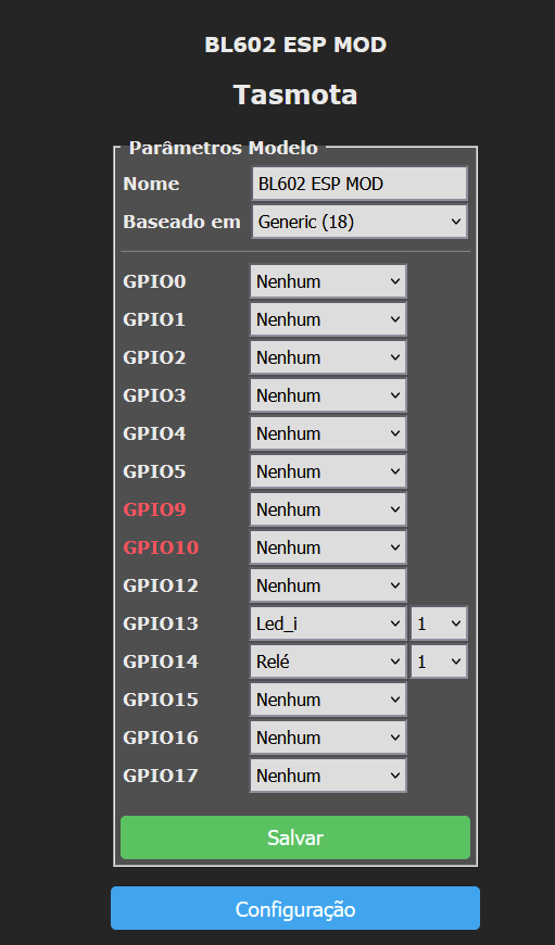

    tadeu1
    Posts: 83
    With this config for now, I can turn on and off, LED blue still on when is on and nothing when is off.
    I'm trying to figure out to fix the button first then the energy controller.
    Any guess?
    Tasmota web interface showing GPIO settings for BL602 ESP MOD device
  • #21 21791521
    Posts: 14755
    Rate: 12880
    I would need to know more about your device. I don't even see the information what kind of power metering IC do you have? I guess it's either BL0942 or BL0937, but who knows...
    You don't have much GPIO options, but using multimeter to check how it's all connected is safest bet.

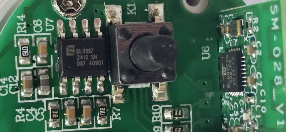

    Well, we have GPIODoctor, which can be used to quickly sample pins:
    https://www.elektroda.com/rtvforum/topic3976371.html
    We also have Tuya config extraction, but not for BL602.... but @divadiow did some experiments with BL602 as well, do you have original 2MB flash backup from BL602 chip>?

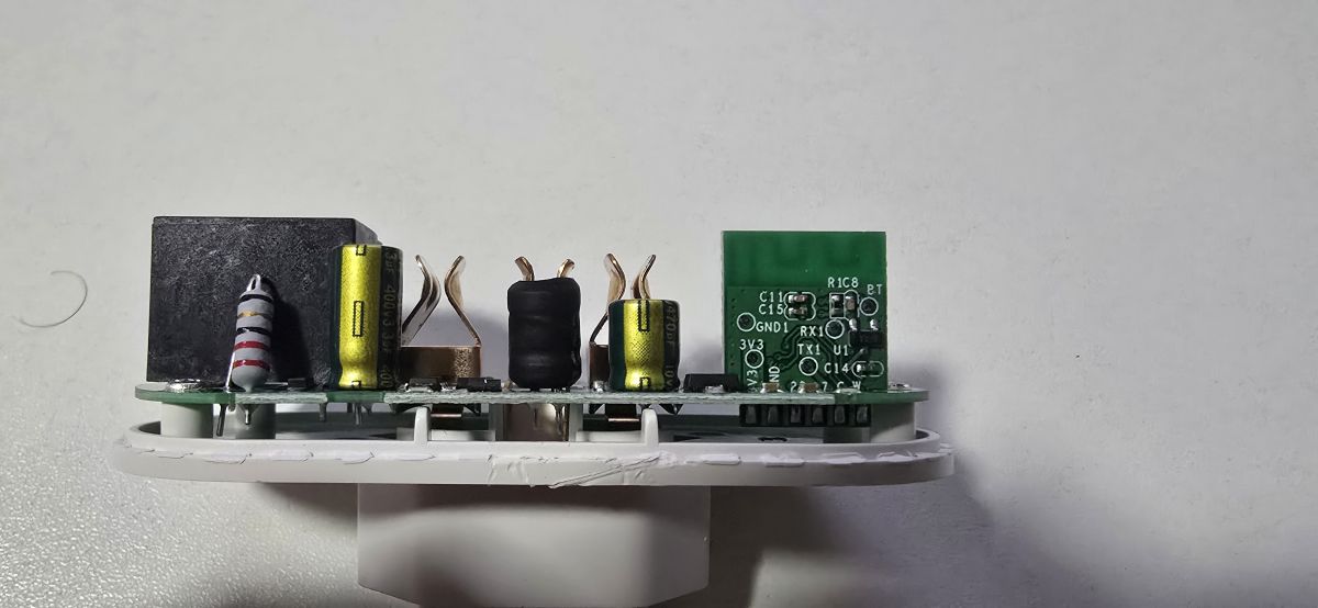

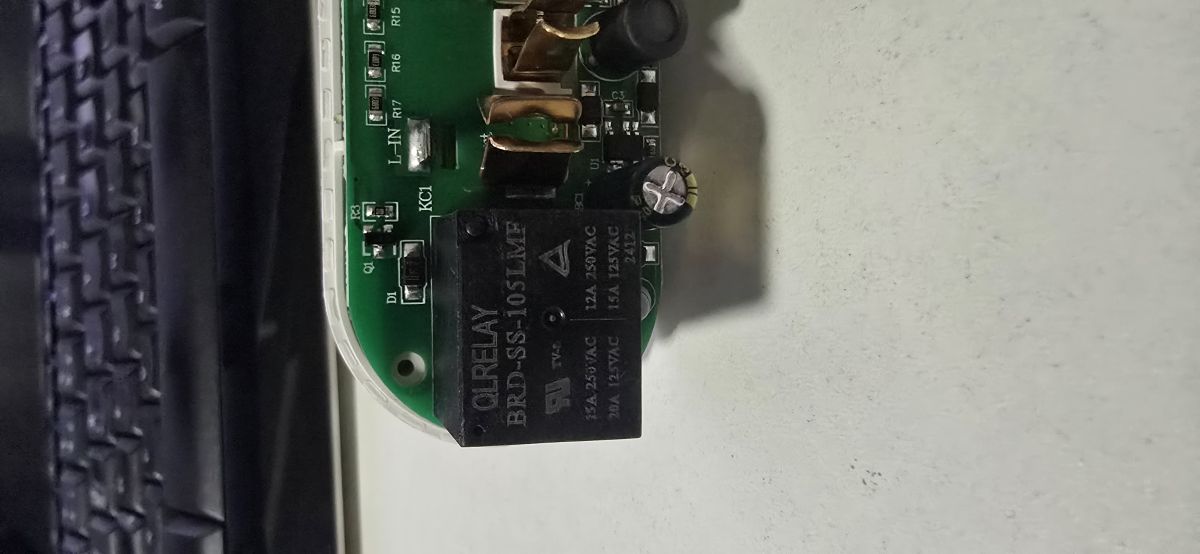

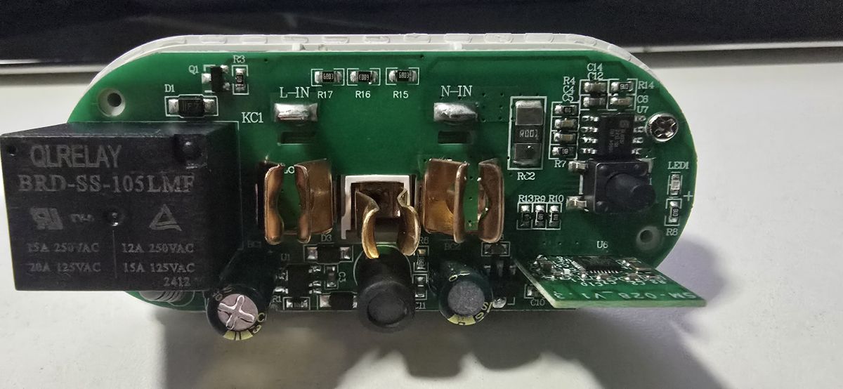

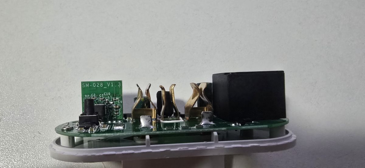

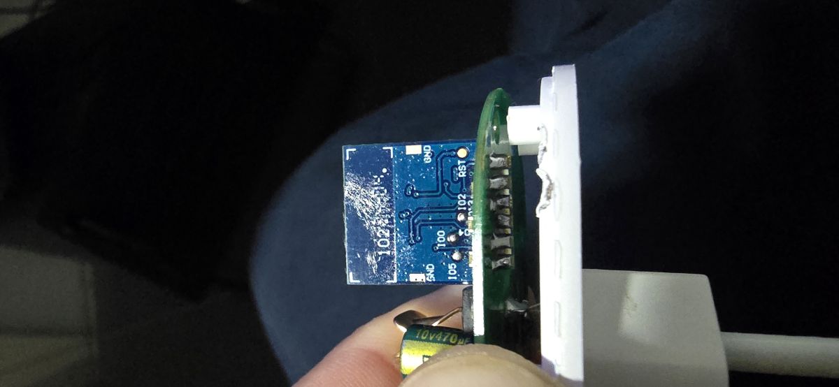

  • Broken IC0 pin led to ESP-02S soldered workaround
    #25 21792009
    tadeu1
    Posts: 83
    Some pics Circuit board SM-028_V1.3 with electronic components and clamp connectorsSide view of PCB with ESP-02s module and electronic components solderedElectronic module with QRELAY relay and L-IN/N-IN connectors on a green PCBClose-up of PCB with QJRELAY BRD-SS-105LMF relay and electronic componentsClose-up of a PCB with a push-button, BL0937 and BL60220 chips, and SMD components
    >>21791979 Thanks, man, have 2 of those
    One, I broke the IC0 pin; that's why I soldered the ESP-02s
    I'll do the backup in the other one.
  • #26 21792083

    The problem is: Tasmota only. Have BL0973 CF, not CF1 or SEL.
    Thanks
    I'll try to get it. Works on ESP-02S

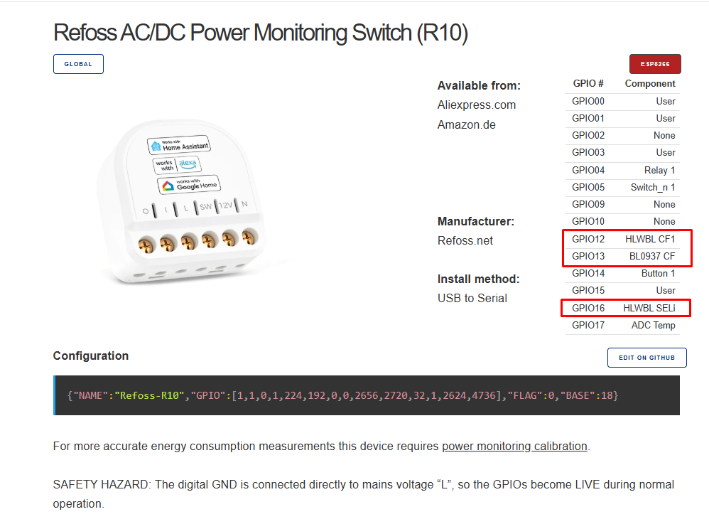

  • #30 21792293
    Posts: 14755
    Rate: 12880
    This has different name in Tasmota, but works the same as in OBK.
    See a random Tasmota template:
    https://templates.blakadder.com/refoss_R10.html
    I have underscored the roles you need to set.
    Refoss R10 power switch with GPIO pin mapping and voice assistant compatibility
    Of course, for your device, pin indexes will be different!
Discussion focuses on identifying the pinout and flashing connections for a BL602-based IoT lamp holder breakout board. The board exposes 3.3V, GND, RX1, TX1, and BT/bootloader pins on the back side, with RX/TX needing cross-connection to a USB-UART adapter and 3.3V power only. Later analysis identifies the device as an eWelink E27 AC90-250V smart lamp holder using an SM-028_V1.3 module with BL602, and a dumped firmware image reveals GPIO assignments for relay, button, WiFi LED, and energy metering signals. The thread also covers BL602 backup/flashing tools, DTB extraction, calibration of the power meter, and an attempted replacement of BL602 with ESP-02S/ESP8266, noting that GPIO mapping differs and may require manual wiring.
TL;DR: Need to flash a BL602 lamp board? Its factory boot log shows 6 partitions, and “BT = BooT = Bootloader.” Power at 3.3V, cross RX/TX, and use the rear BT pad to enter flashing mode. [Elektroda, divadiow, post #21305303]
Why it matters: This FAQ helps newcomers quickly identify pins and safely flash the SM-028_V1.3 BL602 lamp holder without guesswork.
Which pads do I actually need to flash the BL602 lamp board?
Use five pads on the back: 3.3V, GND, RX1, TX1, and BT (bootloader). That’s sufficient for flashing. [Elektroda, p.kaczmarek2, post #20102439]
Which pad is the bootloader pin on this board?
The bootloader pad is labeled BT. As the expert put it, “BT = BooT = Bootloader.” Hold it appropriately during flashing. [Elektroda, p.kaczmarek2, post #20102808]
How do I wire RX and TX to my USB‑to‑UART adapter?
Connect board RX to adapter TX and board TX to adapter RX. If the board uses non‑standard labels, swap them. [Elektroda, p.kaczmarek2, post #20102808]
Is there a clear, step‑by‑step flashing guide I can follow?
Yes. Follow the author’s BL602 flashing guide linked in the thread; it covers pads, wiring, and tool usage. [Elektroda, p.kaczmarek2, post #20102439]
How do I orient the pinout when tracing pads on an unknown module?
Match the chip’s dot mark (pin‑1) to the pinout image, then trace the pads from that reference. [Elektroda, p.kaczmarek2, post #20103128]
Which module is inside the E27 AC90‑250V smart lamp holder, and what GPIOs matter?
It uses the SM-028_V1.3 BL602 module. Typical assigns: P14=Button, P20=Relay, P22=Wi‑Fi LED. [Elektroda, divadiow, post #21305303]
What useful data can I read from the boot log?
You’ll see partition count, flash geometry, and UART speed. Example: 6 partitions and 2,000,000‑baud UART. [Elektroda, divadiow, post #21305303]
Can I enter bootloader mode without soldering directly to the microchip?
Yes. Use the exposed rear pads, especially BT, RX1, TX1, 3.3V, and GND, to avoid chip‑level soldering. [Elektroda, p.kaczmarek2, post #20102439]
My blue LED flashes until Wi‑Fi connects; is that expected on this module?
Yes. Template notes show WifiLED on P22. The blue LED flashes until connection, then turns off. [Elektroda, divadiow, post #21305303]
The red LED turns on with the relay; is that normal?
Yes. Reports show the red LED tracks the relay state, indicating the socket is live when ON. [Elektroda, divadiow, post #21305303]
