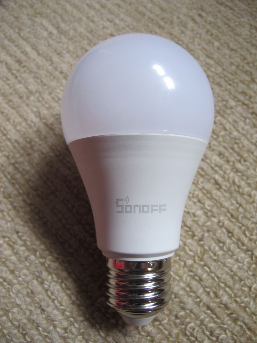

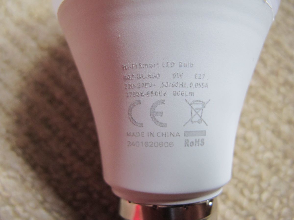

    Sonoff B02-BL-A60 ES/E27 LED CW+WW bulb from Ali Express
    https://www.aliexpress.com/item/1005001933250712.html
    Product page displaying the SONOFF smart Wi-Fi LED bulb.
    https://sonoff.tech/product/smart-lighting/b02-bl-b05-bl/
    Box of Sonoff B02-BL-A60 Wi-Fi bulb. Packaging of a Sonoff Wi-Fi Smart LED Bulb. Packaging of a Wi-Fi Smart LED bulb. Blue box with description of B02 bulb compatibility with SONOFF products. Sonoff LED bulb on a carpet. Close-up of a Wi-Fi LED bulb with technical information on the casing. View of the interior of an LED bulb with visible electronic circuit and LED diodes. LED module with electronic components and light diodes. Disassembled LED bulb lying on a blue table.

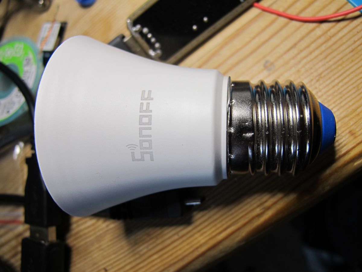

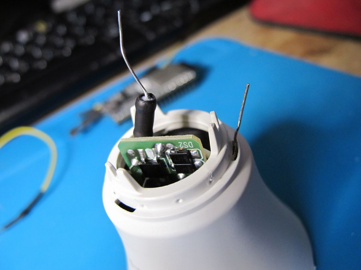

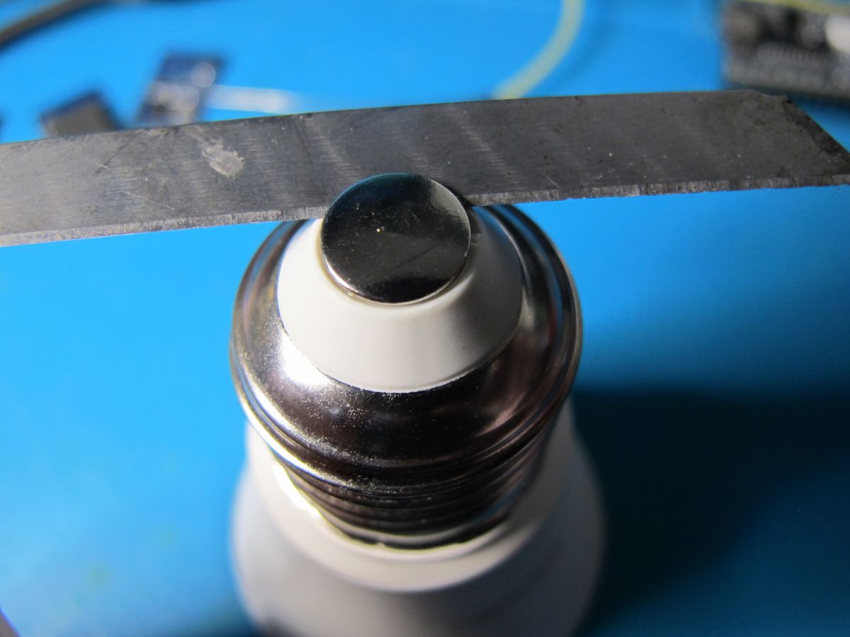

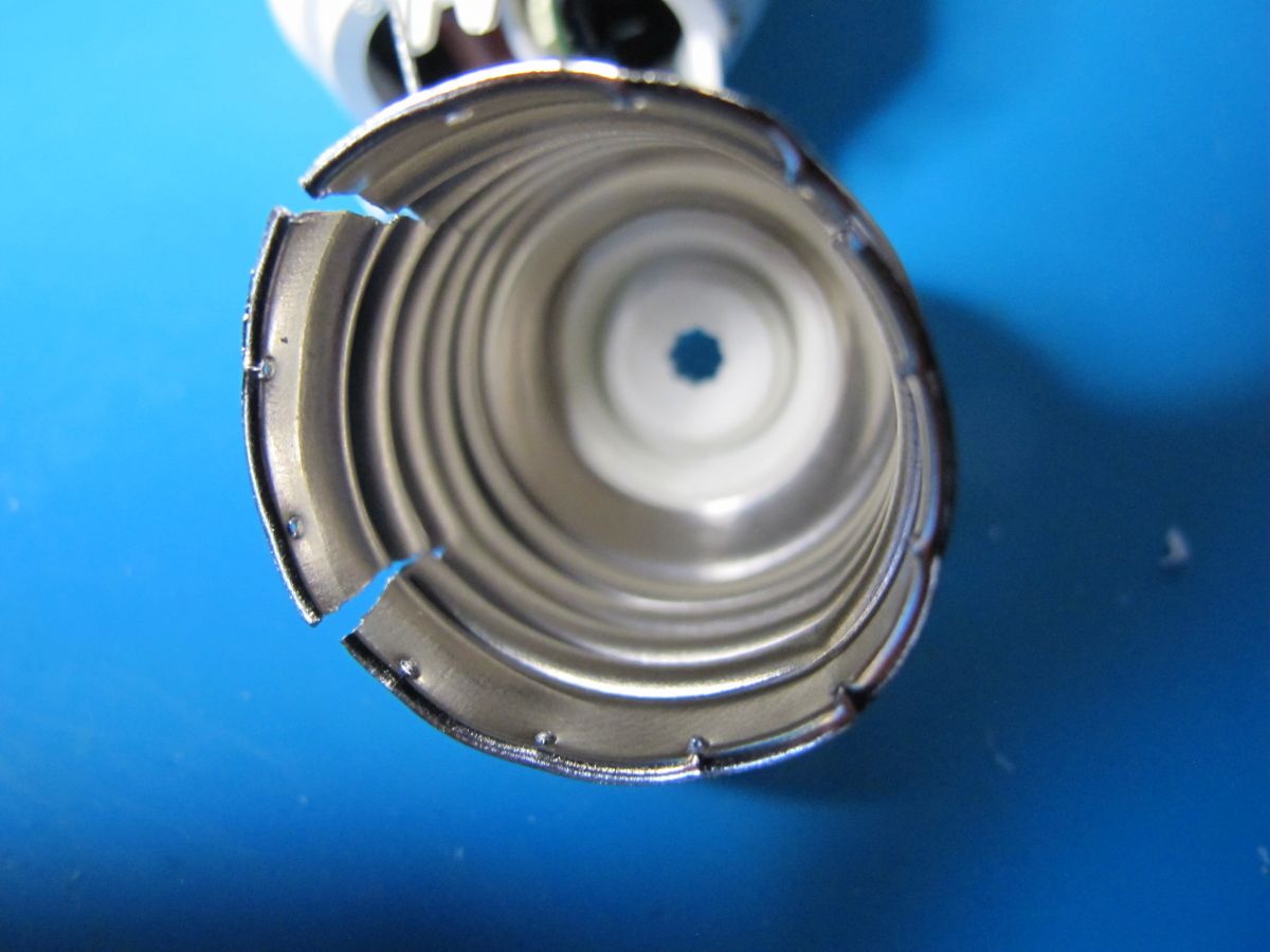

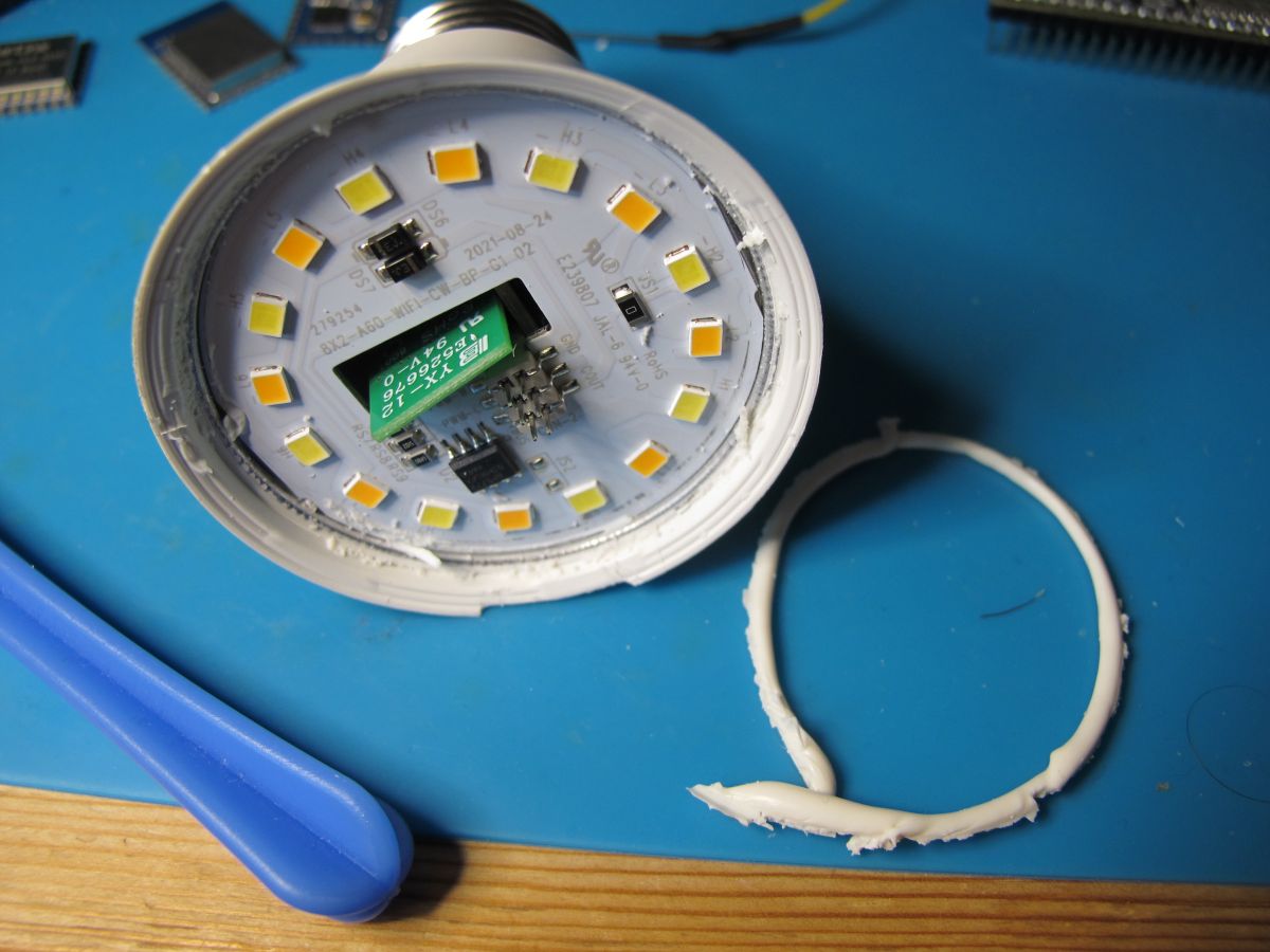

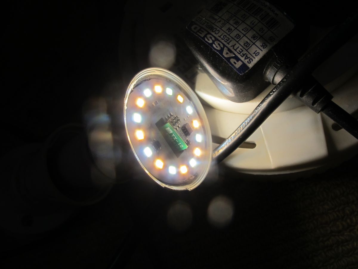

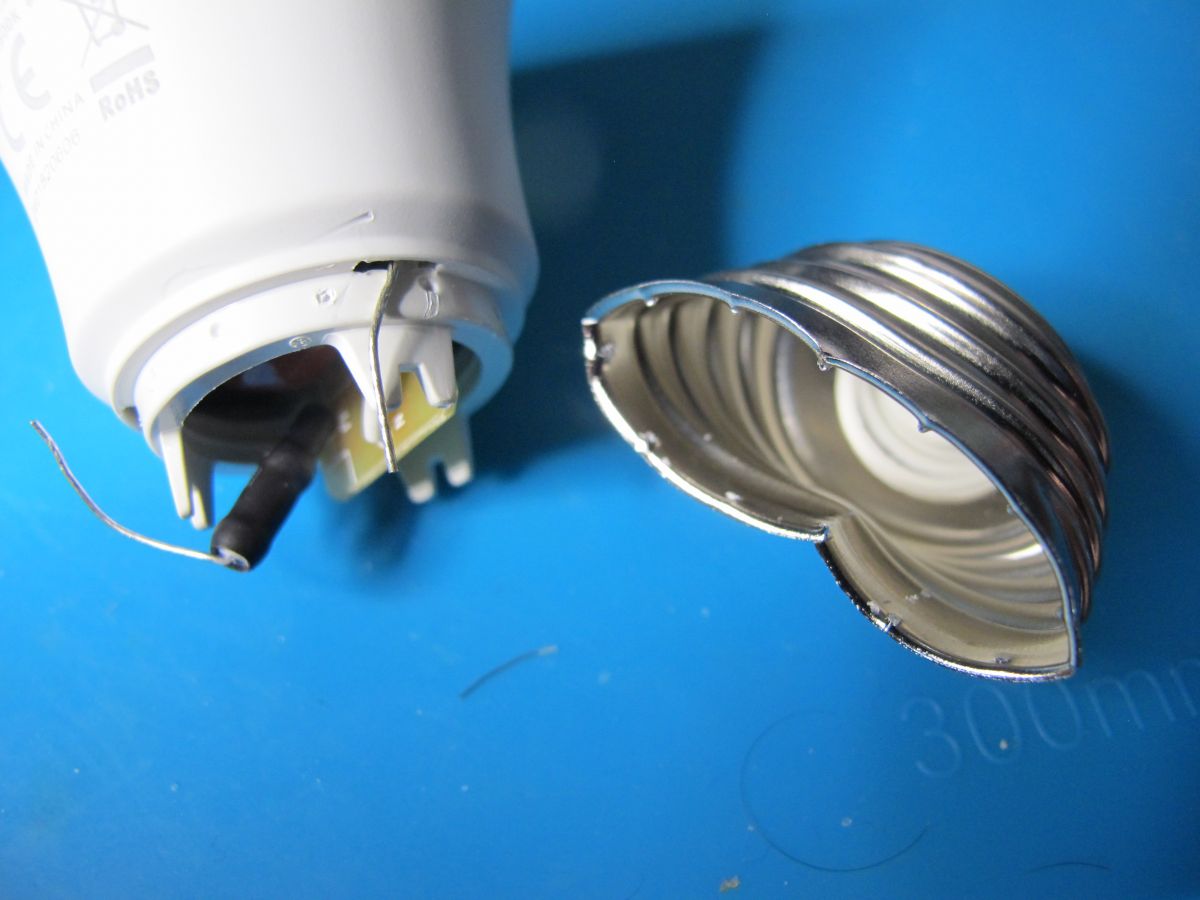

    Removal of positive plug and then too brutal a removal of the screw fitting. Broke it even more trying to to reshape
    A light bulb shown in close-up, held in a vise. Close-up of a damaged LED bulb with a detached metal screw base. Metal cylinder with grooves and holes on a blue background.

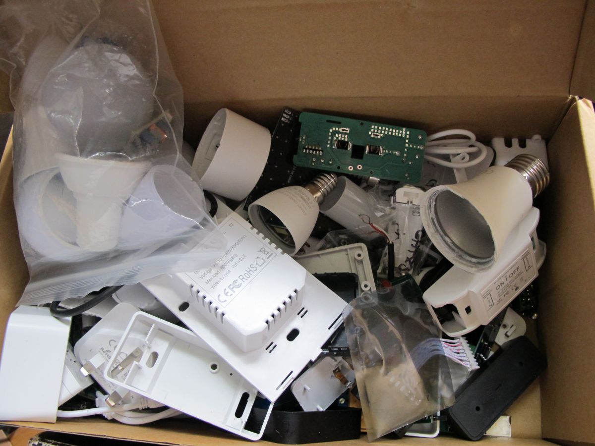

    spares box to the rescue
    A box with various electronic components, such as LED bulbs, mounting brackets, and electronic circuits.

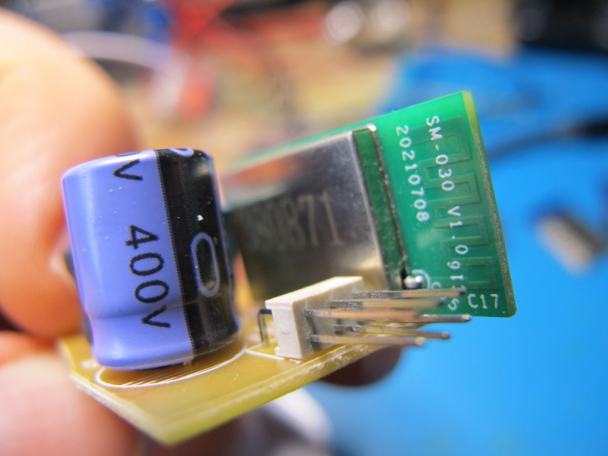

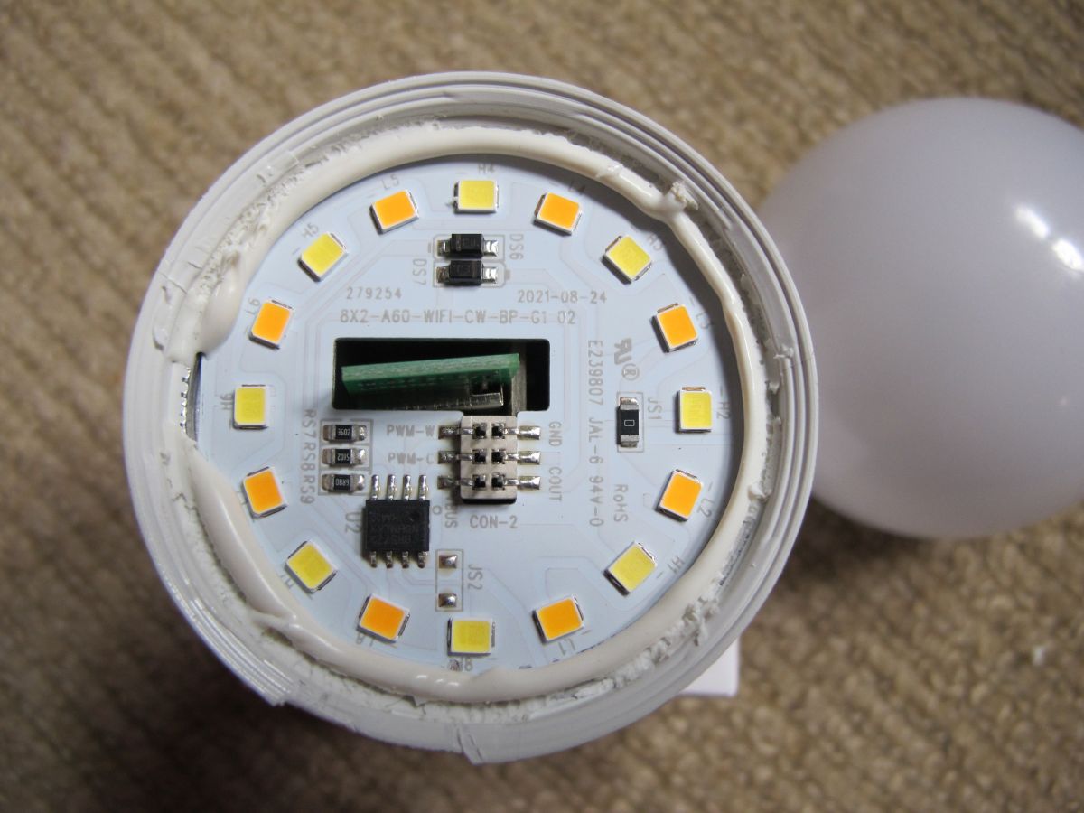

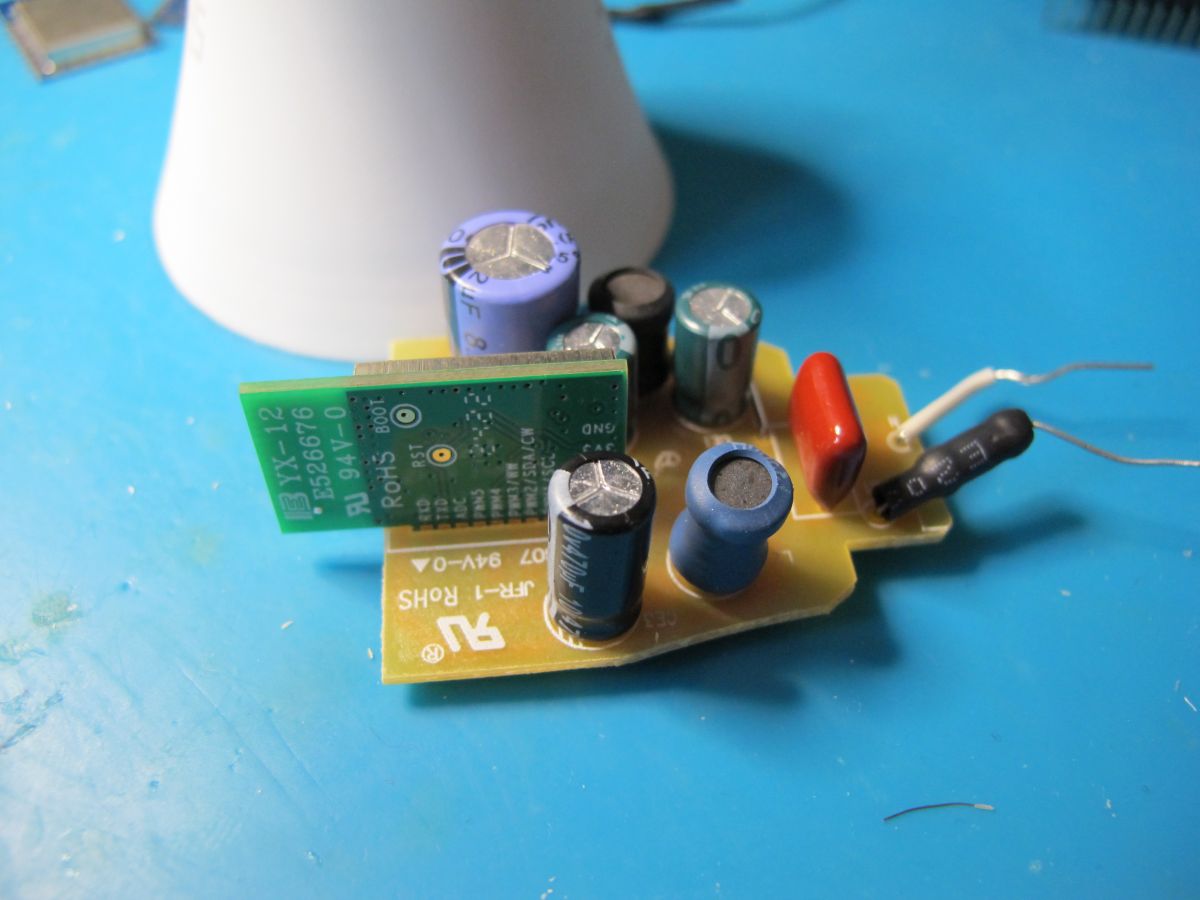

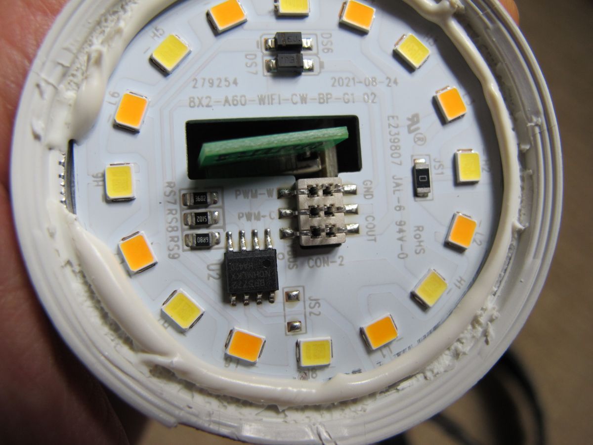

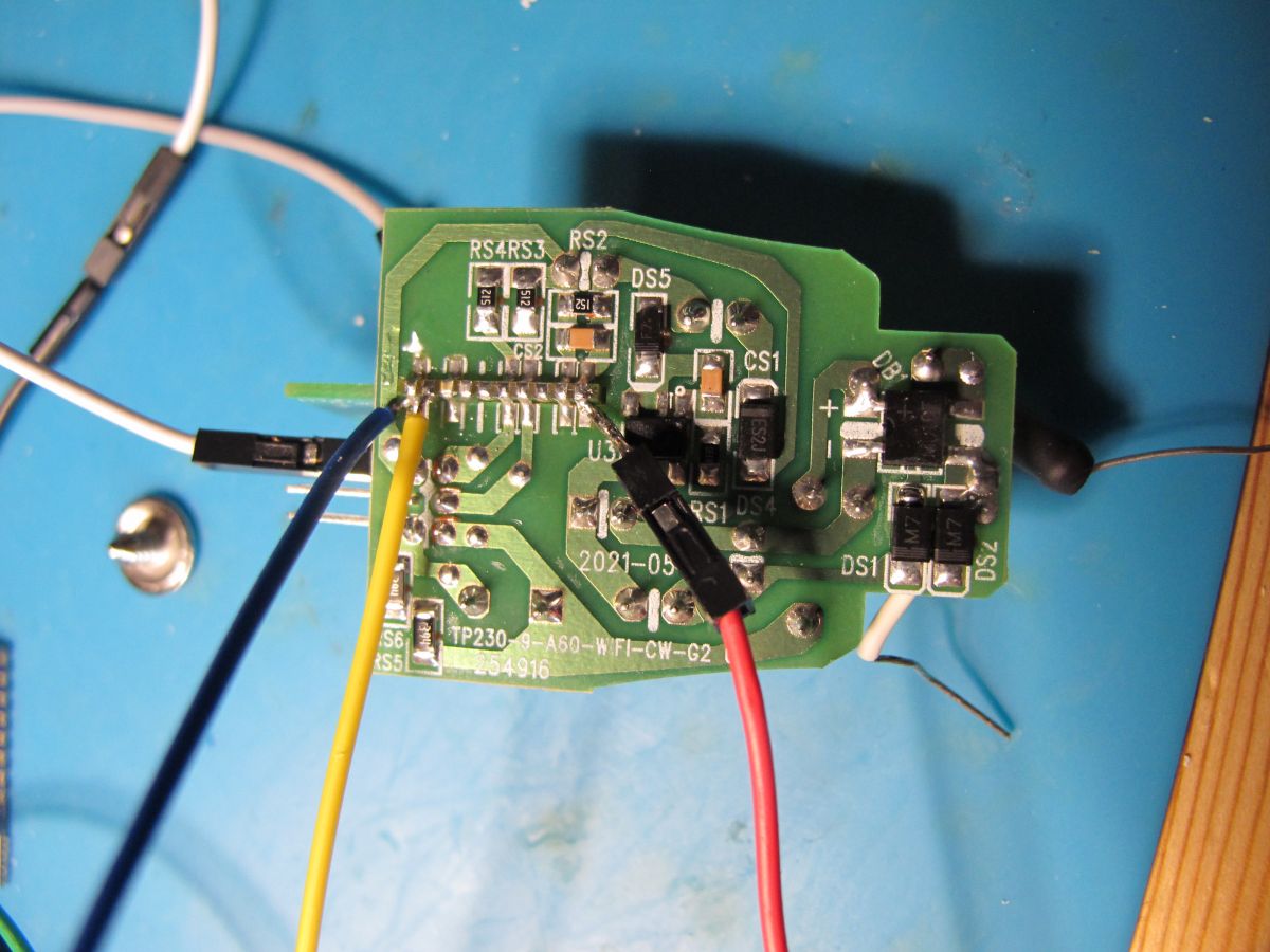

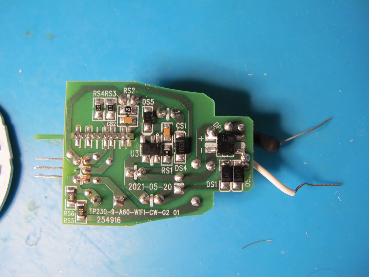

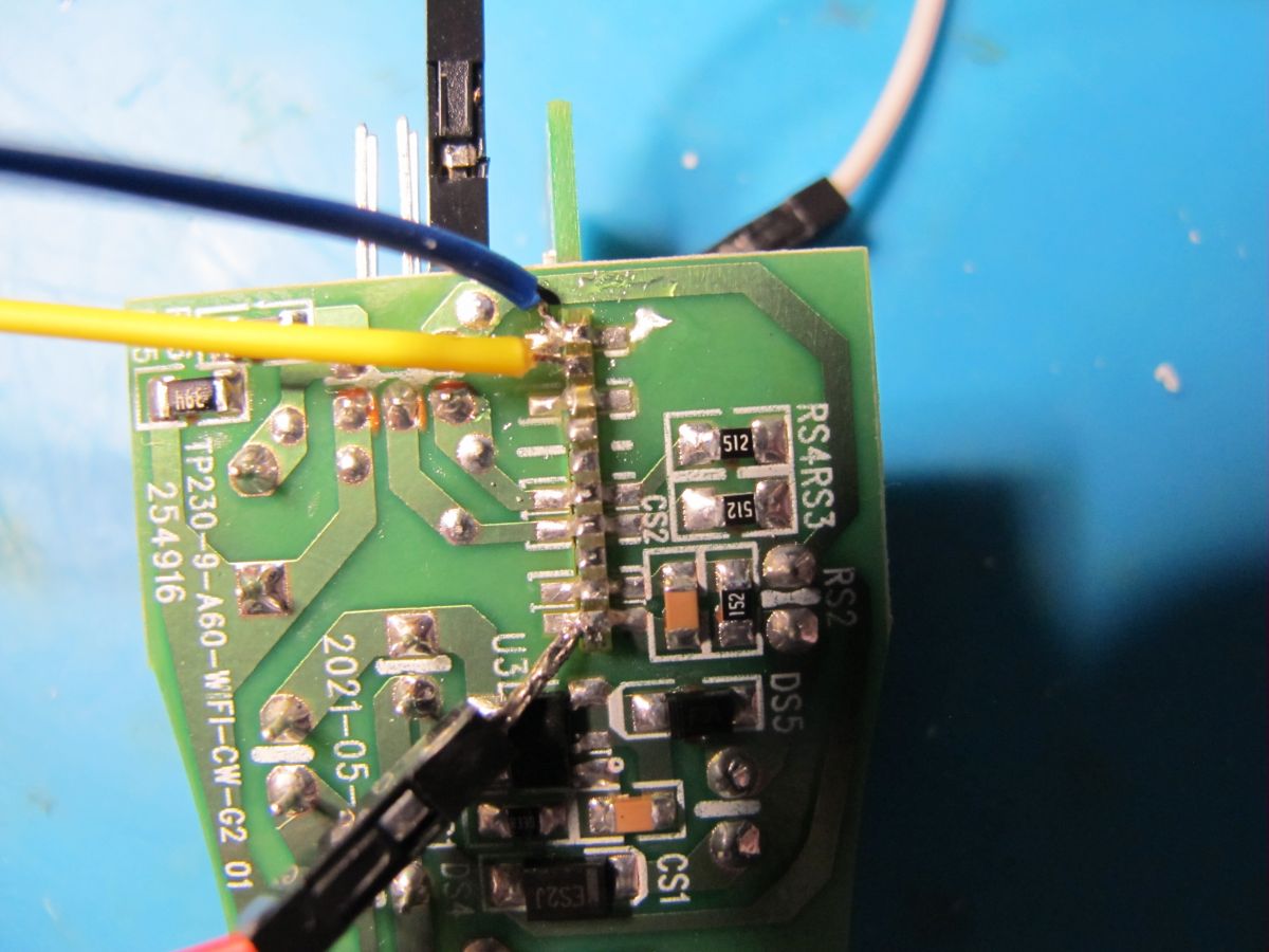

    more internals
    Open plastic casing with a visible circuit board and protruding wires. Printed circuit board with electronic components on a blue background. Close-up of a circuit board with visible electronic components. LED bulb PCB with multiple LED diodes and electronic components on a blue background. Close-up of an electronic circuit board with a green YX-12 module and a capacitor. Electronic circuit with capacitors and other components on a blue surface. Circuit board of a Sonoff B02-BL-A60 bulb with visible electronic components.

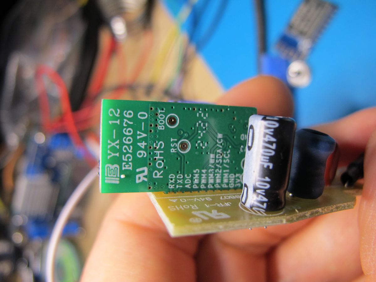

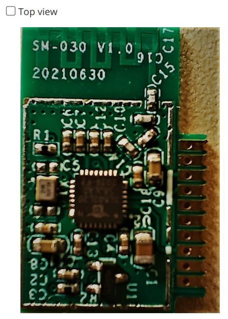

    SM-030 module with a 400V capacitor and circuit board.

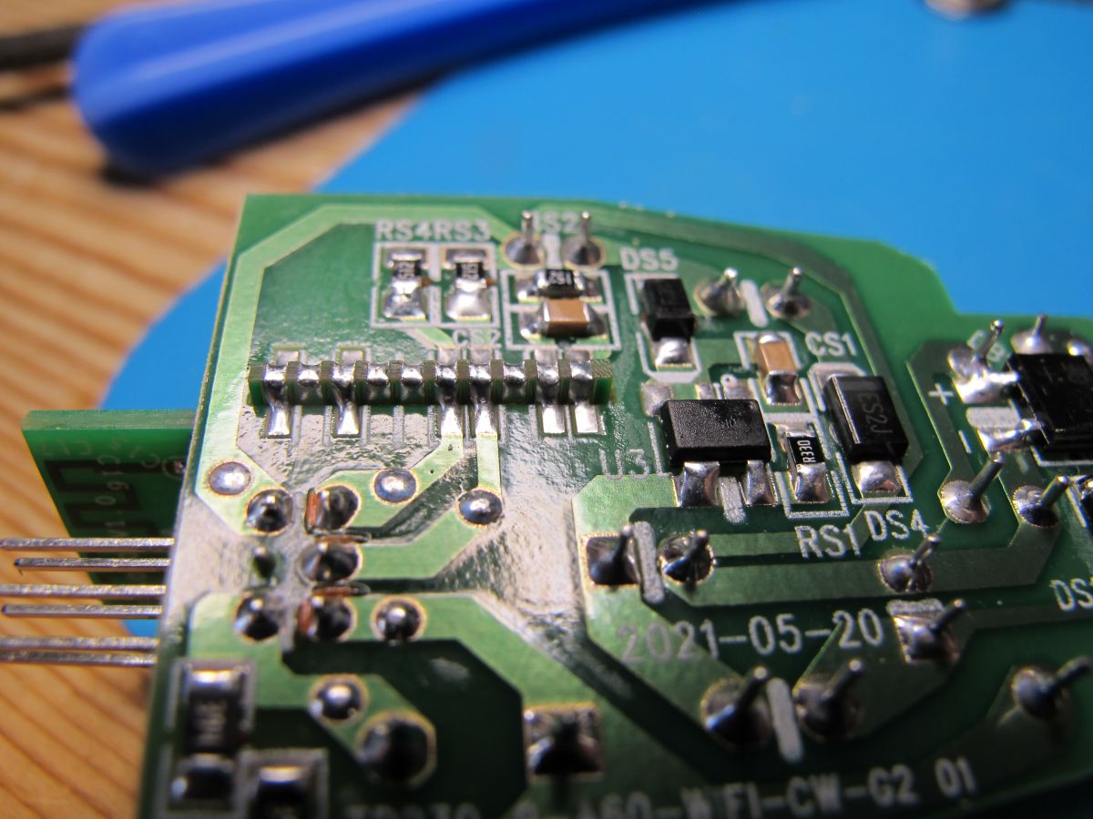

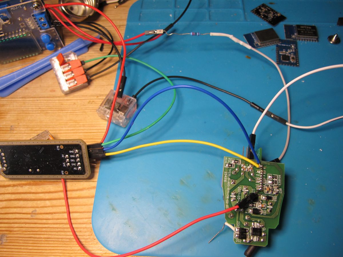

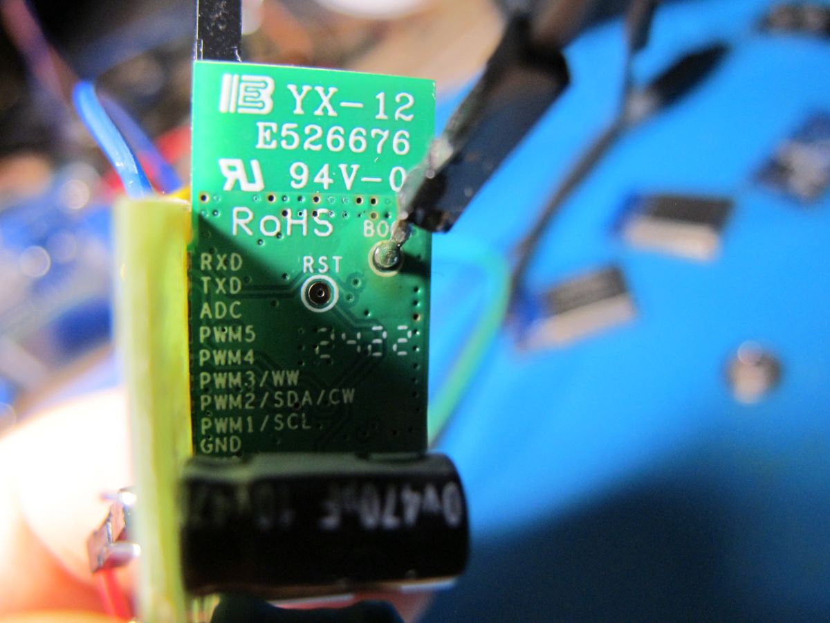

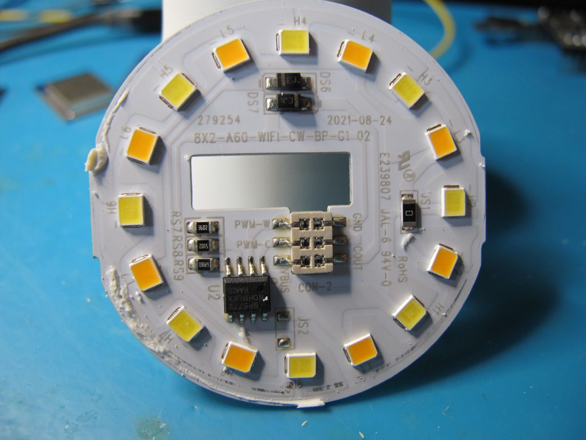

    Despite the pads being quite small it was still possible to solder without removing the whole module. Ground pin to the LED disc was used.
    Close-up of an electronic module with visible component labels. Close-up of a circuit board with soldered wires. PCB with wires connected to components Circuit board with connected wires on a specialized workstation.
    10k resistor from boot (GPIO8) to 3.3v to get into UART download mode
    RX/TX labels on SM-030 module are where theyre to go to, so RX pad to USB-TTL RX, TX to USB-TTL TX.
    eWeLink factory boot log at 2000000 then 921600 baud.
    not very revealing.

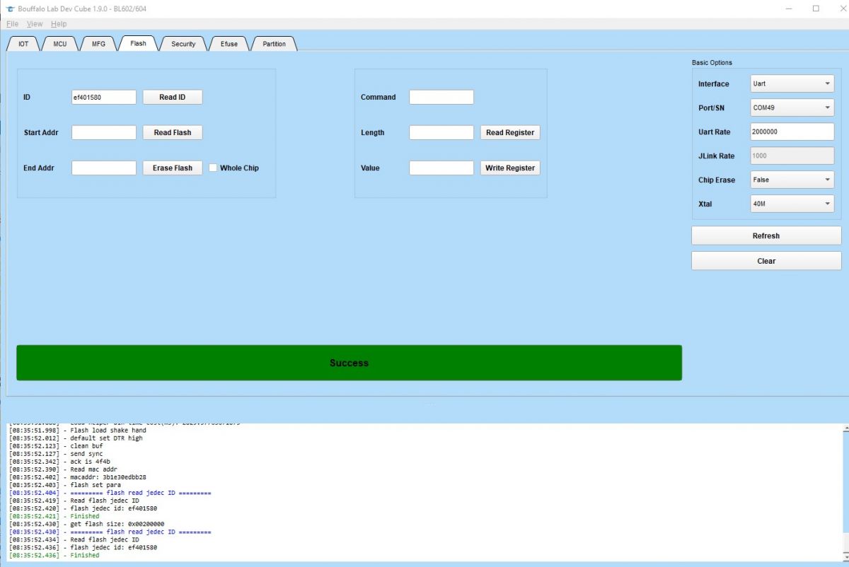

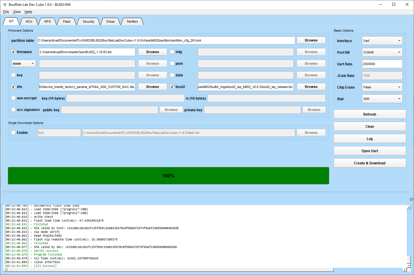

    Flash ID read
    Screenshot of Bouffalo Lab Dev Cube interface with the Flash tab open.
    Flash dump to file
    Screenshot of the Bouffalo Lab Dev Cube software interface for the BL602/604 module.

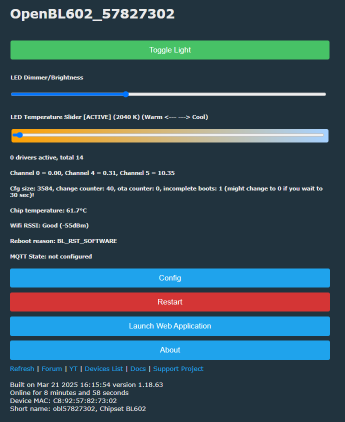

    OpenBL602 flash with custom mac in dts file
    Screenshot of Bouffalo Lab Dev Cube 1.9.0 software with a tab for flashing BL602/604 chips.
    P20 = warm white
    P21 = cold white
    and with all wires desoldered, donor fitting in place and OpenBL602 configured
    Sonoff B02-BL-A60 LED bulb lying on a tabletop. Illuminated LED bulb with visible diodes on the circuit board.
    OpenBL602 software interface with LED brightness and temperature adjustment slider.

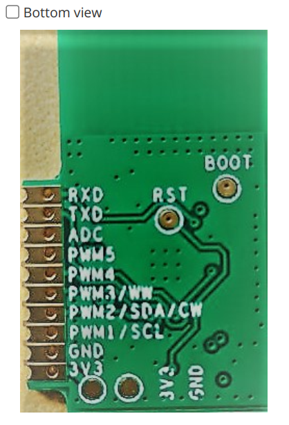

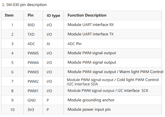

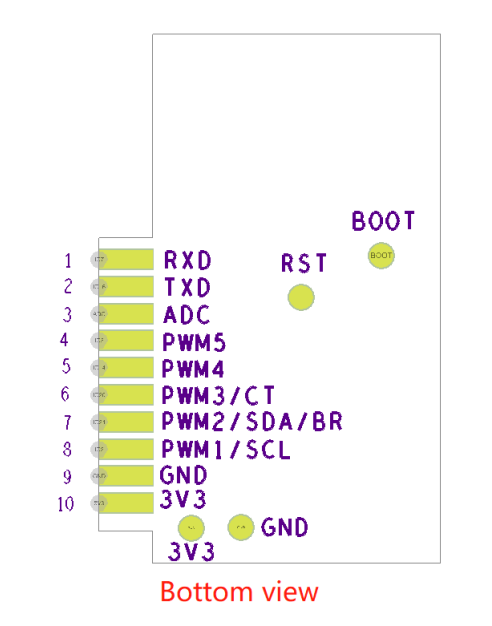

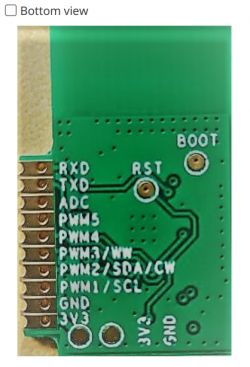

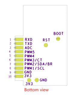

    SM-030 (developed and designed by Shenzhen kuzhai Technology Co., Ltd) module is an interesting form factor, the first of these I've had.
    https://fcc.report/FCC-ID/2A2SV-SM-030
    Technical drawing of the bottom view of an electronic connector with pin labels RXD, TXD, ADC, PWM5, PWM4, PWM3/CT, PWM2/SDA/BR, PWM1/SCL, GND, and 3V3.
    Each edge pad is the same both sides, making soldering choices easier.
    Diagram of SM-030 module pin functions.
    Bottom view of a circuit board with connection labels SM-030 electronic module with visible components.
    PWM control is courtesy of the Bright Power (BP Semi) BP5772 - a highly integrated dual-channel PWM dimming LED linear constant current driver chip
    Diagram of BP5772 chip with pin labels.

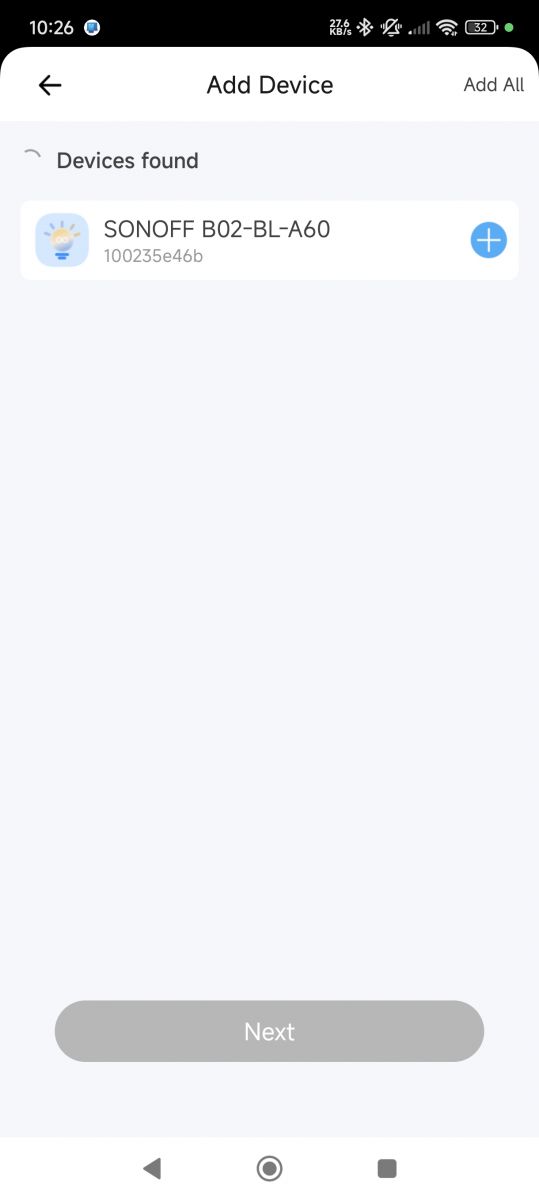

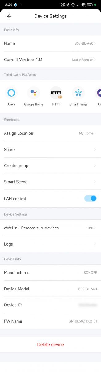

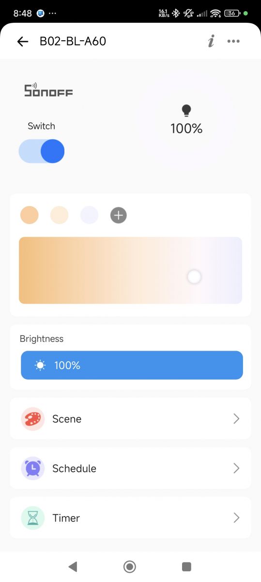

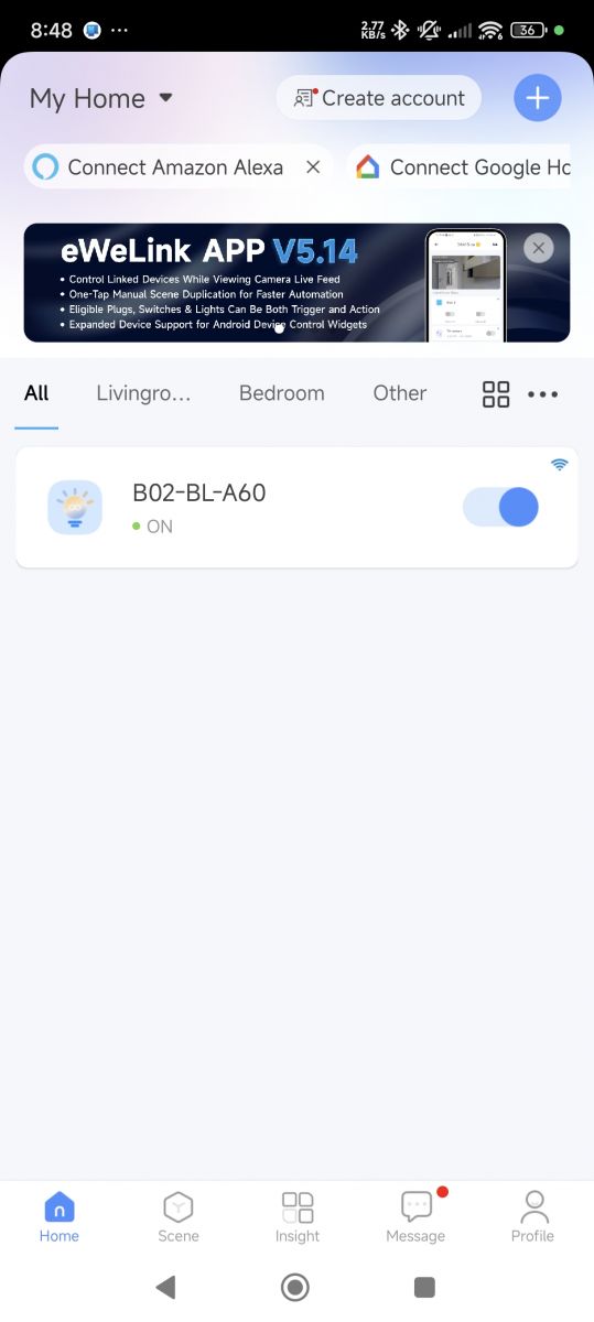

    eWeLink app paired visuals. No firmware update offered
    App screen with detected Sonoff B02-BL-A60 bulb. eWeLink app with connected Sonoff B02-BL-A60 bulb Interface of the app controlling the Sonoff B02-BL-A60 LED bulb on a smartphone, showing brightness and light temperature settings. Device settings for Sonoff B02-BL-A60 bulb on a smartphone screen.
    8X2-A60-WIFI-CW-BP-G1
    TP230-9-A60-WIFI-CW-G2

    You should use one of these and tilt it left and right to remove the bottom screw and it should pop off easily
    E27 bulb adapter with plug and switch.
  • #3 21490576
    Posts: 5236
    Help: 450
    Rate: 920
    Good thinking. I have similar actually but I don't know why I haven't made use of them for this purpose. 🤷‍♂️

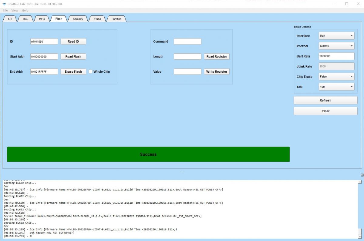

    Hi, I was trying to do the same flash procedure to my own Sonoff B02-BL-A60 bulb with the procedure as seen both here and in B05-made video by Elektroda.
    After some issues with temperamental flashing, I eventually succeeded in flashing the chip, but I couldn't get it to boot - it would seem to boot just enough to bring up the access point and even connect to it, but not enough to bring up the webUI to configure it.
    For the record, I lacked a reasonable power supply so I just used an ESP-32 to supply the UART adapter and the chip with stable-ish 3.3v(my meter showed 3.2v, but I'm not sure I trust it to be accurate). Everything else I connected as per the diagram seen in the B05 flashing video.
    Attaching a full boot log I've pulled from reading the UART when using dev cube. What seems to catch my attention that it crashed, and the last message was that 'romfs magic is NOT correct'. Anyone ever run into this and know how to fix it?
    Full log:

    has been seen even on the boot log of factory firmware so I wouldn't worry about this.
    BL602 is notoriously fussy with power so it's more likely to be that. does it crash and stop though or does it boot loop? Have you tried it soldered back in and on mains power in a safe way?
  • Stable 3.3 V supply fixed BL602 flashing
    #6 21503004
    aurismat
    >>21503004
    Update on my situation: seems like @divadiow was correct - all it was just the BL602 being pissy about it's 3.3v line. Upon getting a more 'normal' breadboard to set up the power and boot pins, not only it flashed first try but also brought up the AP without issue. Reassembling the bulb as we speak, if all works well I'll reassemble it with some thermal glue I've got today along with proper power supplying.
    To those who read this in the future - have a solid power supply that can provide stable 3.3v! ;)
    Anyway, thanks for your help.
