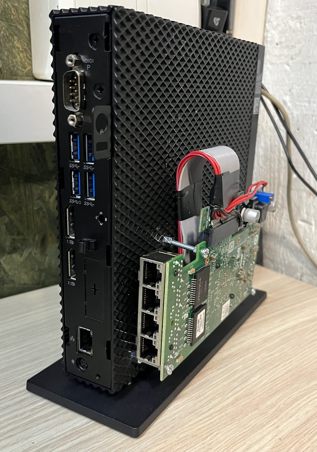

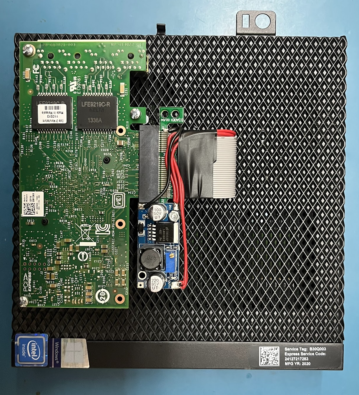

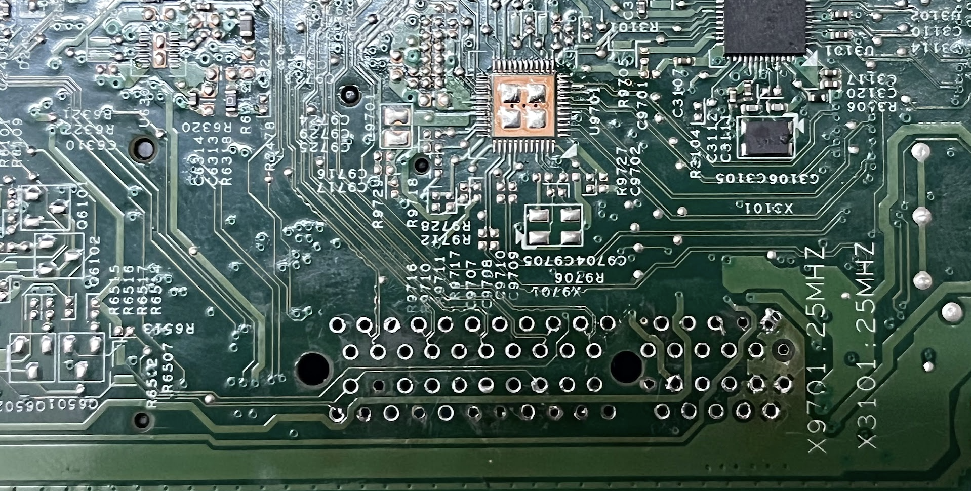

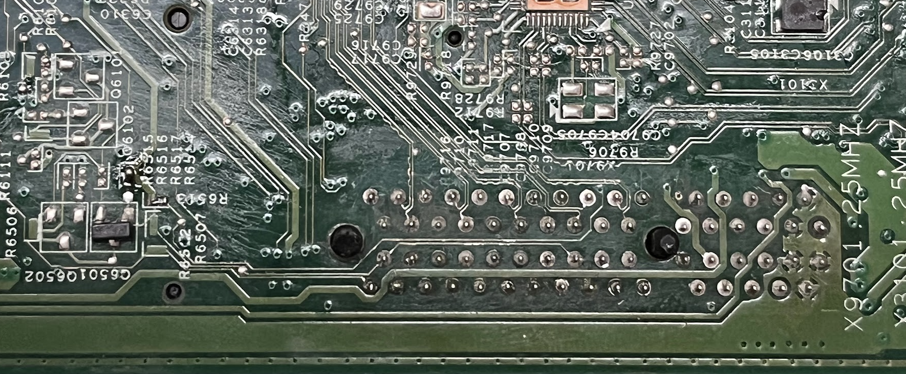

    #33 21930300
    dimitarmk
    Apologies for reviving an old thread – I carried out this modification using the guide on GitHub and the posts on Elektroda.pl. The hardest part was cleaning the lead-free solder from the through-holes on the PCBA. I used a basic soldering iron (without temperature control), a manual desoldering pump and a lot of leaded solder. I did end up damaging the solder mask in a few places, exposing the tracks, but luckily there were no short circuits. The donor for the 2N7002 MOSFET, the 2.2 k and 10 k resistors was an old GT210 graphics card.
    I modified a PCIe x4 riser cable by installing a step-down buck converter to reduce the 19 V present on pins B1/B2/B3/A2/A3 of the PCIe slot to the standard 12 V required, and installed an Intel i350-T4 quad gigabit network card (pins 5 and 6 of this network card must be covered with masking tape). Everything works as expected.

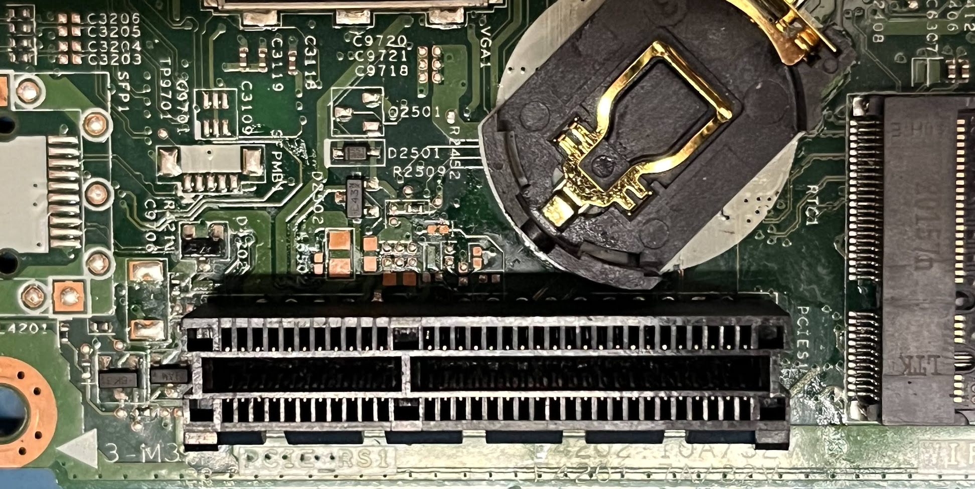

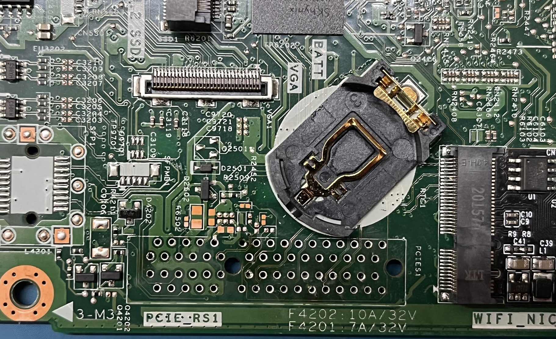

  • Missing PCIe coupling capacitors block link training
    #34 21942273
    Pikappa
    Hi.
    I’ve recently bought two stripped-down and dirt-cheap WYSES5070s for tinkering.
    I’ve almost finished my research and am going to make the necessary modifications now, but a few things have occurred to me:
    1) The slim version is, well, slim. After soldering the connector, there isn’t enough room to even fit a 32 mm high NVMe card, so it’ll have to be an open case, a custom case or some sort of riser. I’m planning to fit an HBA in there, so I’ll be using a ribbon riser. So why not skip the hardest part – removing the solder from the connector – and solder the wires directly to the motherboard?
    2) I’ve found out that most simple cards don’t need 12 V at all. You can simply leave the 19 V unconnected for safety and proceed without a PSU mod or buck mod. Cards that worked for me this way:
    1 Gbps RTL8111E NIC (AliExpress brand),
    2.5 Gbps RTL8125 NIC (AliExpress brand),
    Two different PCIe → M.2 NVMe cards, AliExpress brand
    Adaptec ASC-1405 HBA
    3) The motherboard itself does not have coupling capacitors on the TX lanes; these are supposed to be on the riser. Without those capacitors, the following cards do not work; the PCIe link remains in ‘target 2.5 GT x1, training’ mode and the cards are not recognised by either the BIOS or the OS.
    Adaptec ASC-1405 HBA, LSI2308 clone HBA, GTX460, R9270x (GPUs just for testing purposes; I’m not gaming on this ;)
    Adding the missing capacitors solved the problem with the Adaptec; it now links correctly at 2.5 GT x4. I’ll test the other cards once I’ve made a proper riser.
