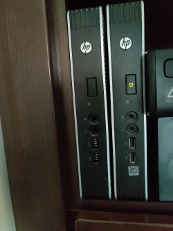

  • HP T610 slim needs less modification for NAS build
    #23 20947866
    speedy9
    Helpful for users
    Posts: 12035
    Help: 1233
    Rate: 2424

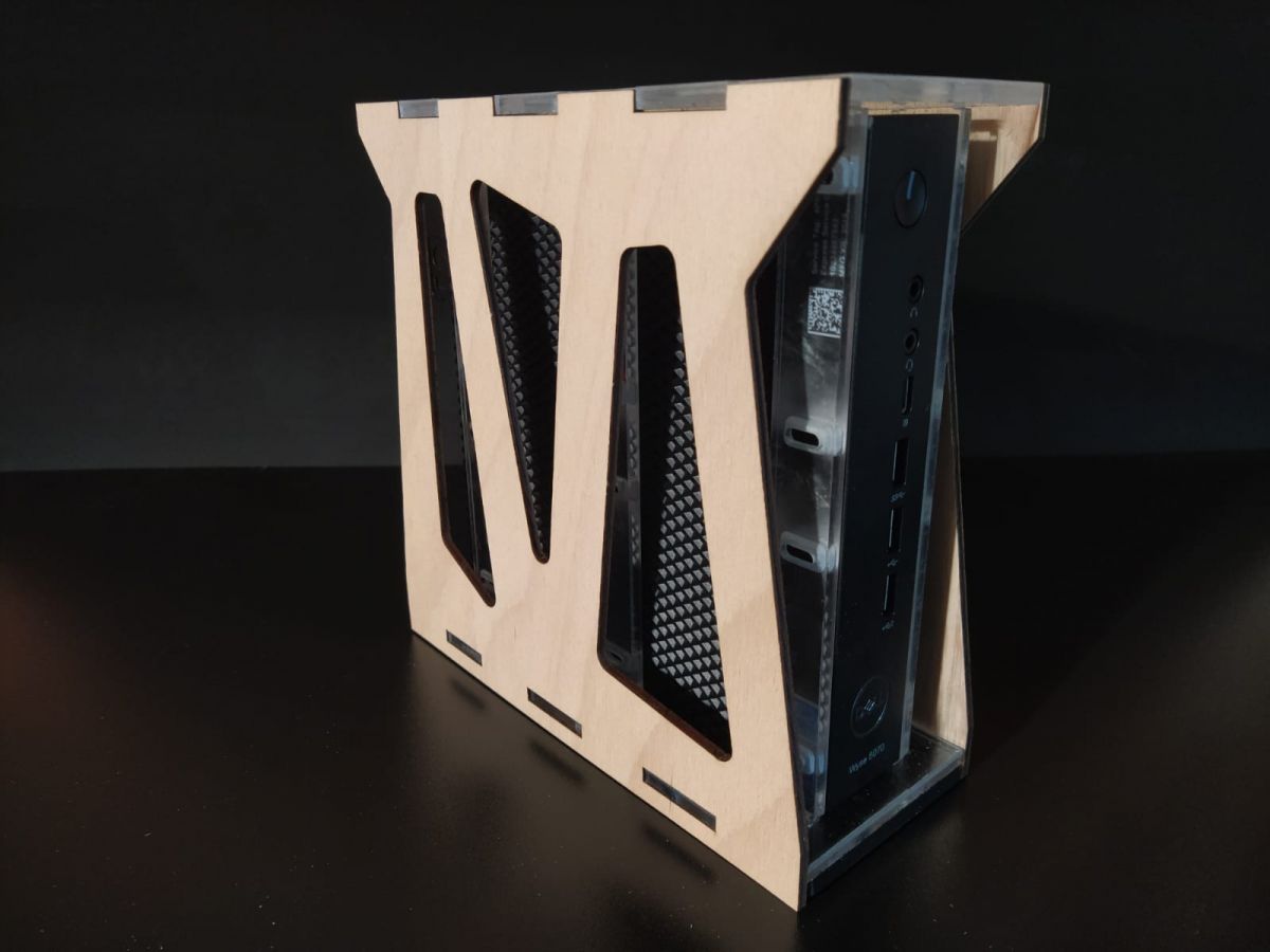

    The HP T610 SLIM version probably requires less modding. Below you have a photo of my NAS built from one terminal + a housing for such a terminal. The housings are fastened together with Velcro and can be separated. There is a PCIEe -> 6xSATA adapter inside. Currently, the second housing contains 5 SATA 2.5 1TB drives (I had these lying around). One more disk will fit in the case with the motherboard. I don`t remember if it was also in this additional one. The most fun was cramming it all into this additional housing.
    Two HP T610 terminals placed side by side on a wooden shelf, with front panels featuring ports.
    PCIe to 6x SATA adapter, model SU-SA3026. PCIEe adapter with ribbon cable and blue ends.
    The disadvantage of this HP is undoubtedly its weaker processor.

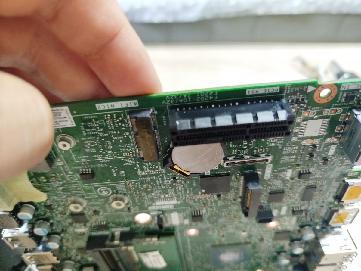

  • No 12 V rail found on motherboard
    #25 21203333
    aleksandarkomadina

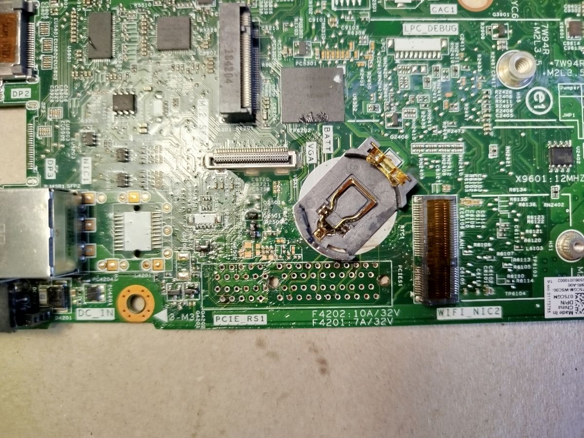

    Hi.. just to give some report about this mod..
    I followed Chinese Website guide ( I was unable to open all files but I figured out what is needed to be soldered on motherboard)
    I did modification but without success about stepping down voltage.. everything is placed as explained and Maschine boots.
    2 resistors and one relay .. but voltage on PCI slot is still 20 v ( adapter is 20 v)
    It gave me idea to pull out PCI pins that conduct power and add ,,voltage step Buck '' in between to lower voltage to 12 v. (But I believe that this will take a lot of time )
    I also have to report that I found none of points, that shows me 12 v on voltmeter
    So I am not sure if that voltage even exists on this slim motherboard because none of components use 12 v to operate. Voltage on board is mostly about 1.4v 3.3v; 5.1v
    Maybe something else is needed to be added on board but as I said I was not able to open all files.
    Motherboard with PCI slot and soldered components. Close-up of a motherboard with electronic components and a battery holder.
  • No 12 V found on the PCIe slot pins
    #26 21309871
    mosao
    aleksandarkomadina wrote:
    This gave me the idea to take out the PCI pins that carry power and add a ,,voltage step buck'' between them to bring the voltage down to 12 volts. (But I think that would take a lot of time).
    I must also report that I have not found any of the points that show me 12 volts on the voltmeter
    Earlier in the thread the measurements were taken on a 12 volt power supply. Have you checked on such a power supply?
    On the original "frame" there are probably just voltage converters to 12 V and in the extended version you plug the card into the "frame", not into the slot directly.

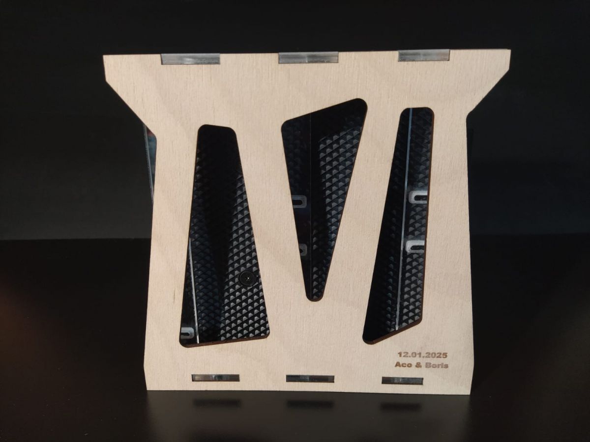

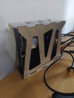

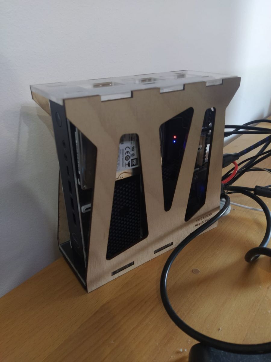

    #29 21428495
    aleksandarkomadina
    Hi .. sadly still haven't tested because I plan to make a clean setup. SMD components are soldered on the board but pci-e never tested since I never purchased a 12v charger. Setup currently using USB to sata setup and looks like this.
    when I upgrade to pci-e I will definitely post here
    Wooden case with electronic components mounted inside.
    Wooden stand with cutouts on a black background.
    Wooden computer case with visible USB ports and power button on the front.
    Homemade computer case with components mounted on a desk.

4. Which ready-made board adds PCIe safely?
Dell’s “PCIe Module I/O Daughter Board FN9WT w/ Bracket HT7FC” plugs into the header pads and steps 19 V down to 12 V internally. Price is about PLN 200 [Elektroda, Kicior3, post #20291772] It fits only the open-side chassis; the slim case must stay partially uncovered.
5. What voltages appear on the slot after a 12 V mod?
Measurements show 12 V on pins A2, B2, B3; 5 V on A7 and A8; 3.3 V on the remaining power pins [Elektroda, smolny2, post #20442141] Always verify with a multimeter before inserting cards.
6. How many SATA drives can I add through the Wi-Fi (A+E) slot?
A passive M.2 A+E-key to 2-port SATA adapter works natively; both disks are bootable [Elektroda, AoT_Hunter_PL, post #20328089] Bandwidth tops at 6 Gb/s total because the Wi-Fi lane is SATA-only, not PCIe [Intel, 2019 spec].
7. I need four or more drives—what are my options?
  1. Solder PCIe and use a x1→4 or x1→6 SATA HBA (up to 1 GB/s shared).
  2. Buy the FN9WT daughterboard, then plug a PCIe x4 HBA.
  3. Use a USB-3.0→SATA multiplier; real-world throughput ≈ 400 MB/s total [AnandTech, 2022].
8. Will a 2.5 GbE NIC work in the new PCIe slot?
Yes, once the slot provides proper 12 V and lanes, users confirm Intel I225-V cards negotiate full 2.5 Gbps [KCORES, 2023]. Ensure driver support in your OS.
9. What’s an example failure scenario I should avoid?
Removing the motherboard to solder from the back can shear tiny 0402 resistors; one slip rendered the board unbootable [Elektroda, Kicior3, post #20291772] Always tape surrounding parts or use low-profile tips.
10. How can I test slot voltages safely?
How-To:
  1. Connect a 12 V PSU and DS2501 cable.
  2. Power on, then probe PCIe pads with needle probes, ground on chassis.
  3. Verify 12 V ≤ 12.3 V, 5 V ≤ 5.2 V, 3.3 V ≤ 3.4 V. If higher, cut power immediately.
12. Are there bandwidth bottlenecks after the mod?
The onboard SoC offers one PCIe 2.0 ×4 root complex. Soldered header gives only ×1; expect peak 500 MB/s. Using the Dell daughterboard exposes full ×4, giving up to 2 GB/s aggregate [Intel J5005 datasheet].
