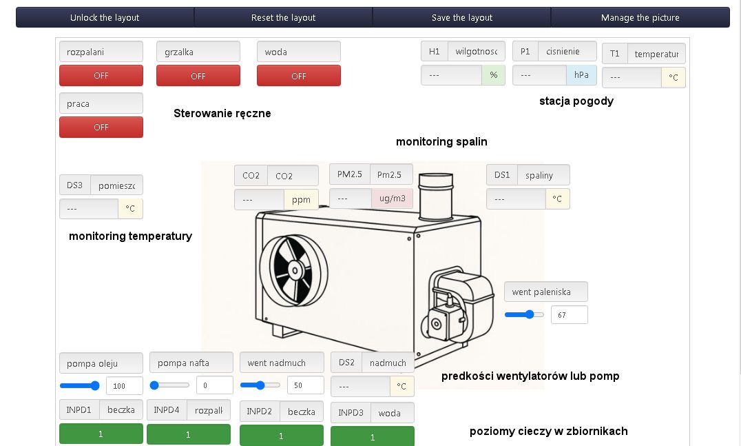

  • Remote controller for waste-oil furnace automation
    #35 21740382
    stani^c
    Posts: 67
    I will add my 5 gr to the topic.... Times are changing and IOs have hit the dill too.
    Diagram of blower furnace system with oil tank, filter, and remote control setup Control panel for remote furnace operation with sensors and status indicators Furnace controller interface with icons, ON/OFF buttons, and system parameters display
    If anyone would be interested in a cooker controller managed from anywhere with internet access,
    then in addition to remote firing of the furnace for used oil (with glow plug optionally injection system), control the operation of the fuel and water feed pumps and control the speed of the fans manually or automatically, or send an SMS about the end of the oil in the tank and whatever else you want :)
    It is possible to fire up the cooker at a chosen time and maintain the set temperature, working with the thermostat option.
    You can also go further and monitor the flue gas values (temp, CO₂, dust, NOx, NH₃, H₂S) in real time - just why :) overpay....
    The controller supports:
    - dS temp sensors x8 pcs.
    - digital INPD e.g. liquid level x4 pcs.
    - analogue INPA sensors x6 pcs.
    - pWM speed control x4 pcs 12 V DC or 230 V AC voltage
    - relay control x6 pcs.
    - outdoor weather station T1 P1 H1
    - built-in time clock x40 records
    - built-in programmer of complex events x20 records
    - sMS notification and control option - SMS modem
    - remote configuration and user support option
    - universal suitable for any class of cooker
    If you are interested, please visit https://pompkioleju.sweb.pl#sw or call 887-872-857
