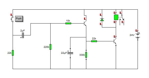

How can I detect pulses from a YF-B10 water flow sensor and use them to switch a relay for a shower extractor fan?
Use pulse/edge detection rather than a simple steady high/low detector, because this kind of flow sensor can stay in a fixed state after flow stops [#20240124][#20240176] A simple solution is an Arduino Nano: connect the sensor to an external interrupt input (pins 2 or 3), count pulses in an interrupt routine, and drive the relay from another pin through a transistor [#20240190] An example Arduino wiring was also given as sensor on pin 2 and relay on pin 4, with example code available for the YF-B10 [#20240402] If you want a ready-made hardware approach instead of coding, there are flow-sensor relay modules on the market [#20240573] Another suggested low-cost hack was to adapt a cheap thermostat board by replacing the thermistor with the flow sensor and choosing the capacitor value to set the trigger threshold [#20249207][#20249619]

    ramzesq wrote:
    I super:) Plate 17pln and minor alterations. Thanks:)
    Sometimes you have to think outside the box :) Describe later how it works for you and whether it started from the shoot :)

    And here's a circuit that will also work: YF-B10 water flow sensor - simple rectangular waveform detector .
    I don't know what the pulse frequency will be, so it's possible you'll have to select capacitor values.
