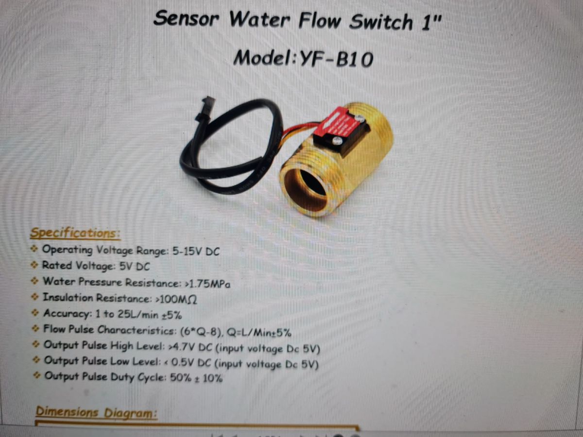

    I have purchased a flow sensor for hot water detection in the shower (YF-B10), to trigger the air extractor when bathing. Unfortunately, I can't find any sensible finished PCB for detecting the TTL rectangular waveform from the Hola sensor. There are circuits on Arduino, but here it's a simple "is" or "isn't" signal and activation of a relay. Suggestions welcome.

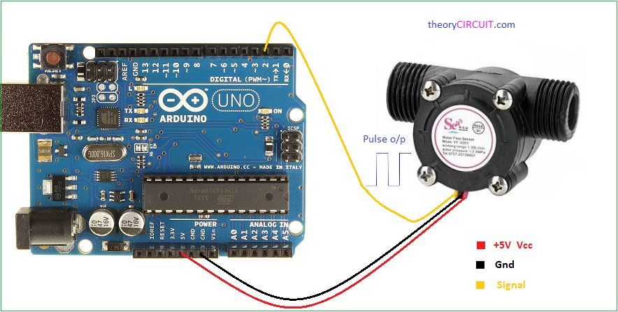

    And the specific solution is Arduino?
    E.g. this :
    YF-B10 water flow sensor - simple rectangular waveform detector .
    Just a question of where to connect the relay that will react to the edge and its absence.

    An Arduino Nano will do. The external interrupt on the Nano is handled on pins 2 and 3. And you drive the relay from any selected pin via a transistor - which one? This is something you will have to choose depending on the relay.
    Here is the documentation: https://www.arduino.cc/reference/en/language/functions/external-interrupts/attachinterrupt/
    Take a look at the example code.

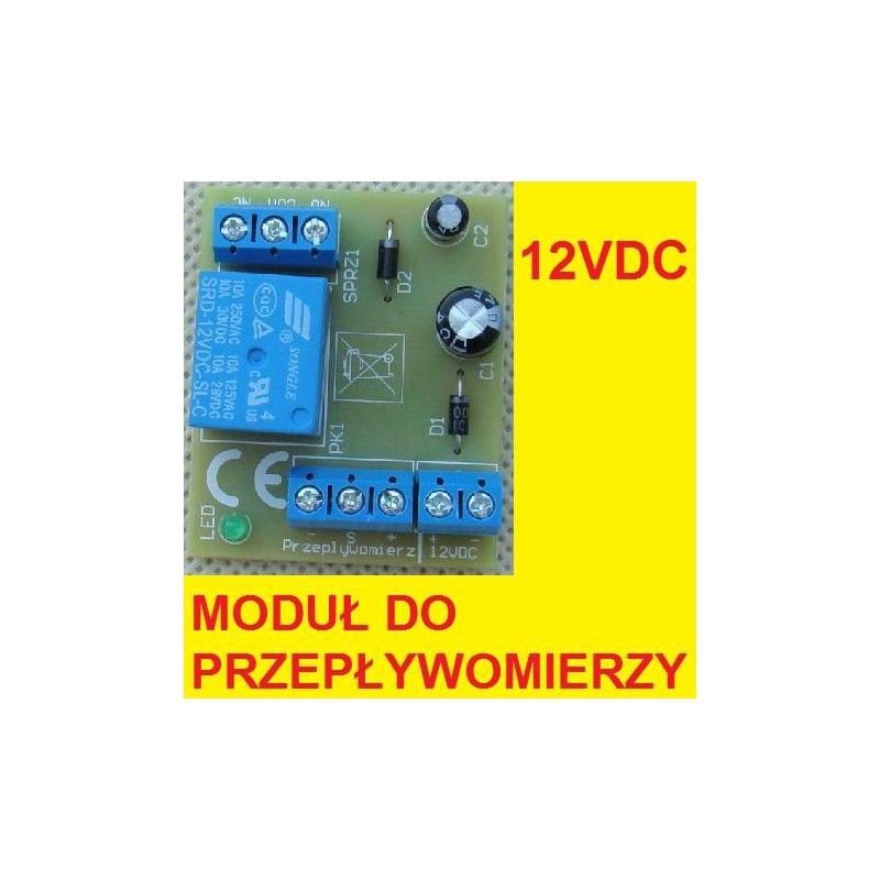

    Does anyone have any idea what the circuit diagram for this board looks like?

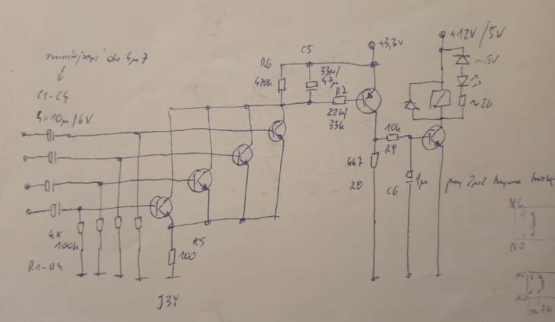

    A long time ago I made such simple detectors for a flashing Led (four separate channels). With some minor adjustments you can use. YF-B10 water flow sensor - simple rectangular waveform detector .
    PS:I hope I have understood the problem correctly. If not, apologies ;) .

    How to draw the diagram as the other side is not visible in the photo.

    And here is the buried dog :) But I think it's no problem for an electronics engineer, because it's only 3 diodes, a relay and 2 capacitors.

    But I think it's no problem for an electronics engineer, as it's only 3 diodes, a relay and 2 capacitors
    But there are certainly other components on the other side (as otherwise this module was not that expensive).

    There are certainly no other components on the other side, because with such a small board it is a misunderstanding to design the circuit and assemble the components by two different methods, i.e. traditional and SMD.

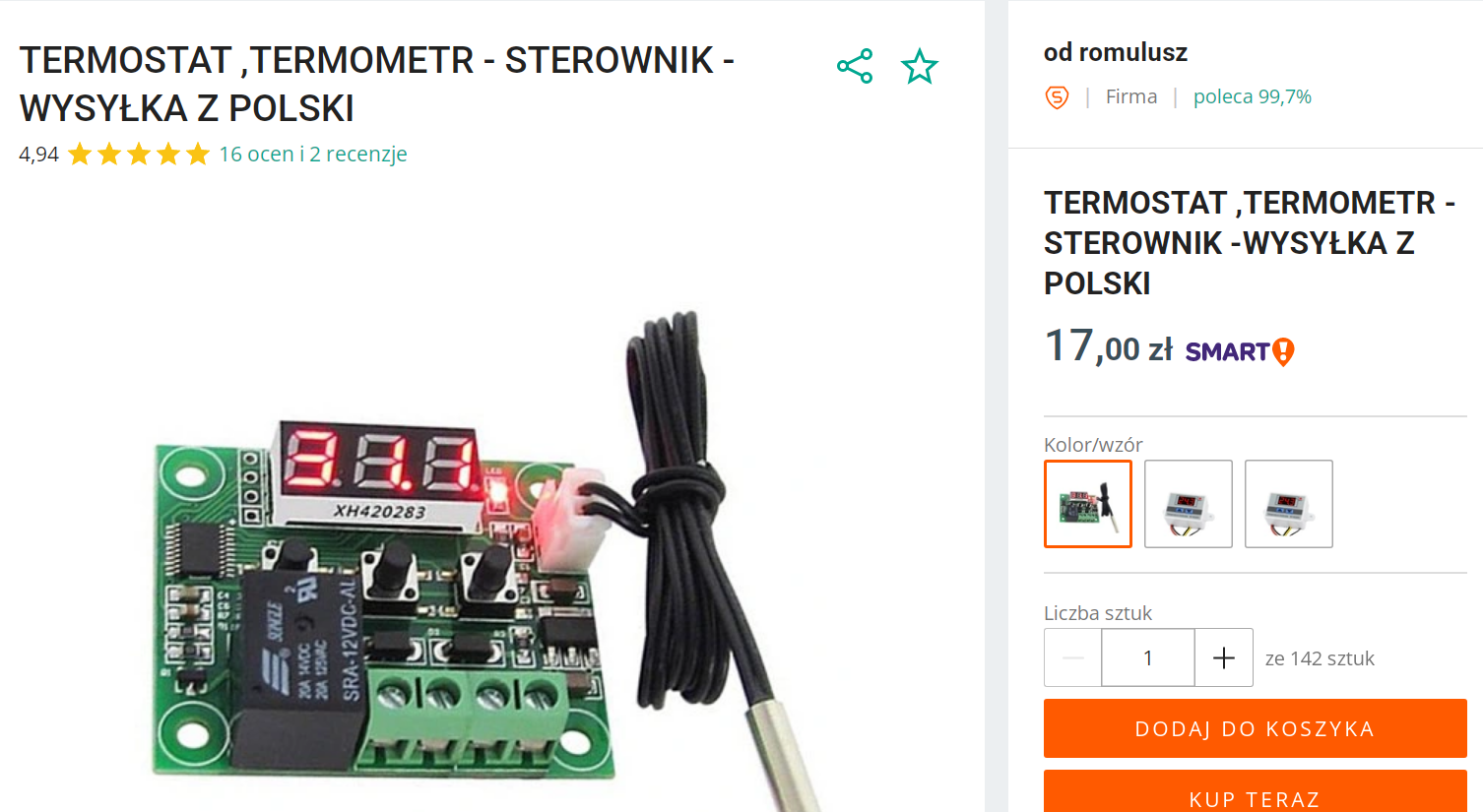

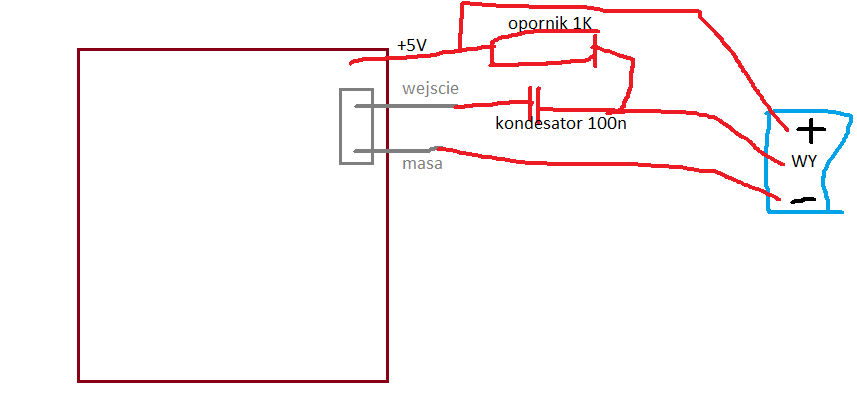

    I think the simplest would be something like this
    it has a processor, it has a relay, only you have to connect a flow sensor instead of a temp sensor (thermistor) so
    You need to look for 5V on the board and connect the resistor and the sensor there as I have drawn, the capacitor needs to be chosen, but first you need to try it out, the sensor will average out the voltage on the input and the thermostat will show some temperature, if it is too high, you need to give a bigger capacitor, then you need to set the temperature threshold a little lower or higher depending on what you want it to do.

    I super:) Plate 17 PLN and minor modifications. Thanks:) .
