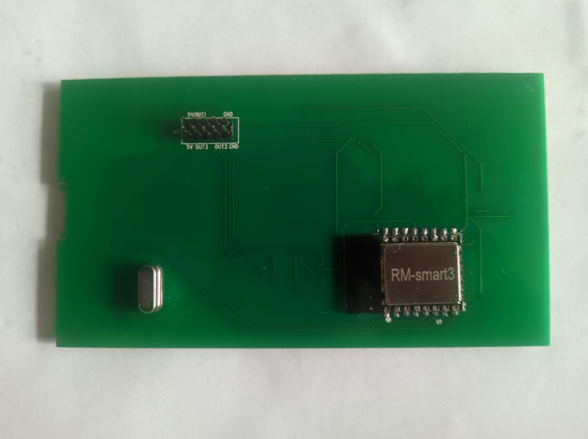

    I bought 2 x 3 Gang Smart Wifi RF433 Smart Switch from AliExpress a year ago. It used TW-03 chip, based on Winner Micro W600, I have to desolder to upload OpenBK7231 firmware.
    Uploading OpenBK7231 Firmware on TW-03/W600 3 Gang WiFi+RF433 Smart Switch: Tips & Tricks Uploading OpenBK7231 Firmware on TW-03/W600 3 Gang WiFi+RF433 Smart Switch: Tips & Tricks Uploading OpenBK7231 Firmware on TW-03/W600 3 Gang WiFi+RF433 Smart Switch: Tips & Tricks Uploading OpenBK7231 Firmware on TW-03/W600 3 Gang WiFi+RF433 Smart Switch: Tips & Tricks Uploading OpenBK7231 Firmware on TW-03/W600 3 Gang WiFi+RF433 Smart Switch: Tips & Tricks

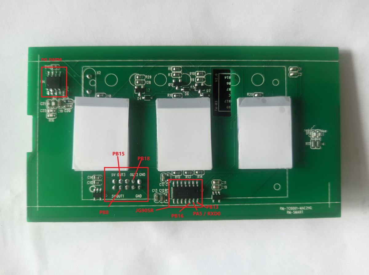

    I traced on PCB with multimeters to get some infos but still not enough
    JG905R: don't know what this is? Google has no info
    no name: still don't know?
    This is how I set up after uploading firmware:
    PB8: Relay1
    PB18: Relay2
    PB15: Relay3
    PB10: WifiLED 1 RED
    PB11: WifiLED_n 1 / BlueLED
    PB16: Button 1
    PA5: Button 2
    PB13: Button 3
    Switch runs ok with this config, but sometimes it hangs up when pushing Button 1 On then Off, sometimes it has ghost switch itself, automatic turn on and then turn off.
    Any ideas?
