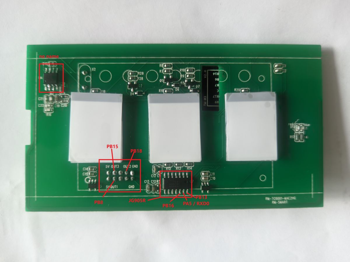

    I bought 2 x 3 Gang Smart Wifi RF433 Smart Switch from AliExpress a year ago. It used TW-03 chip, based on Winner Micro W600, I have to desolder to upload OpenBK7231 firmware.
    I traced on PCB with multimeters to get some info but still not enough
    JG905R: don't know what is this? Google has no info
    no name: still don't know?
    This is how I set up after uploading firmware:
    PB8: Relay1
    PB18: Relay2
    PB15: Relay3
    PB10: WifiLED 1 RED
    PB11: WifiLED_n 1 / BlueLED
    PB16: Button 1
    PA5: Button 2
    PB13: Button 3
    Switch runs ok with this config, but sometimes it hangs up when pushing Button 1 On then Off, sometimes it has ghost switch itself, automatic turn on and then turn off.
    Any ideas?

    Have you tried latest firmware version?

    W600 stability patch has been applied, please update your devices.

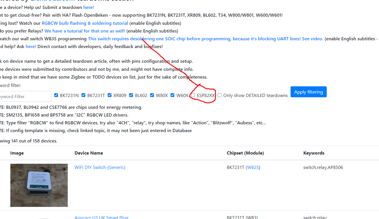

    I have one of these too that I bought more recently. It looks identical, but it has an ESP chip inside, so it's not relevant to this forum...

    Well, to be honest, our teardowns list includes ESP (but not by default):
    Troubleshooting TW-03/W600 3 Gang Smart Switch: Issues, Firmware & Configurations
