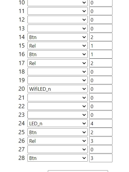

    I flashed it with the following software: BK7231GUIFlashTool
    Pins on the Bingoelec 3 Gang Standard Base are as follows:
    P10 - RX
    P11 - TX
    GND
    3.3V
    CEN (it didn't work for me, so I just did ON-OFF)
    Some pictures of me while I was flashing:
    Close-up of a circuit board with wiring and components. Close-up of the inner side of a Bingoelec touch switch with wires. Close-up of a Bingoelec touch switch circuit board with visible contacts and pin descriptions.
    I had to carefully remove one of the master plates in order to have access to P10 and P11
    I used the information from the link: LINK
      "vendor": "Tuya",
      "bDetailed": "0",
      "name": "Bingoelec DIY Series Smart WiFi Wall Touch Switch Base",
      "model": "DIY Series Smart WiFi Wall Touch Switch 3 gang",
      "chip": "T34 Tuya(BK7231N)",
      "board": "TW2-0003A",
      "flags": "1088",
      "keywords": [
        "Bingoelec",
    	"DAJIMEI",
    	"T34",
    	"TW2-0003A"
      "pins": {
        "14": "Btn;2",
        "15": "Rel;1",
        "16": "Btn;1",
        "17": "Rel;2",
        "20": "WifiLED_n;0",
        "24": "LED_n;4",
        "25": "Btn;2",
        "26": "Rel;3",
        "28": "Btn;3"
      "command": "",
      "image": "https://obrazki.elektroda.pl/1582514300_1695766732.jpg",
    Pin 24 has the ability to turn on or off the LED Backlight switch.
    I hope I saved someone time and trouble.
    PS: this is my first topic, so if there are any mistakes, I apologize, and I would ask the administrators to correct them. Thank you

    simovicsava
    Posts: 11
    I have no such problems, check the PIN settings and the channels they are on
