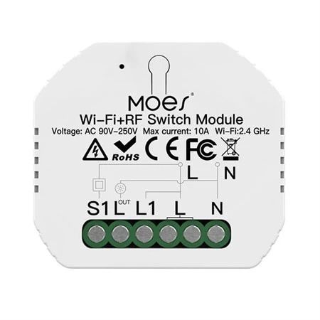

    I have two questions about OpenBeken.
    I have many Moes 1-gang WiFi + RF switches based on WB2S (BK7231T). I tried to flash three of them with BK7231GUIFlashTool using the firmware OpenBK7231T_UA_1.18.188.bin. The backup and erase processes completed successfully, but I got a BAD CRC error at the end of flashing. After that, the devices would not boot successfully, and strangely, the modules consumed only around 1 mA of current after the failed flash. Finally, I used BK Writer 1.6 on a fourth module with the same firmware, and it worked.
    When I assign pin 26 as button channel 1 and pin 6 as relay channel 1 on the module, pressing the button changes the relay state. However, I am not using a button; I am using a rocker switch. In short toggle operations, the relay position does not change. I want the relay to operate based on the input being 1 or 0, rather than on the rising or falling edge of the input. I want the outputs to operate as momentary, not latched. How should I configure this?
    Moes Wi-Fi+RF switch module with labeled connectors and white casing

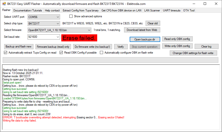

    v99 and v129 have an issue with my WB3S it seems
    Erase failed error displayed in BK7231 Easy UART Flasher software
    Error message Erase failed in BK7231 Easy UART Flasher application
    I'll have to build v93 to check it.
    there was a mishap recently: https://www.elektroda.com/rtvforum/topic4147427.html#21710357
    but I thought it was sorted
    Added after 3 [minutes]:
    i think v93 was the bad one. 3rd october

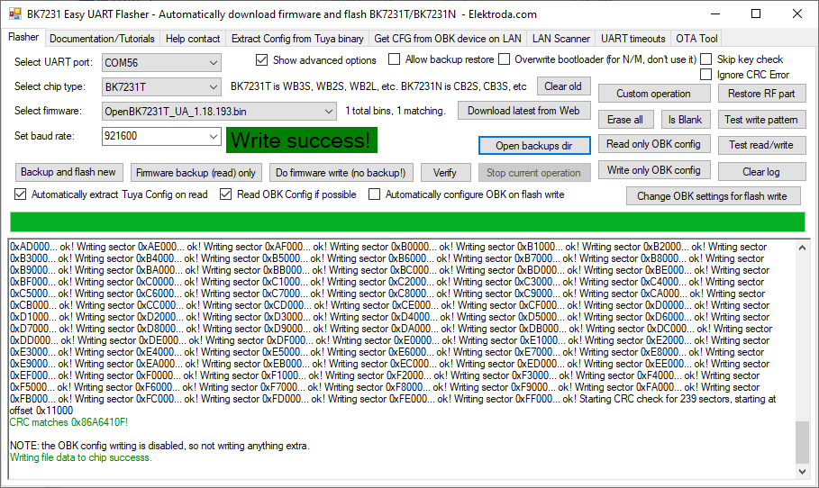

    v130
    BK7231 Easy UART Flasher interface showing Write success! message
