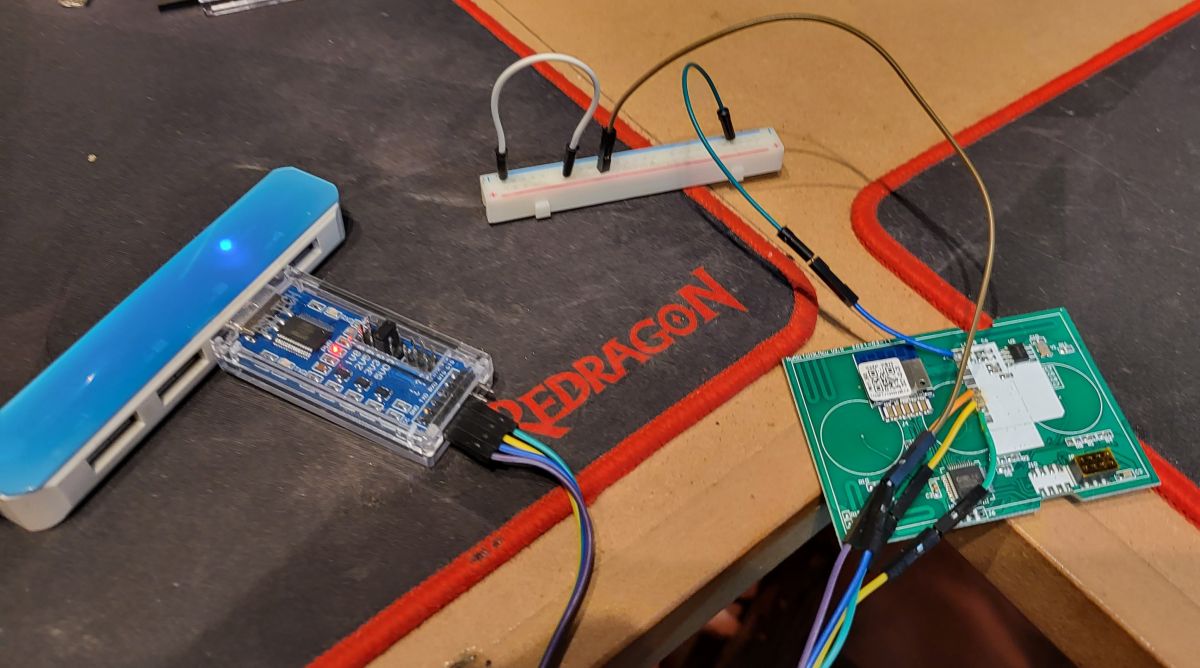

    Good morning all!
    I am new to this forum as I am very excited to get the OpenBK7231T_App up and running.
    I have been using Tasmota for a long time with various ESP based chips and love its stability and consistency and would love to do the same with the Tuya based switches I have.
    As mentioned in the subject above, I have many Moe's House WiFi RF433 Single Fire Switch (mine are the 3 gang version):
    [url=]https://www.amazon.ca/Generation-Single-Switch,No-Neutral-Compatible/dp/B08S2R6V6W[/url]
    I have traced the 4 lines to on the WB2S controller to jumpers on the PCB and soldered wires accordingly:
    [BK7231T - WB2S] Moe's House WiFi+RF433 Single Fire Switch Getting Bus Failed
    In trying to use the BK7231 GUI Flash Tool 1.0.5 I continuously get the Getting Bus Failed message until it times out after 100 tries.
    The interesting thing is that through MANY attempts I did get the 'Getting Bus Success!' msg to then only have it tell me that I couldn't set the baud rate to 921600 ... which happened twice.
    I have tried alternate baud rates, I have tried connecting the UART first then opening the flashing tool (and various variations on this as well).
    You will notice in the image that I have placed the ground wire across a small breadboard to easily cycle the power on the device when it is time to reboot.
    I was wondering if anyone here may have had success with this particular Moe's House switch and if anyone could provide some advice.
    Thank you very much for all your hard work and I look forward to using this new firmware!

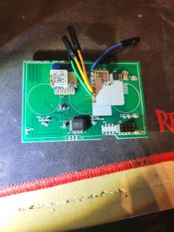

    Hello, can you post better photos of the board?
    Have you tried bkWriter 1.60, just to be sure that's not the fault of the relatively new tool?
    https://github.com/openshwprojects/OpenBK7231T/blob/master/bk_writer1.60.zip
    Are you aware that some devices might be using TX or RX for another purpose, like for a button, and sometimes it might be needed to temporarily cut the trace, like in one of our Elektroda videos:

    Here is a closer image of the board and I have moved the soldered wires to get a better view:
    I have also tried the bkWriter 1.60 with no luck...
    You may be correct about the TX and RX being used otherwise as all I did was use a continuity meter to locate the leads on the (seemingly) unused solder pads (as you can see where I soldered). The other difficulty is that the SOIC is laid flat on the PCB so the lower pins are difficult to access.

    I can clearly see that your device is a TuyaMCU device where 1RX and 1TX is used to communicate with external MCU in TQFP case.
    There are multiple options to do from here:
    a) cut the traces and reconstruct them after flashing
    b) desolder WB2S, flash, solder back
    c) desolder chip in TQFP....
    d) find datasheet of TQFP mcu chip and see if it can be put in RESET mode - maybe one of the pins is RESET?
    e) check second side of the board, maybe there is a resistor on each RX/TX line...
    I don't have any more ideas. You will also need to do TuyaMCU configuration for that switch after flashing, but we already support TuyaMCU so we will figure it out

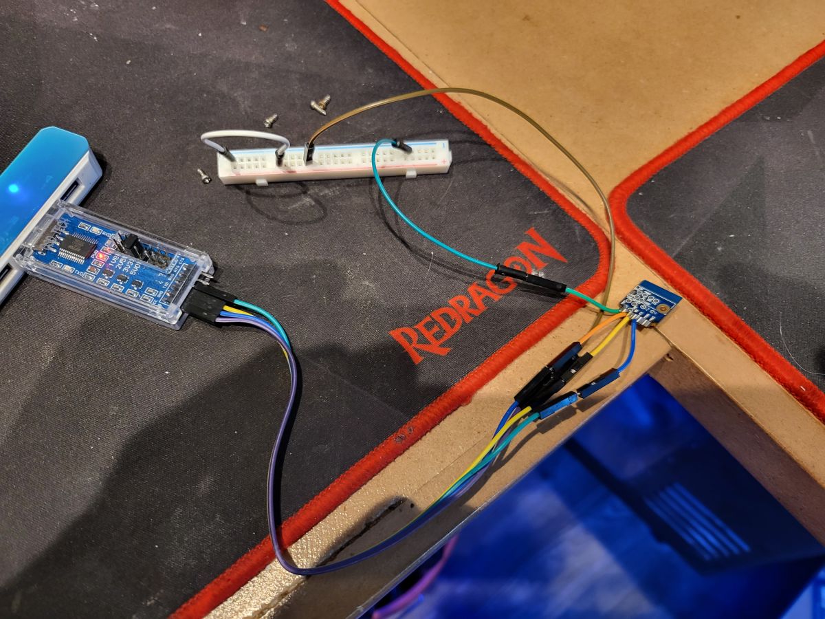

    I just wanted to let you know that I got at least the first step working!
    WOOHOO!!
    I ended up trying to remove the WB2S from the PCB using a soldering iron and I ended up ripping 3 of the pads off the bottom :(
    .. perhaps I can attempt to fix that later ... damn it!
    Sooo... I took a second Moe's House switch (as I have several) and used a heat gun this time and it just fell off the PCB.
    I soldered the wires directly to it and it flashed without issue.
    It took a few times to get it to connect to the network here .. Is the SSID case sensitive?
    But.. it is now done!
    Next is to re-solder it to the PCB and then figure out the template.

    Which pads have been damaged? It should be possible to reroute workings pads to the required signals.
  • #9 20451803
    ocean55
    I pulled off the VBAT and TX and RX pads...
    However, it appears that I have somewhat reattached the VBAT pad.
