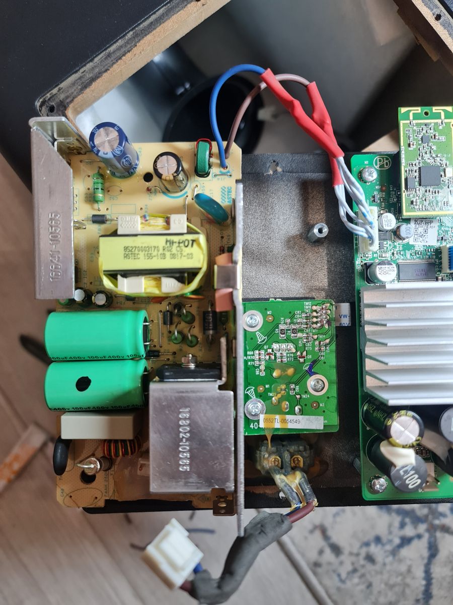

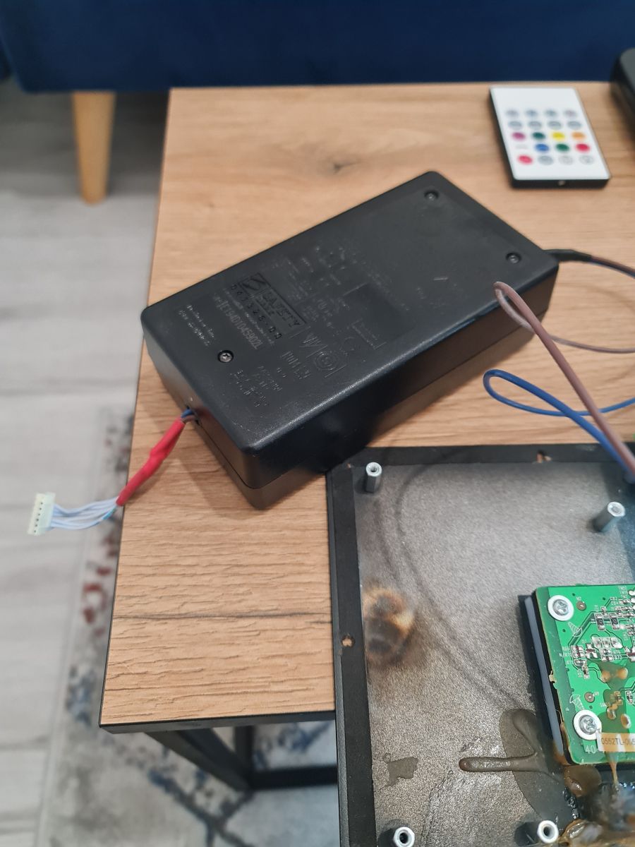

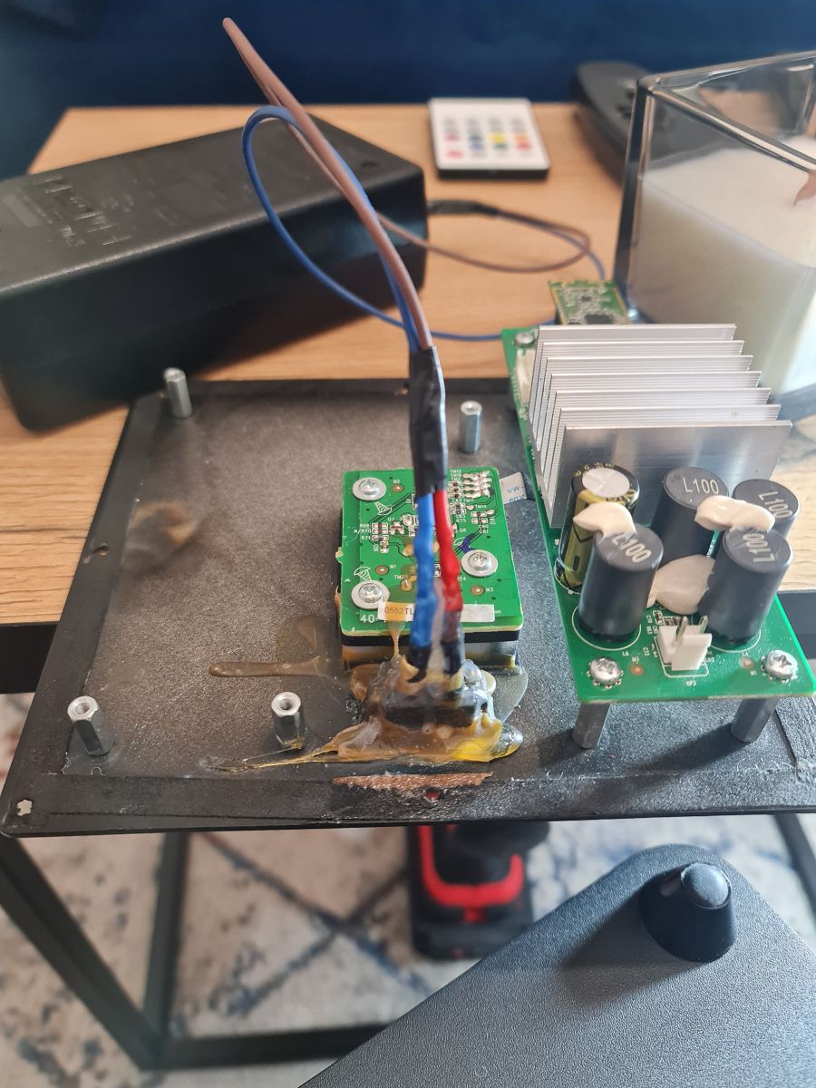

    @oldking thank you for bringing up the thread and in particular the subject of the replacement power supply. Thanks to you, the equipment works (I bought the JBL set used, the power supply cracked 3 days later, burnout as above in the photos, repair cost PLN 300 without warranty)
    Continuing the thread for those interested in "taking shortcuts"

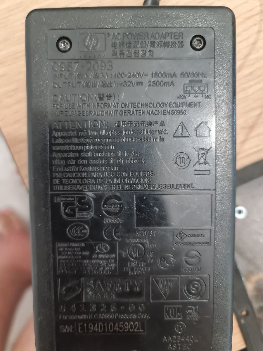

    The sub, according to the info on the back, consumes max 60W, so I decided on the HP 2500mA 32V power supply, tested for a few days, it barely heats up, so far it's ok (I bought it from a guy from olx for PLN 15)
    Installation for now on ordinary cubes / strip without the last pin (presumably standby).
    You can probably pull it out (or not) and put it inside the sub and use the existing 230V socket. For me, aesthetics, I leave it outside.

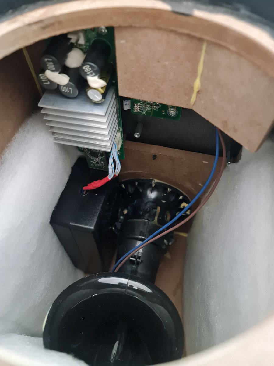

    Why do you think the power supply was left outside? It fit easily inside.

    It was "in one word" that you changed the parameters of the loudspeaker chamber. In addition, you created a fire hazard, because the power supply used has not been tested and adapted to such a building. A veritable lottery, and then tragedy strikes. And yet your costs, as you indicated, are comparable to the repair of the original power supply.
    Sometimes speed shouldn't be a priority . ;)

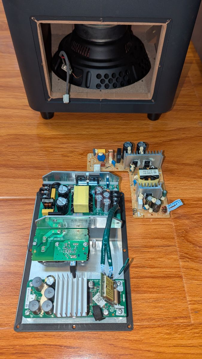

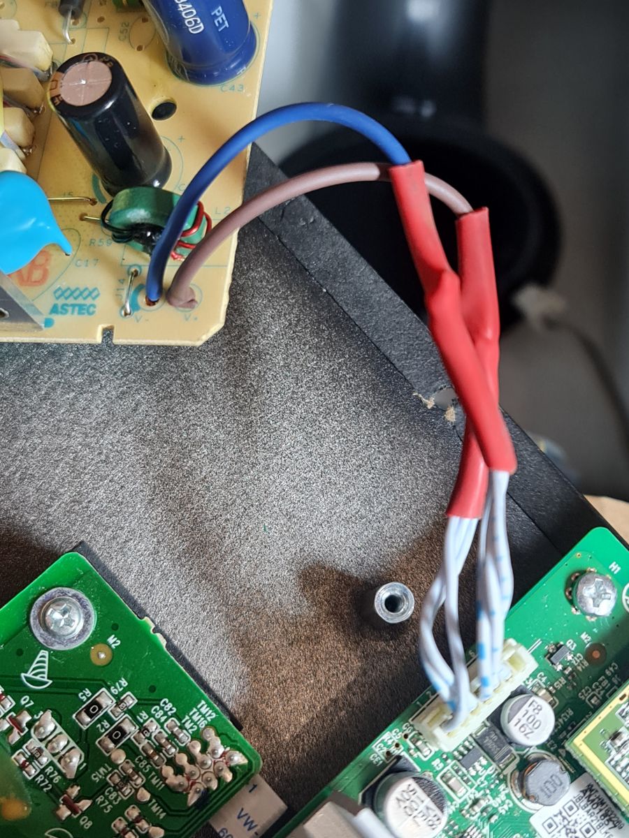

    Hello guys, I'm just joining the topic. I have the same problem - the power supply burned out in the middle of the new year 2024 hahahahaha. Reading the topic, I see that it was possible to make it work by connecting an external power supply that works and complies for it to work correctly. However, could someone share photos of how that connection should be made? Someone out there explained, but I can't understand...

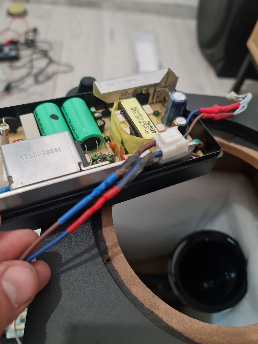

  • HP printer 32 V supply used as replacement
    #48 21051530
    worsior

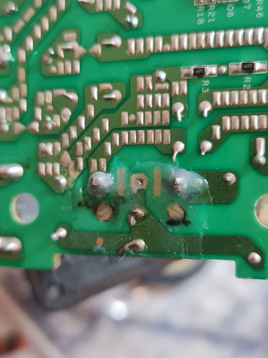

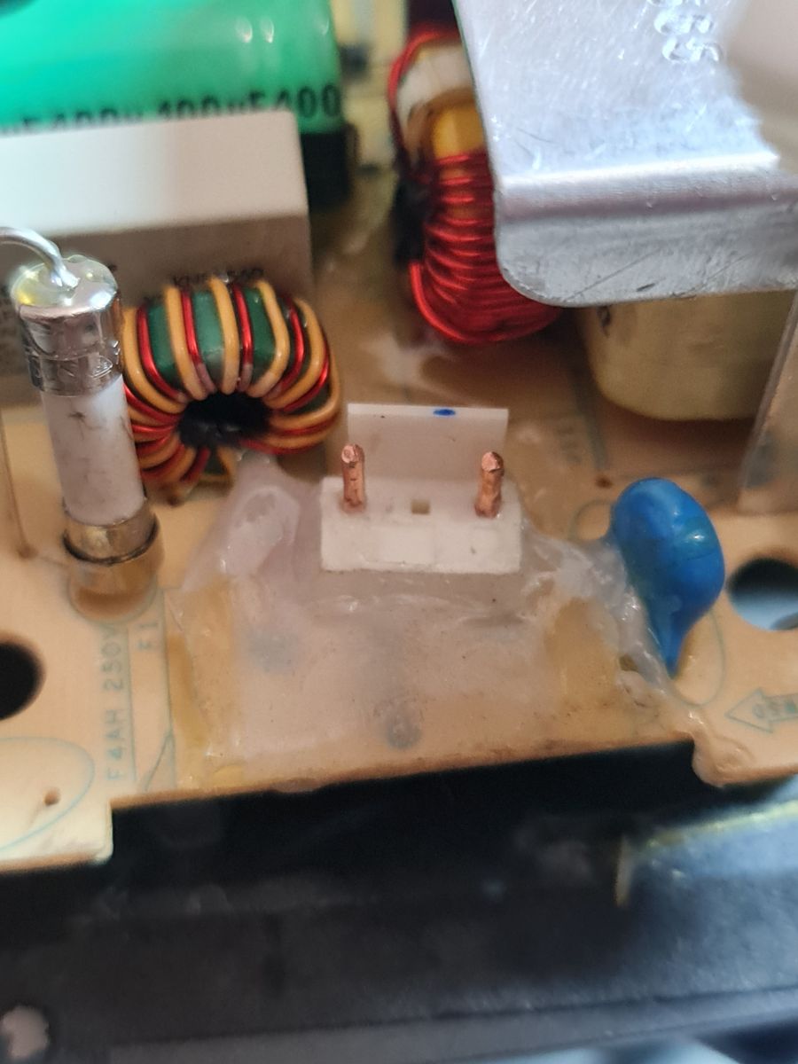

    Hi there, same problem board on fire after several attempts to resuscitate it I decided to change to a power supply from an HP printer 32v 2500mA
    80 watt everything works I will upload pictures of the conversion the power supply was a bit bigger and I didn't want any interference to be visible from the outside.Close-up of electronic device interior showing components like coils, a fuse, and a circuit board. Close-up of a damaged circuit board with a scorched area. Close-up of a damaged circuit board with a scorched area. Close-up of modified electronics with visible wires and circuit boards. Image of an opened power supply case showing electronic components, capacitors, and wire connections. Close-up view of the interior of an electronic device with a circuit board and wiring. Modified power supply with circuit board replaced from an HP printer. Black HP printer power supply on a table next to a scorched circuit board. Close-up of an HP power adapter with model and technical specifications. View of the interior of a housing with electronic components and a modified power supply. Back of JBL BAR 2.1 subwoofer with labels. .

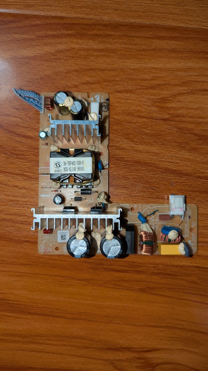

  • DRV/OUT missing with R543 and R544 heating up
    #50 21450542
    myszowaty23
    Posts: 237
    Rate: 27
    Hello, like the previous speakers I have the same problem with the device. I have replaced the components and so far I only have 330V on the primary side. The VCC supply of the driver jumps from 8 to 12V. On the DRV/OUT pin it does not appear and I understand that this is the signal that controls the MOSFETs. On the IR camera I can see that R543 and R544 from HV on the driver are heating up. What else can I look for to get to the target?

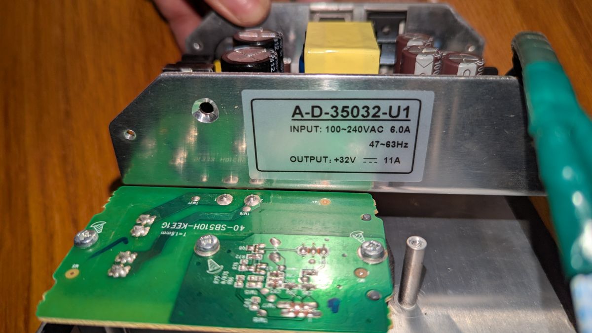

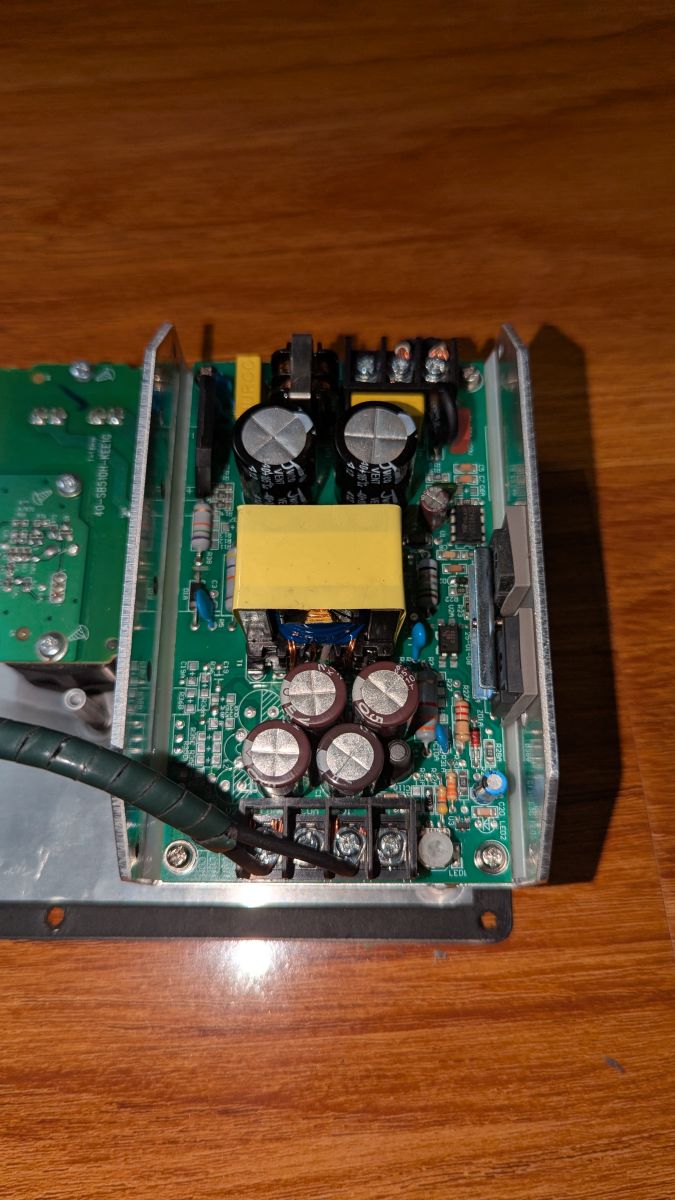

  • AliExpress 32V 350W supply replacement workaround
    #51 21572895
    jcmyolaymmu
    I ordered 32V 350W audio power supply from AliExpress and replaced power board, power supply output can be increased to 34V by adjusting preset(VR) near output terminal. Works well but need to manually switch off sub woofer power cos auto power on/off is not supported on new power supply. Combine 34V 3 wires and GND 3 wires, discard 1 wire for auto power on/off. I feel even more powerful bass after replacement, may be due to 350W supply.
