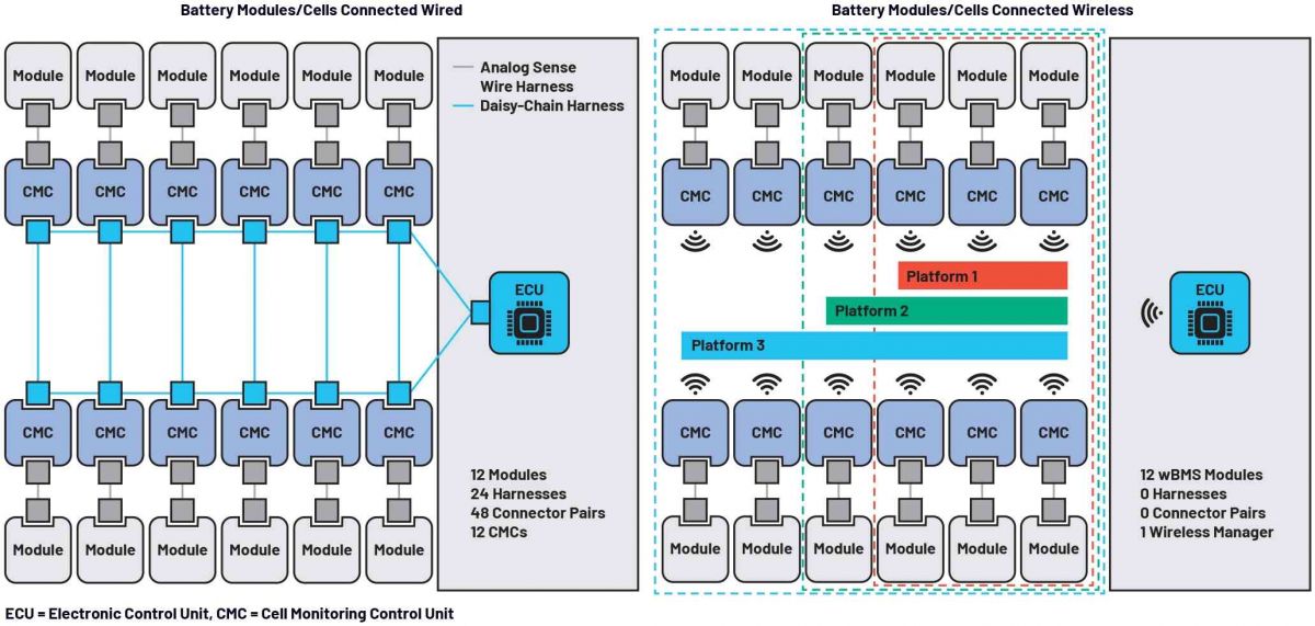

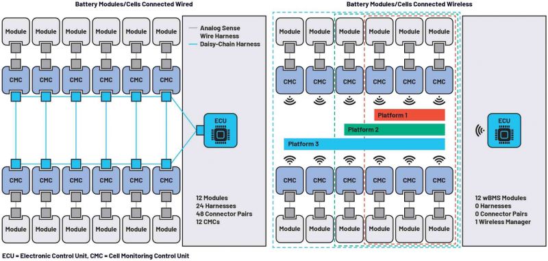

    A battery management IC measures each cell in a typical EV battery pack. The pack ECU is then informed of data from the battery management IC through wire.
    The essential battery operation parameters (voltage, charge/discharge current and temperature) must be tracked and logged separately for each module to maximize battery capacity, longevity and performance. Traditionally, the connections between each module and the ECU processor have been made with wires, as shown on the left of Figure 1.
    wBMS Gives Next-Gen EVs the Advantage
    Figure 1: A typical multicomponent wired BMS network (left) and the simpler
    arrangement made possible by wireless BMS technology (right)
    However, wired connections have some disadvantages, as copper wiring harness adds additional weight and occupies space that, if filled by a battery cell, would provide extra energy capacity. In addition, connectors may mechanically fail, especially in situations of vibration and shock, and the wire must be secured to the battery housing structures.
    This results in higher cost, weight and development time, as well as a reduction in reliability, available space and driving range. Given those requirements, there are compelling arguments for automakers to integrate a reliable wireless technology into new EV battery system platforms.
