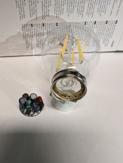

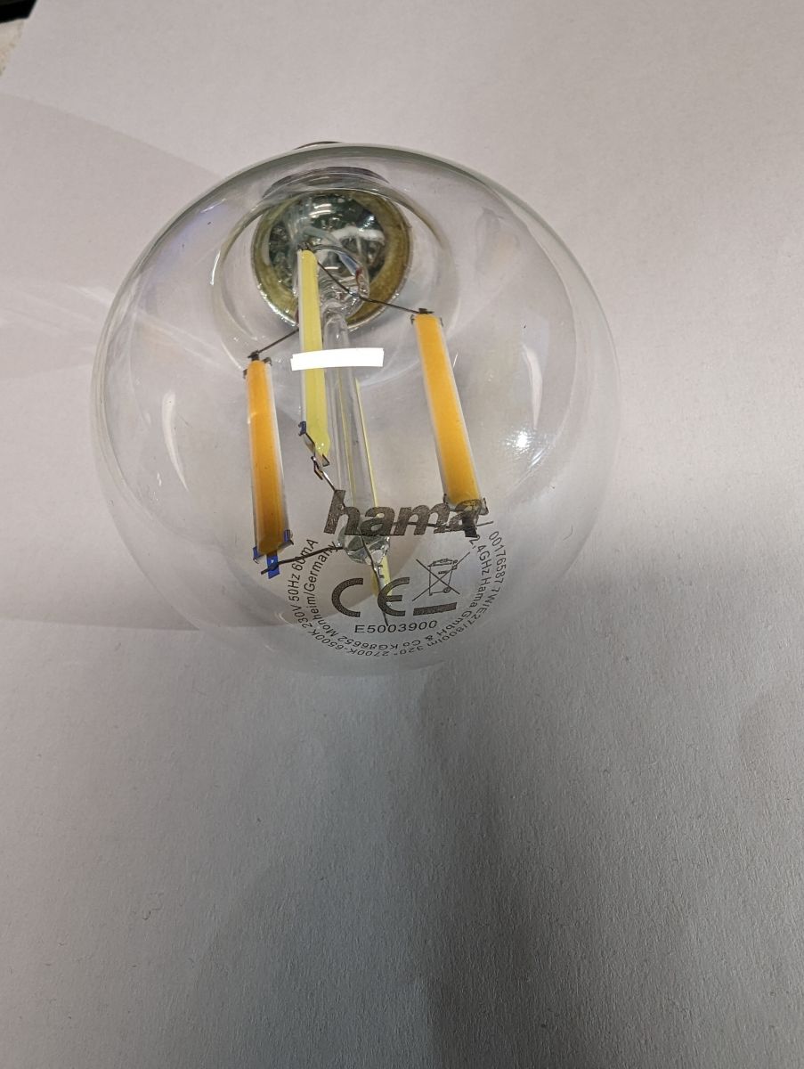

    This is an LED Filament bulb from Hama. I bought it because in Germany/Austria they are currently very cheap (2€) at "Media Markt".
    Exploring the Hama 176587 WiFi LED Filament E27: Inside Look and BK7231T Chip Dumping Exploring the Hama 176587 WiFi LED Filament E27: Inside Look and BK7231T Chip Dumping Exploring the Hama 176587 WiFi LED Filament E27: Inside Look and BK7231T Chip Dumping Exploring the Hama 176587 WiFi LED Filament E27: Inside Look and BK7231T Chip Dumping

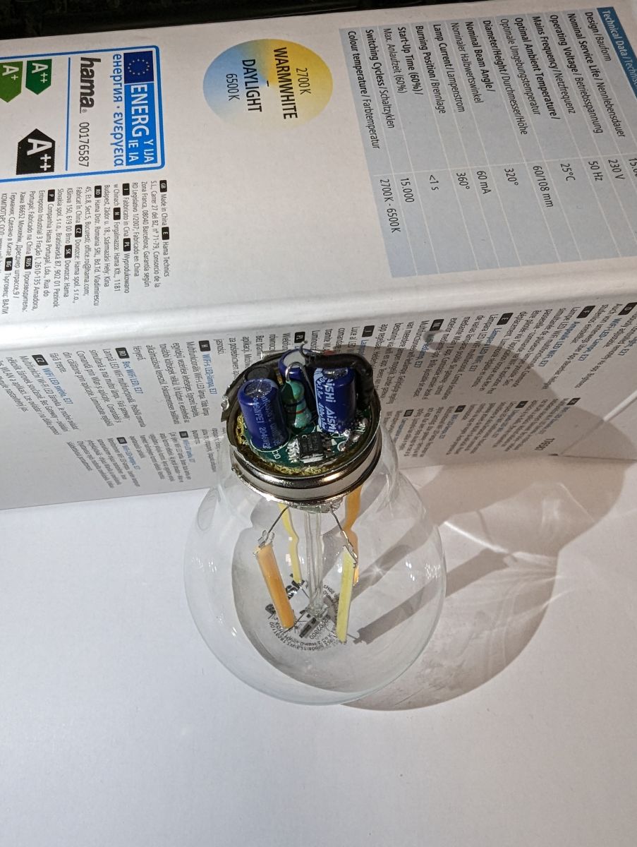

    I failed at dumping it with lightleak, so I opened the bulb (not really possible without destroying the socket).
    The bulb comes with a WCL5 BK7231T Chip. After soldering the 4 pads I successfully dumped it using bk7231tool.

    Btw, how does this bulb looks when on, how good the visual effect is?
