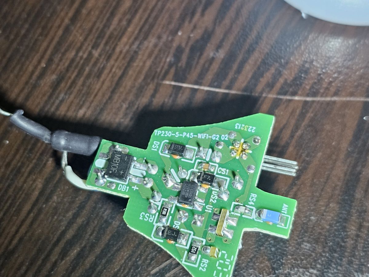

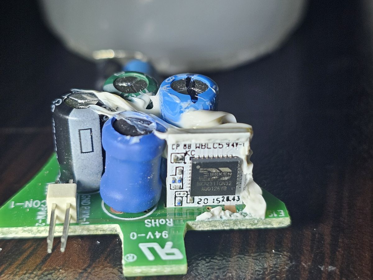

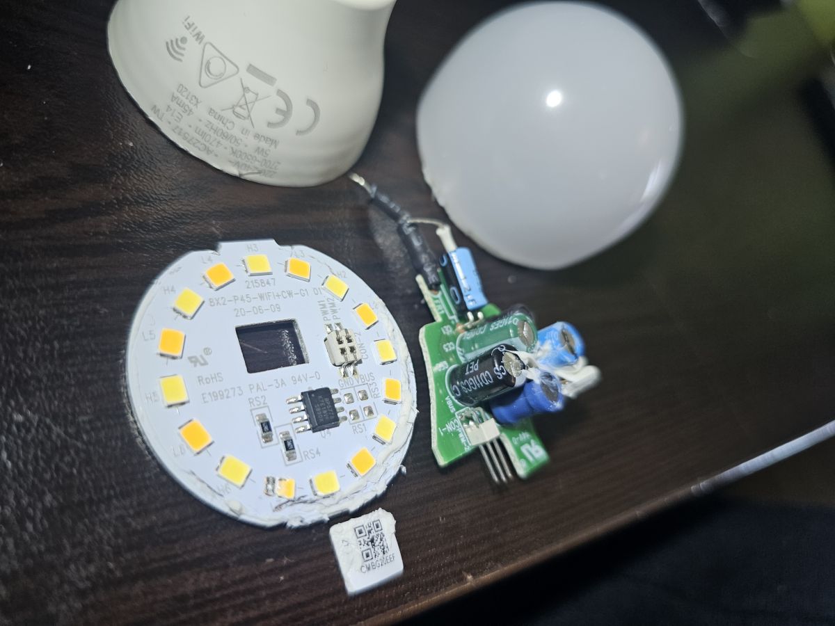

    LED КР E14 5W 27-65K 470LM SMART, WIFI LEDVANCE LEDVANCE Firmware dump.
    Here are images of the Light - it uses BK9231T controller, powered by BP2525 and controlling BP5778.
    Similar lights disassembly here:
    https://imgur.com/gallery/lsc-gu10-cw-ww-bp57...ya-white-ambiance-budget-store-action-cCG39uV
    Close-up of a circuit board with electronic components.
    Circuit board with various electronic components, including capacitors and an integrated circuit.
    Disassembled LED bulb with visible electronic components.
    Dump done with BK7231GUIFlashTool v16 ( https://github.com/openshwprojects/BK7231GUIFlashTool/releases )

    Thanks for sharing, but did something happen to one of the LEDs? It's not looking good.
    How much such one piece costs?
  • Bought for parts to salvage MCU and driver
    #3 21479788
    apsis
    Posts: 26
    >>21479766 Yes I did break two LEDs while opening the bulb - was trying to preserve the housing.
    The bulb was bought locally for about 12 Euro from Praktiker.
    I do not mind it breaking as I was after the MCU PSU combo and can use the LED driver too.
    I bought E14 so the board is small, I do not actually need the bulb as a whole - it was "for parts" purchase.
    I am also able to replace the LEDs if I ever need to - have heated plate hot air station.

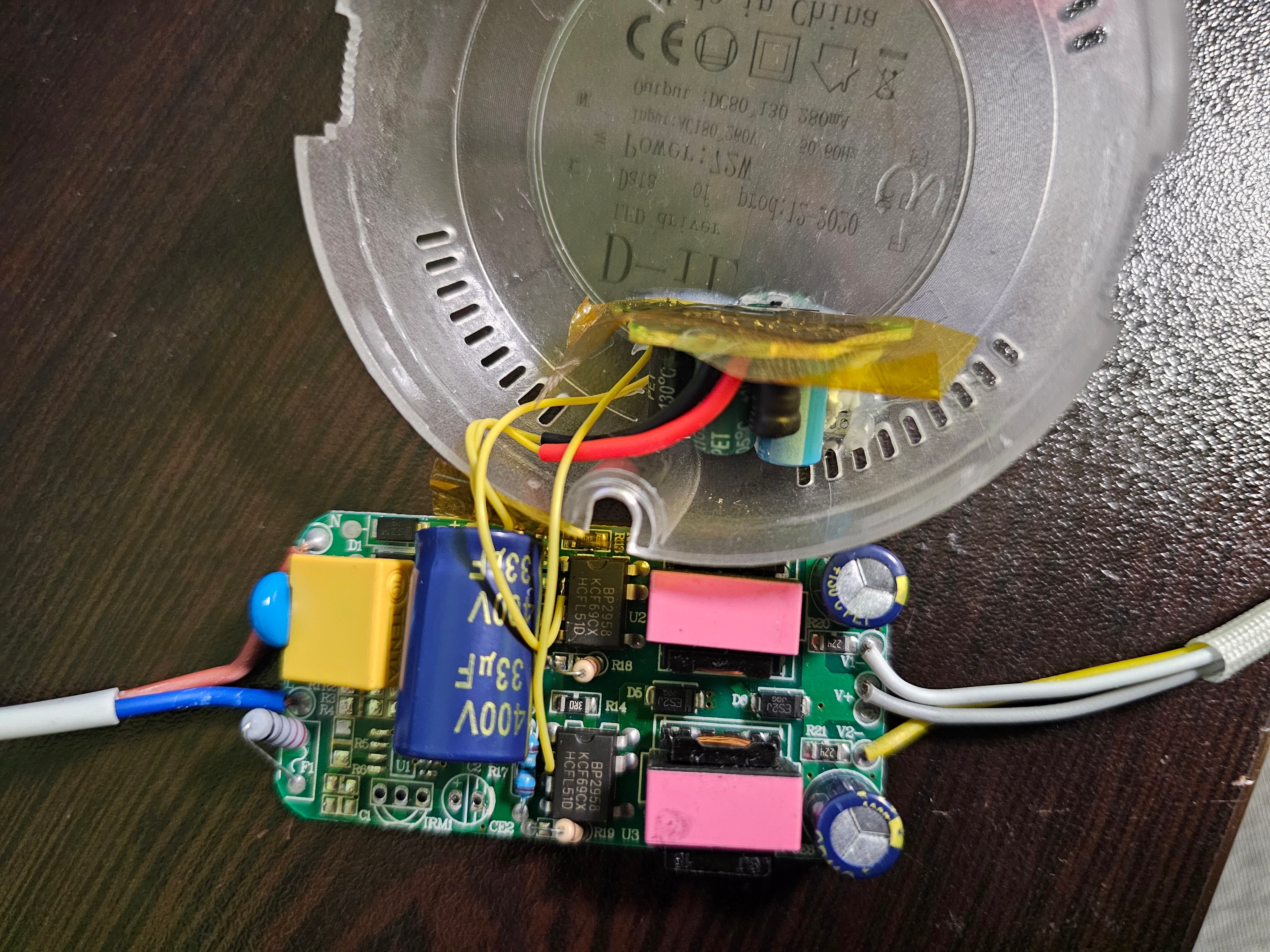

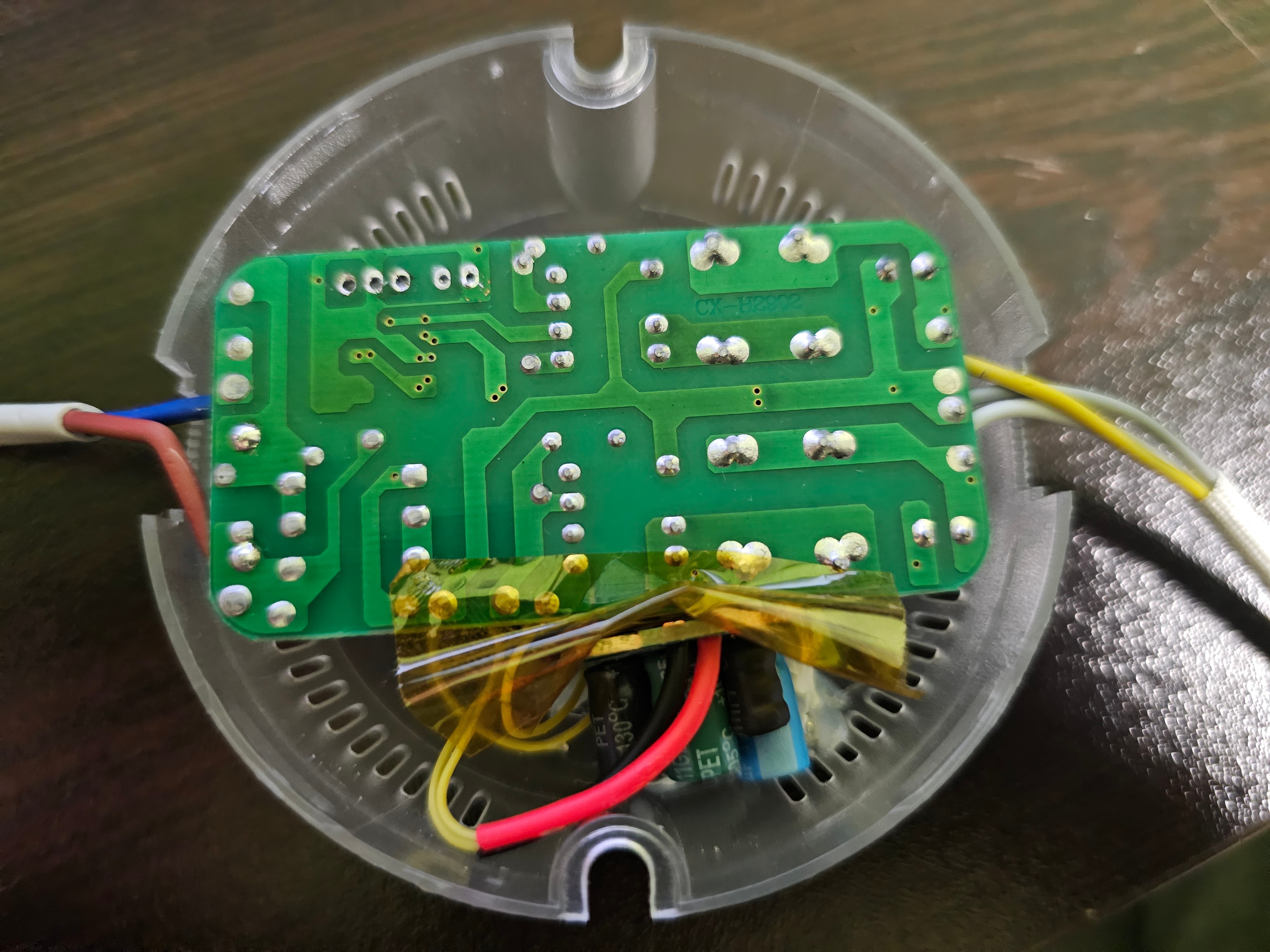

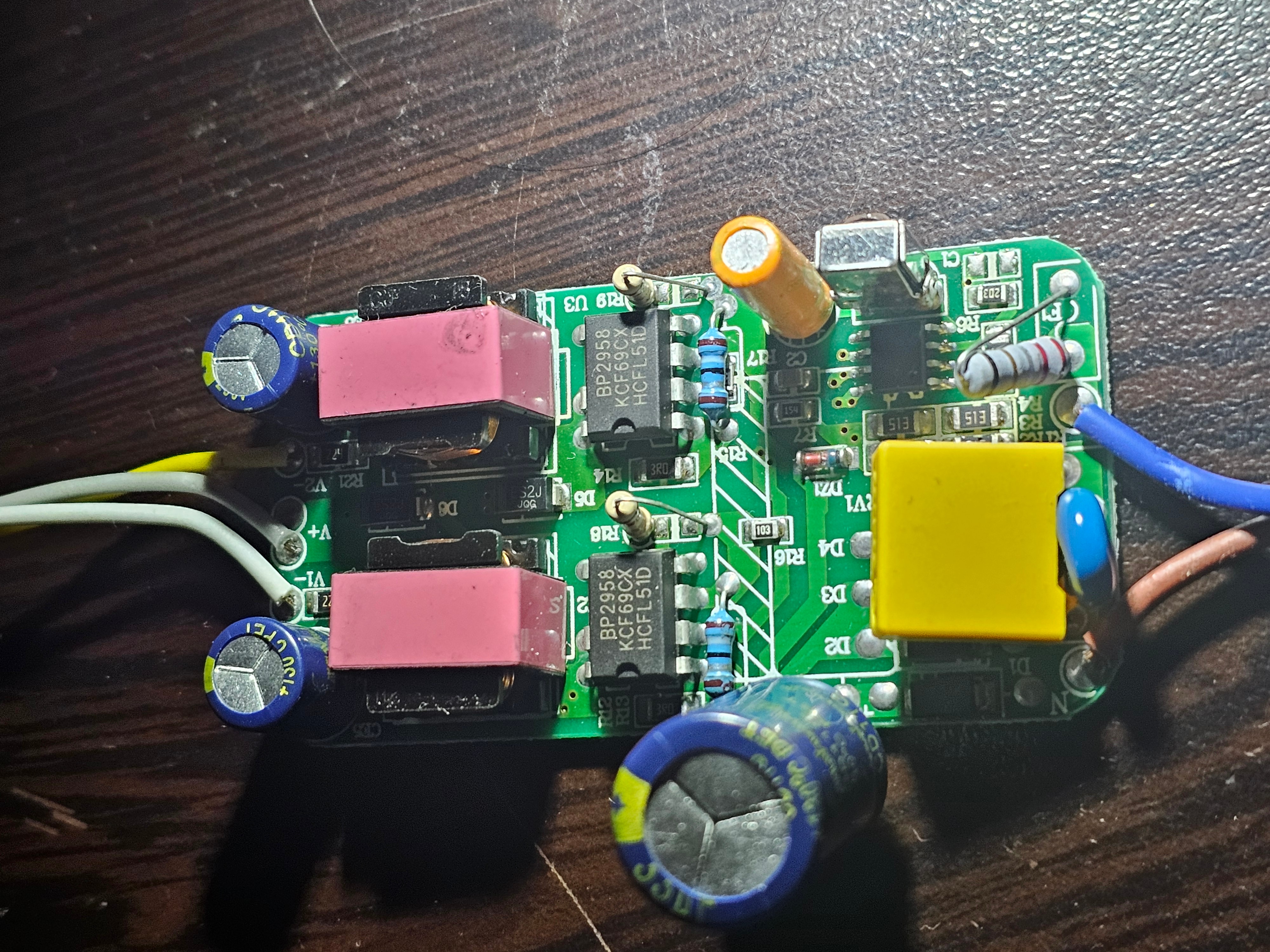

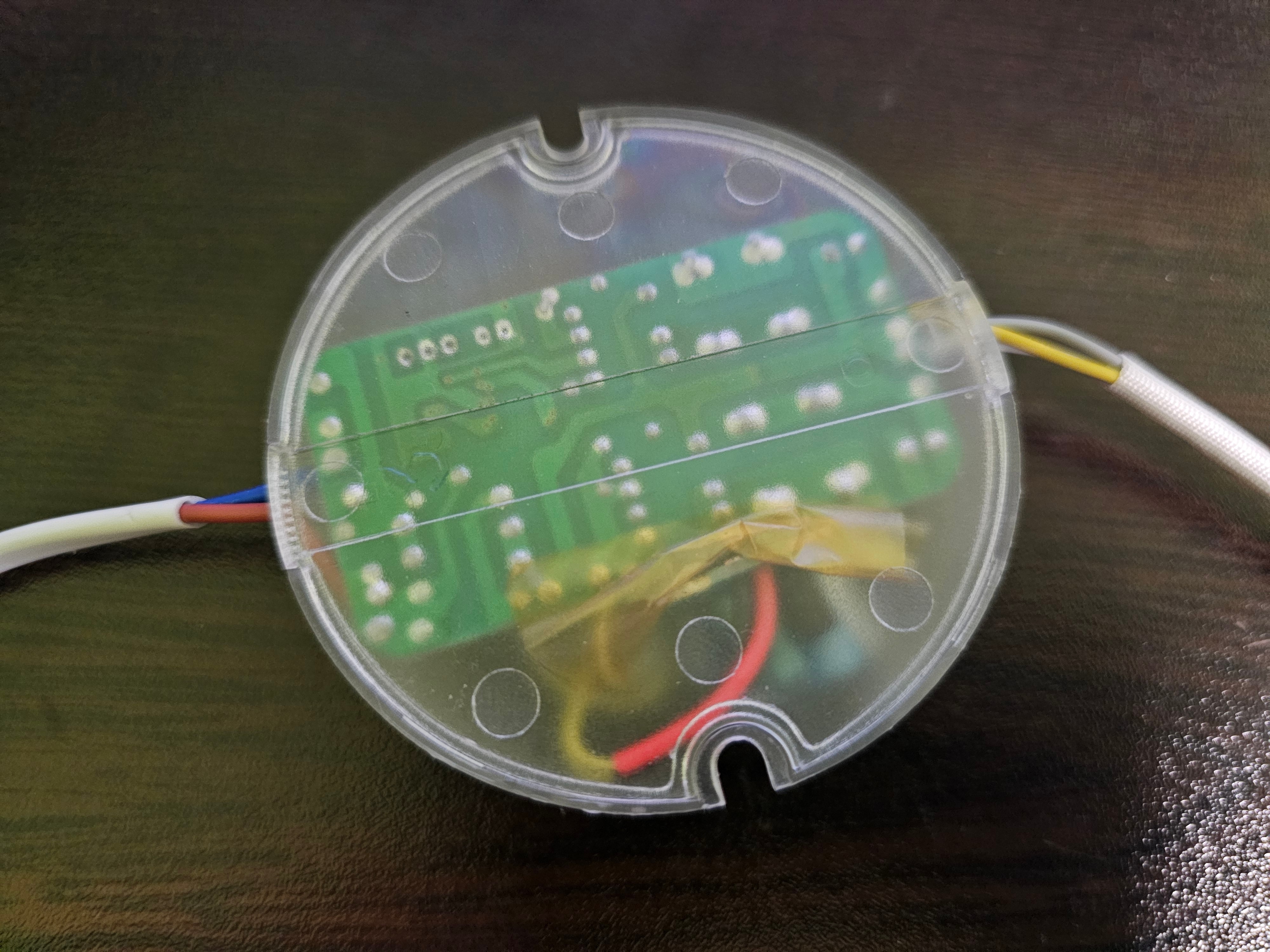

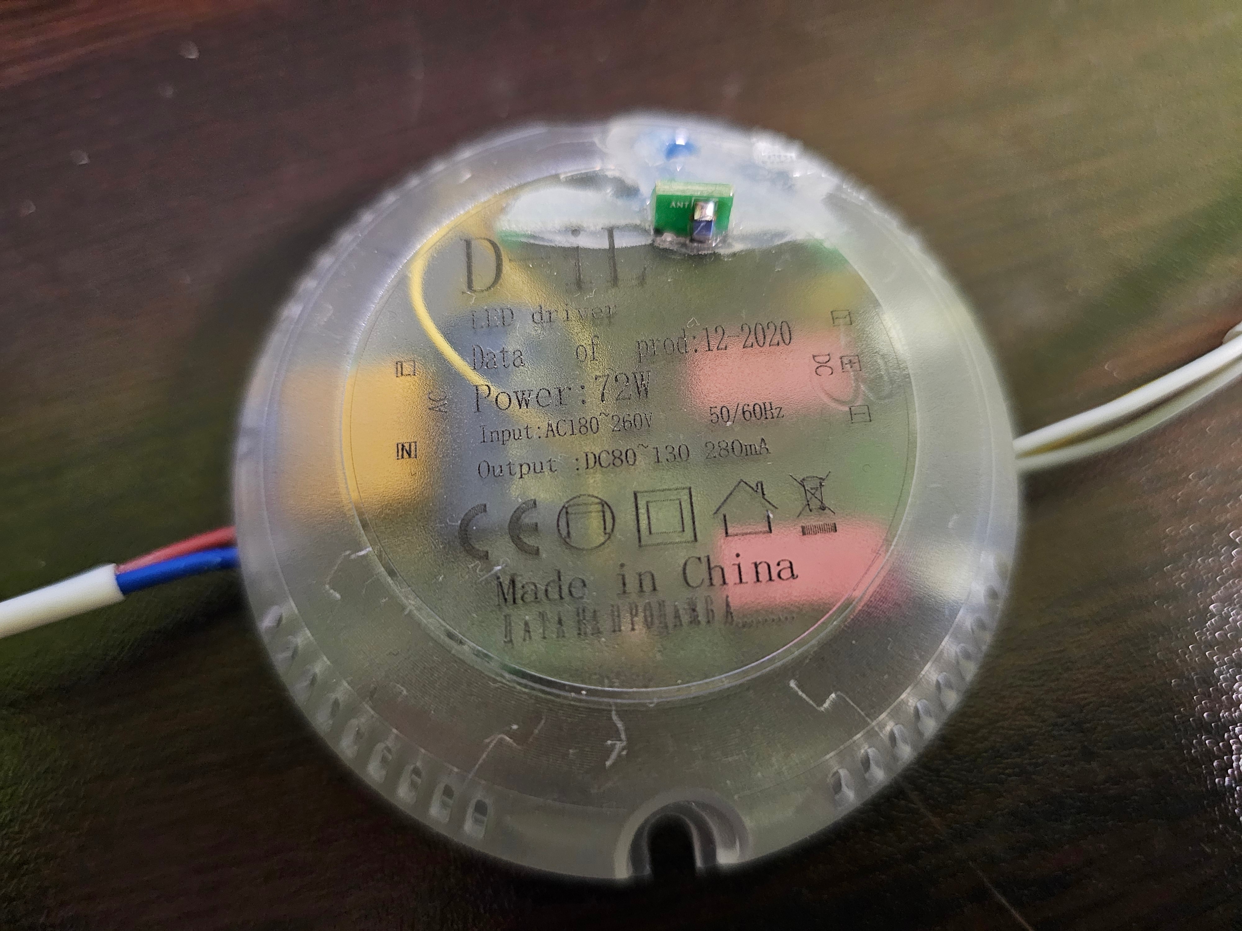

    apsis
    Posts: 26
    I have connected the board after removing the Gretz, fuse resistor, and input capacitor to control and get powered by another driver and control it.
    Basically, I turned the IR fixture into a Wi-Fi one.
    Some component removal for powering the IR controller and the controller itself is involved.
    • LEDVANCE E14 5W Smart Bulb Firmware Dump with BK7231GUIFlashTool v16 20250329_185233.jpg (3.37 MB) You must be logged in to download this attachment.
