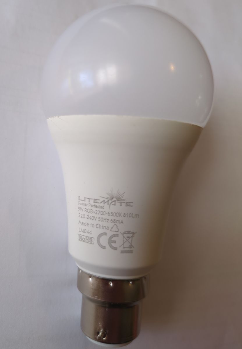

    Bulb with markings:
    Litemate LED bulb with a white shell and metal base.

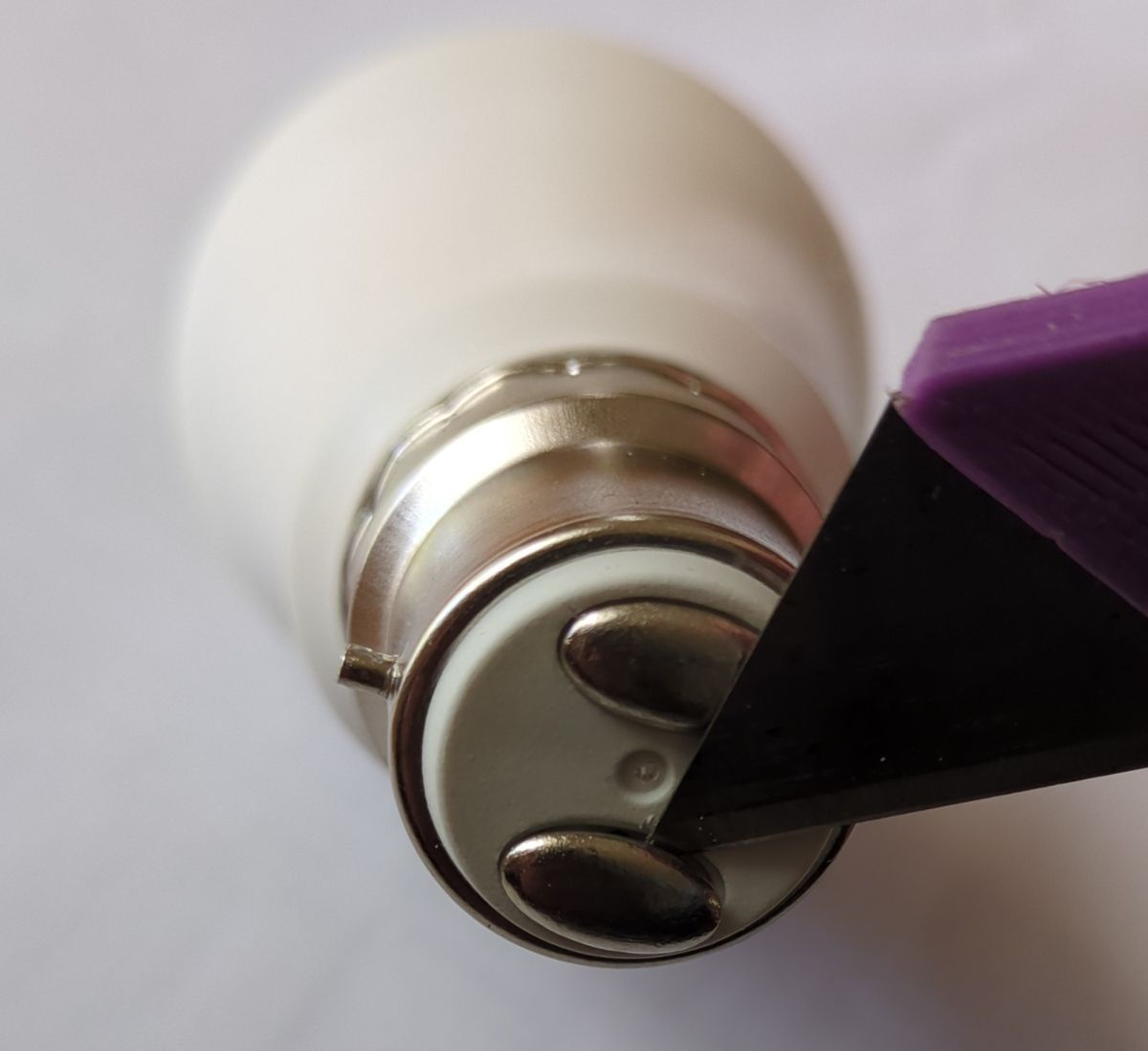

    Prise out the press fitted electrical contacts:
    A GU10 light bulb socket with metal contacts and a purple knife blade pointing at the contacts.

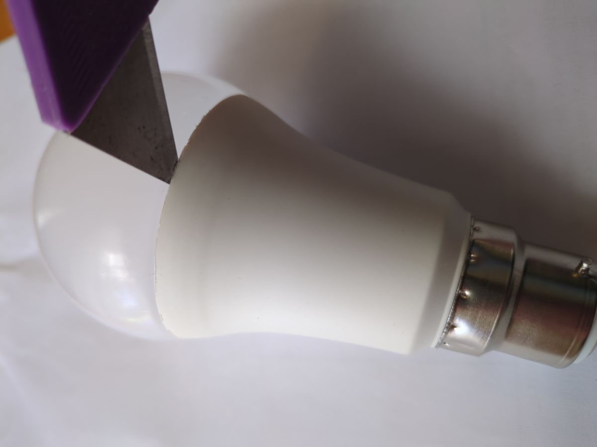

    Loosen silicone sealant before twisting the plastic bulb cover back and forth to free it:
    LED bulb cut with a knife with a purple handle.

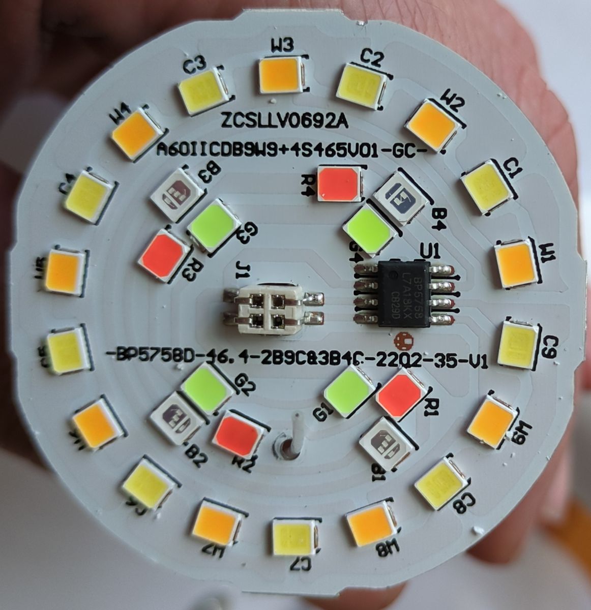

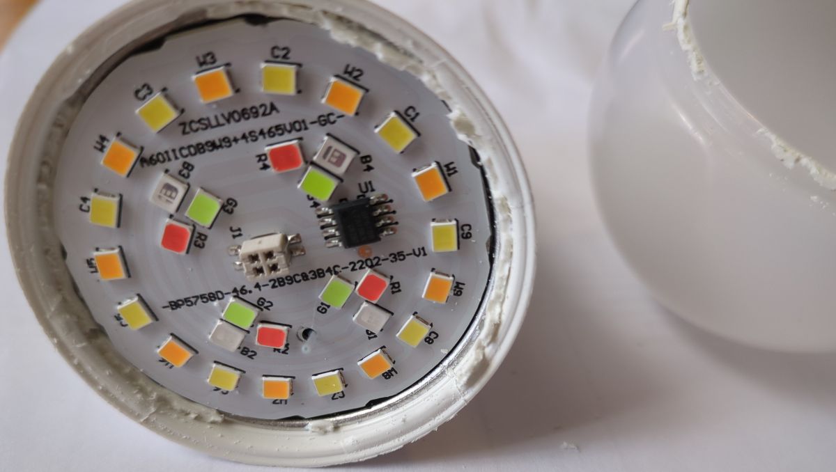

    First sight of the BP5758 driver and four pin connector surrounded by Red, Green and Blue LEDs as well as Cool and Warm white LEDs:
    Close-up of the inside of an LED bulb showing LEDs and electronic components.
    Close up of driver, and LEDs:
    Close-up of a round LED board with multicolored diodes.

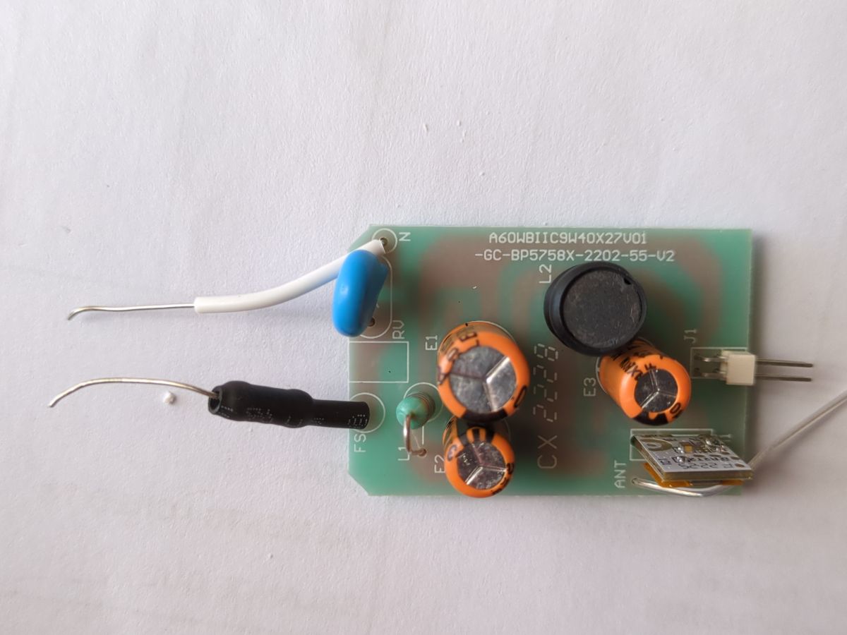

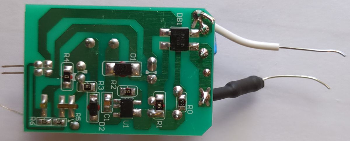

    Board CX2228 with daughter-board CBLC5:
    Circuit board with various electronic components.

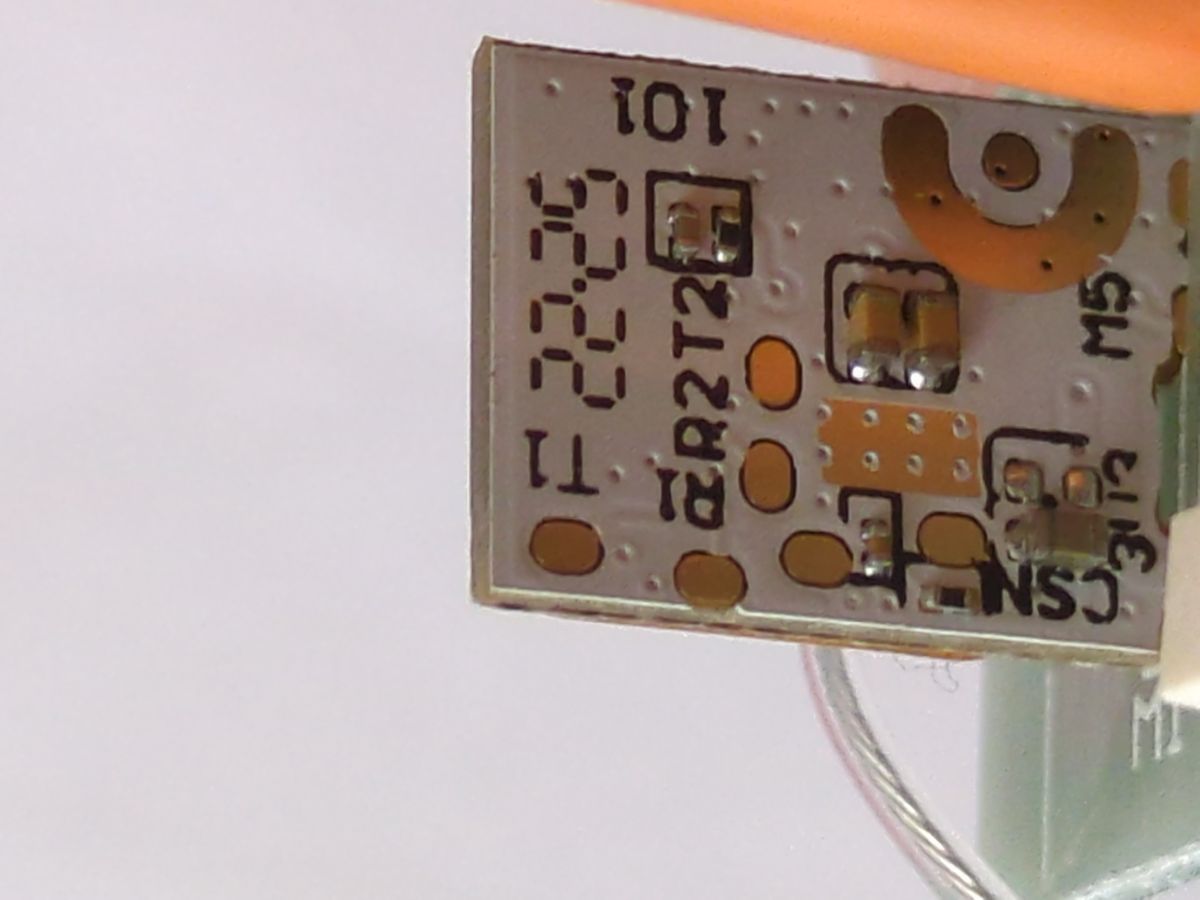

    Bottom of board showing traces and SMDs:
    Green printed circuit board with electronic components and wires.

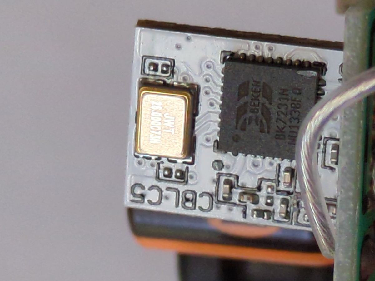

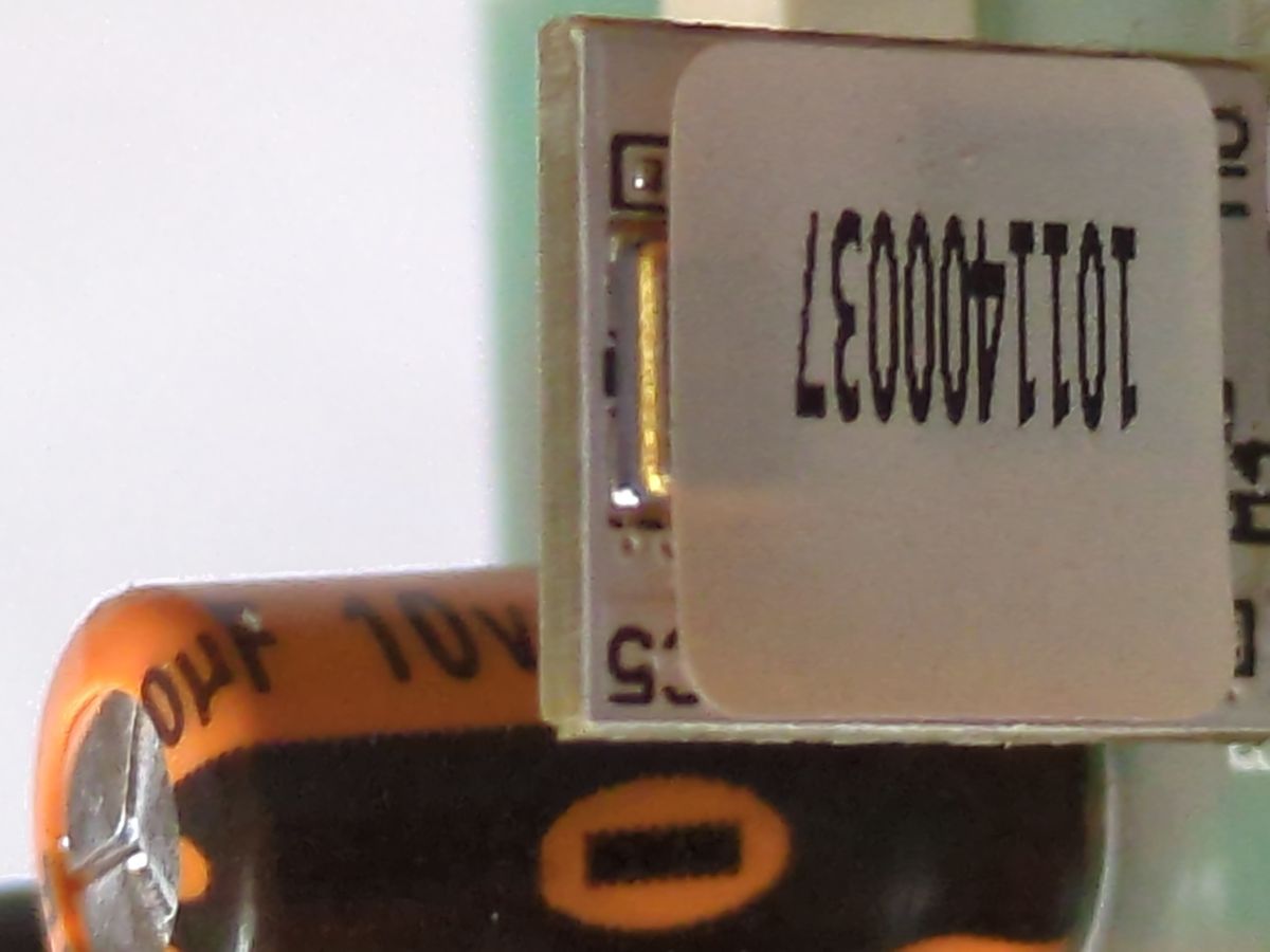

    Front of daughter-board CBLC5 with BT7321N behind sticker:
    Close-up of electronic components, including a labeled capacitor and an integrated circuit.
    Front of daughter-board CBLC5 with sticker removed to show BT7321N:
    Close-up of an electronic circuit with visible chip elements and a gold component.
    Tracing data and clock pins
    J4 - P4 on BP5758 SCL
    J3 - P3 on BP5758 SDA
    J2 -
    J1 - P2 on BP5758 High Voltage Input
    J4 - CBLC5 PWM0 P6
    J3 - CBLC5 PWM4 P24
    Ergo:
    BP5758 S-Clock =PWM0 (P6)
    BP5758 S-Data = PWM4 (P24)
    Mapping order:
    Red: 1
    Green: 0
    Blue: 2
    Cool: 4
    Warm: 3

    AI: Did you encounter any issues or have specific questions about the components or functionality during the teardown?
    Order of LEDs was off but specifying a mapping order sorted that out.

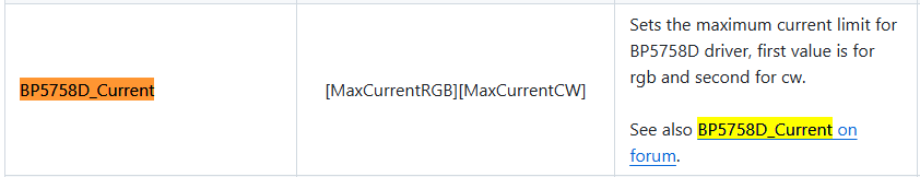

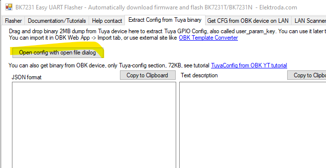

    https://github.com/OpenBekenIOT/webapp/commit/9a1a2d096dfde4fbce3998f92f192be09e69d487
    did you set powersave?
    did you happen to take a factory firmware backup?
    you can also set current with BP5758D_Current command - your factory values may be in boot log from original firmware and/or in config extraction json
    https://github.com/openshwprojects/OpenBK7231T_App/blob/main/docs/commands-extended.md
    Documentation snippet with highlighted text BP5758D_Current.

  • #4 21502814
    Posts: 5153
    Help: 442
    Rate: 906
    maybe.
    run it through easy flasher
    Screenshot of the BK7231 Easy UART Flasher with an open section for loading configuration.
  • #5 21509069
    smitty1
    Level 4  
    >>21502814
    I would have, but I don't have any Windows machines, and trying to use Mono was a failure.
  • #6 21509080
    Posts: 5153
    Help: 442
    Rate: 906
    Feel free to send it me and I'll have lookie
