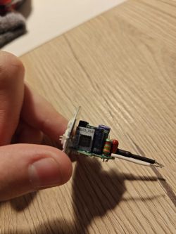

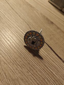

    It has a WBLC5 with BK7231T built-in.
    Flashing Hama WLAN-LED-light bulb E14, 5,5W, RGBW, dimmable with Tuya-Cloudcutter Flashing Hama WLAN-LED-light bulb E14, 5,5W, RGBW, dimmable with Tuya-Cloudcutter Flashing Hama WLAN-LED-light bulb E14, 5,5W, RGBW, dimmable with Tuya-Cloudcutter
    There is no dismantling necessary since it can be flashed with tuya-cloudcutter following those instructions

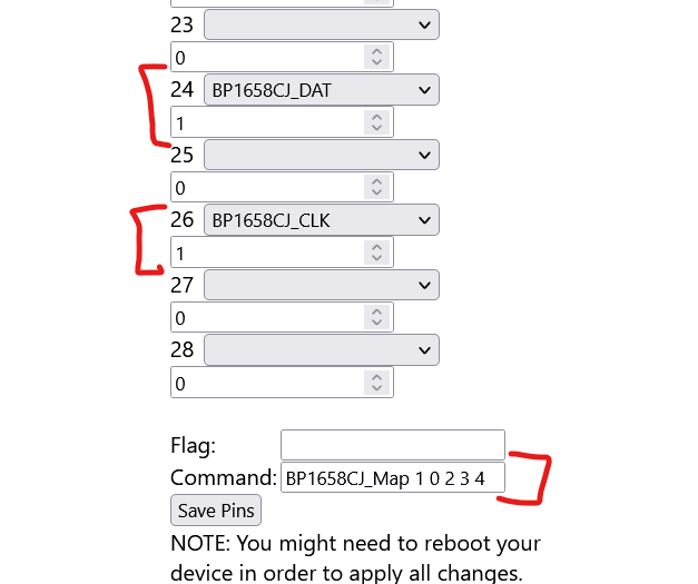

    After flashing configure module:
    P24 BP1658CJ_DAT
    P26 BP1658CJ_CLK
    Configure General
    set Flag12 (restore on power)
    Change Startup command text:
    BP1658CJ_Map 1 0 2 3 4
    DON'T FORGET TO REBOOT AFTERWARDS

    Hello, do you know which module is used inside so I can fill the missing fields in the template? Can you do config extraction and attach it here?
    Use this method: https://www.youtube.com/watch?v=VDbaLR_0YWs
  • #3 20835160
    alpsware
    Hi, yes its all in the above post. :)
  • #4 20835162
    Posts: 14622
    Help: 655
    Rate: 12641
    I was referring to this field:
  • #5 20835166
    alpsware
    Oh haha, I forgot to fill this out. Sorry, my bad. It's a WBLC5.
