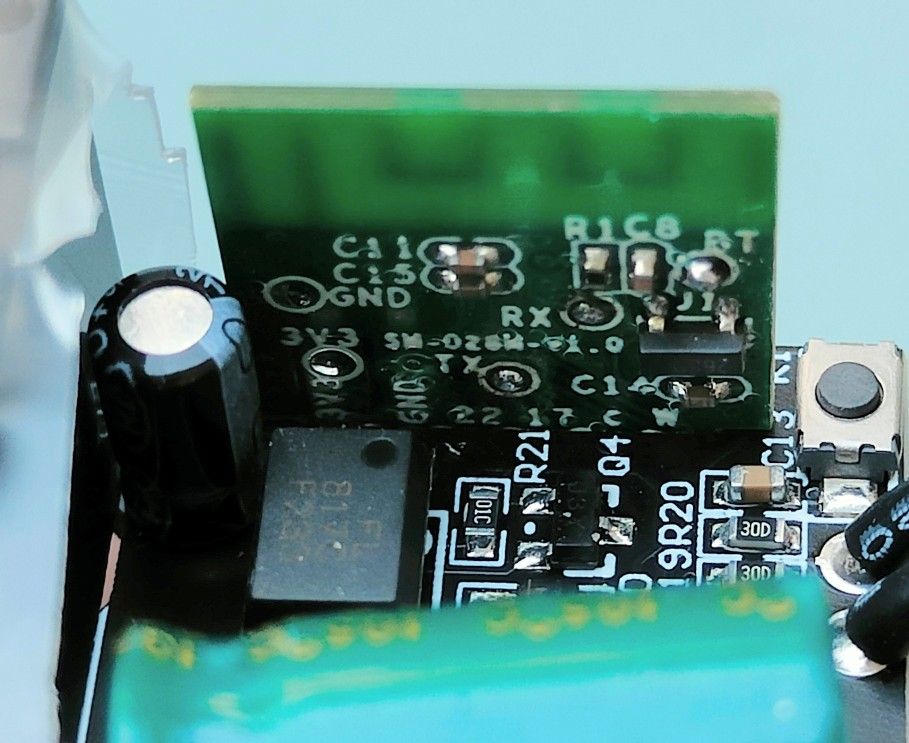

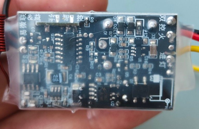

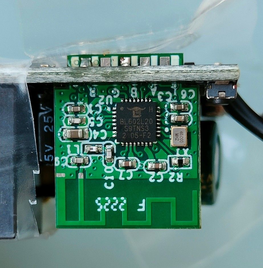

    It will be a quick description of PINs. eWelink doesn't support LAN control mode, so it is a reason to upload OpenBeken firmware as described for BL602. I tested it with OpenBeken v. 1.15.591
    Don't know how RF radio is working, but thought that OpenBeken doesn't support that.
    Chipset: BL602
    Vendor: https://vi.aliexpress.com/item/4000906907718....t_main.11.e0e81802onzuFS&gatewayAdapt=glo2vnm
    Application: HomeAssistant via MQTT
    [BL602] eWelink Single Wire WIFI Module 1gang 2 way RF433Mhz no neutral light switch
    Pin Settings:
    P3 Btn 0 0
    P12 Rel 0
    P20 LED_n 0

    For the RF, you just have to pair it with any RF remote
    i think you need to toggle switch twice to start pairing
  • #3 20488529
    papopsik
    Actually I don't have any RF Button for controlling it, so can't try it. I supposed that it has its own radio control chip separated from BL602, you have a good point.
  • #4 20488622
    ferbulous
    Posts: 419
    Help: 8
    Rate: 56
    Yeah, similar to sonoff ifan
    There's another one I spotted using tuya, so it could have cb2s on it
    The form factor makes it easier to fit behind the switch compared to sonoff mini/tuya wifi mini relay module
