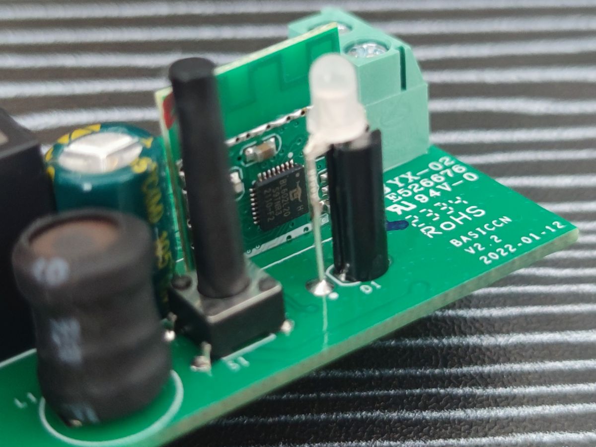

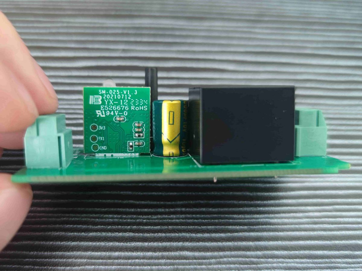

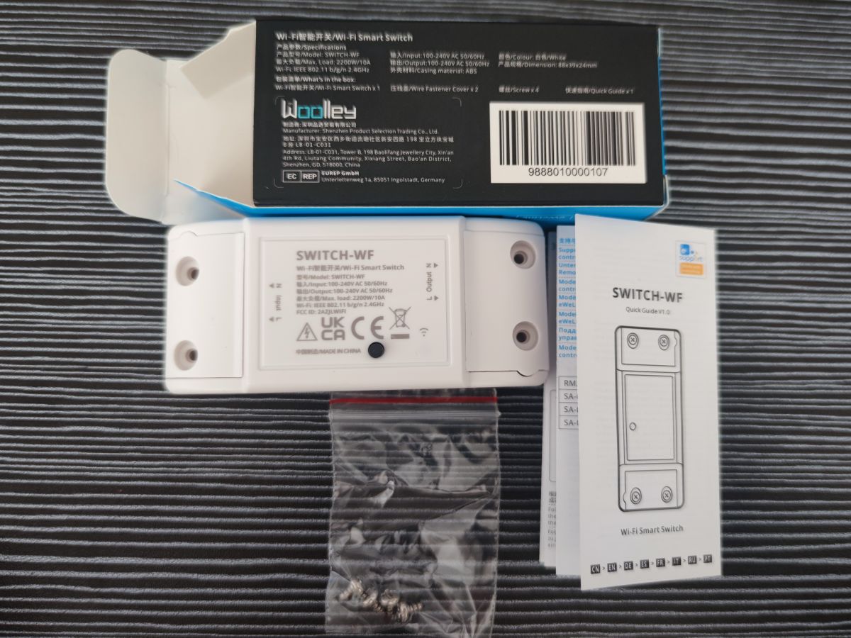

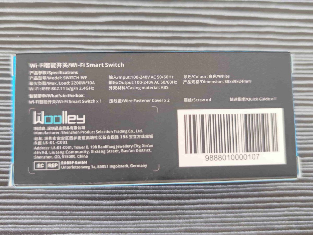

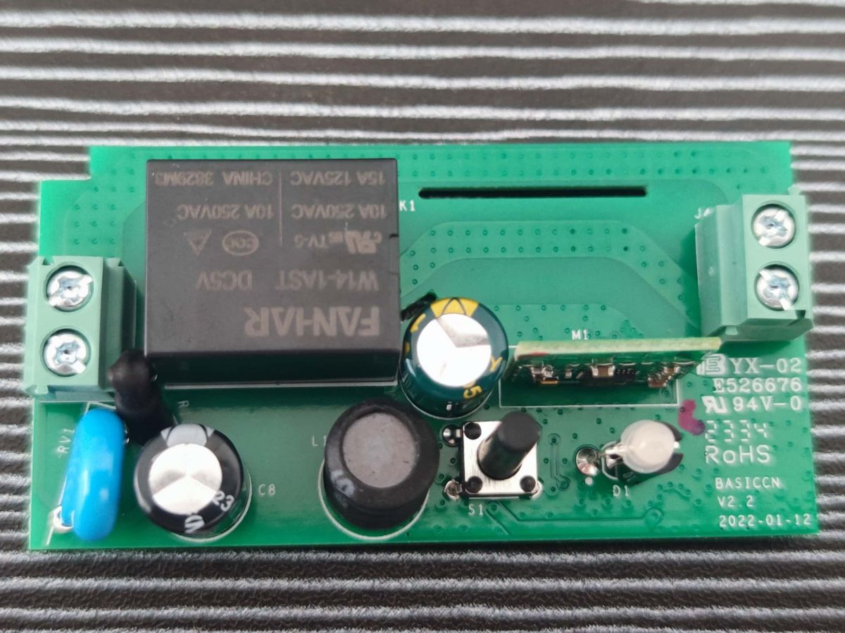

    I bought a Smart DIY Switch that perfectly meets all my needs. But the biggest problem is that it heavily relies on cloud services (eWeLink) to work, so I want to use OpenBeken to achieve pure local control.
    The Switch Information:
    Brand Name: WOOLLEY
    Model Number: SWITCH-WF
    Purchase link: alibaba amazon.co.uk
    WiFi: IEEE 802.11b/g/n 2.4 GHz
    Note1: Only 2.4 GHz Support, Only eWelink APP Support
    Note2: This brand seems to belong to the same company as brand Sonoff (sold by the same company)
    Back of Wi-Fi smart switch packaging with technical and manufacturer information. Wireless SWITCH-WF Wi-Fi switch with manual and packaging. Printed circuit board with various electronic components. Photo of a green printed circuit board with visible traces and electronic components. Circuit board with electronic component and technical markings. Close-up of a circuit board with various electronic components.

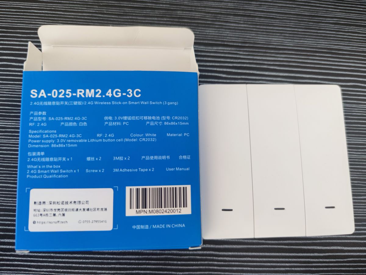

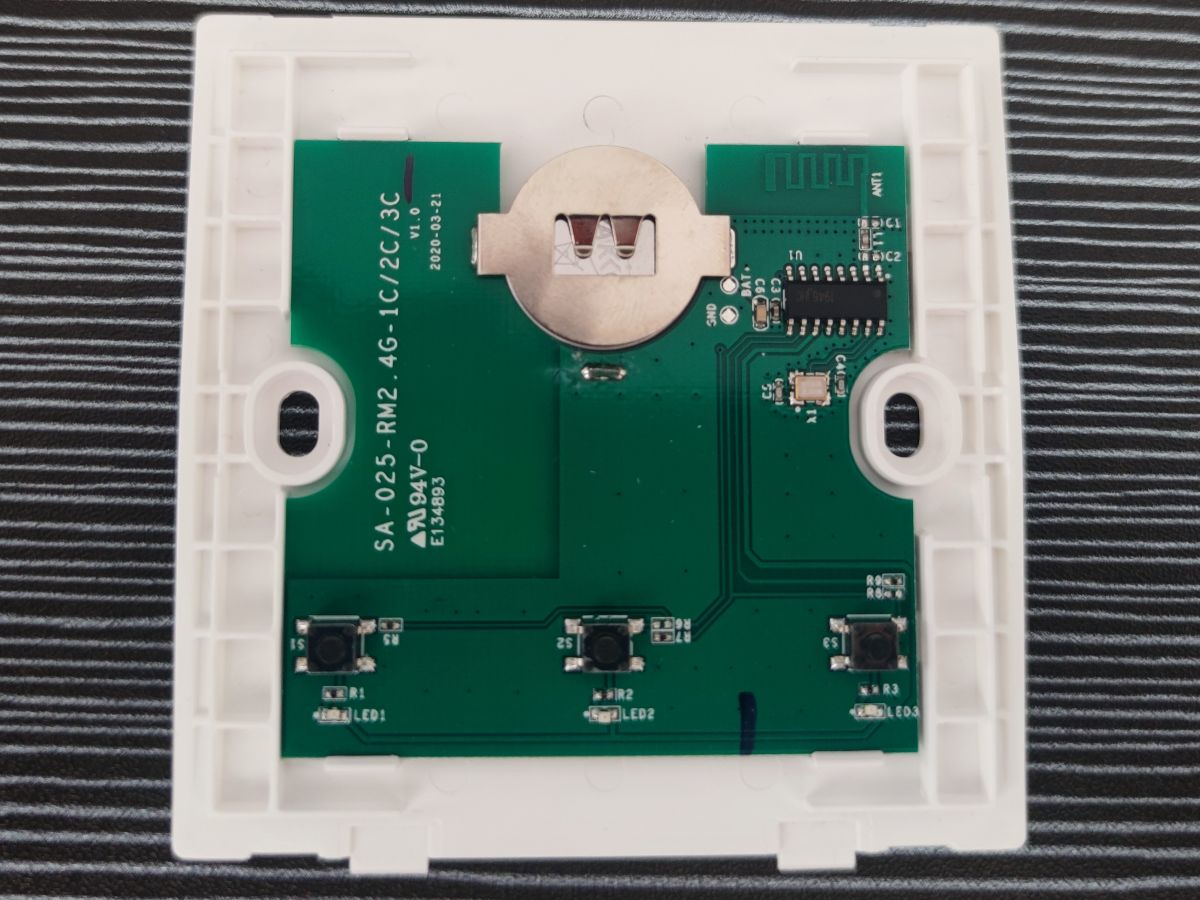

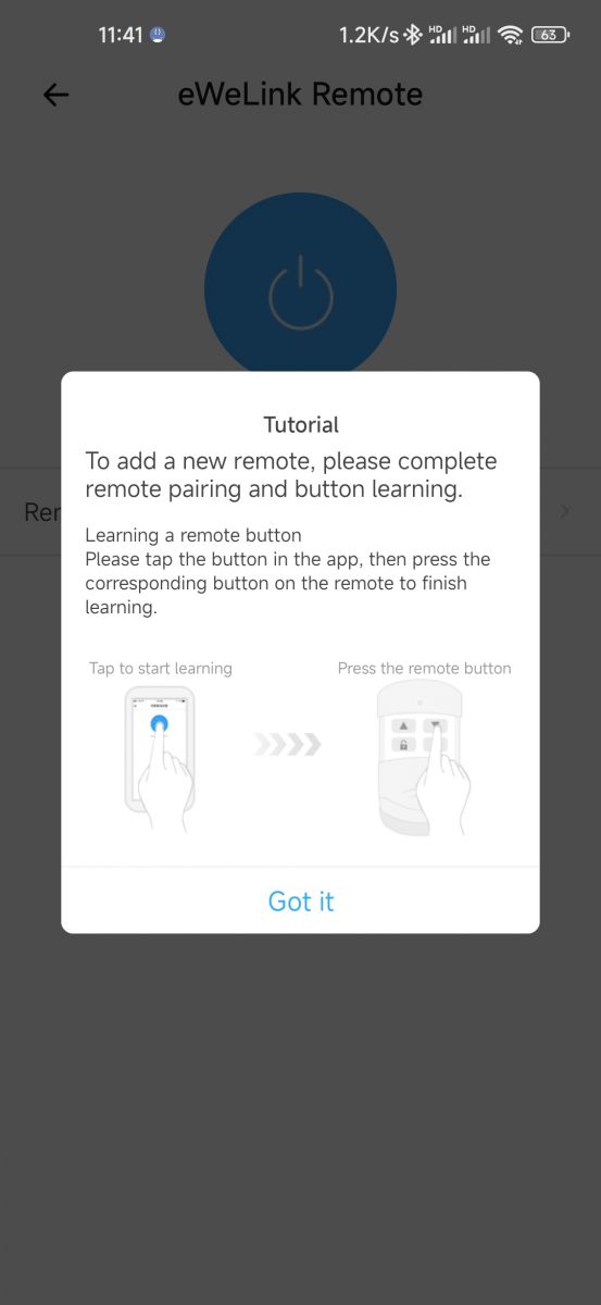

    One of the functions I need the most is that the switch can be controlled by the remote control, which is called "2.4 G Wireless Stick-on Smart Wall Switch" by the seller. This remote control is using 2.4G RF to control (from the manual, I cannot confirm if it is correct). To use a new remote control, we must complete remote pairing and button learning in eWeLink APP.
    The remote control Information:
    Screen of remote pairing tutorial in the eWeLink app. 2.4G smart wall switch with packaging. Close-up of the internal circuit of a remote wall switch.
    If I use OpenBeken, can I still achieve this remote control function, or even more powerful? For example:
    In the original firmware, it is required that remote pairing and button learning, and I can only control one paired switch, can only control the switch on and off.
    In OpenBeken, is it possible to achieve that the switch is used as a 2.4G RF gateway, accepting all remote control signals and sending them to HomeAssistant, who will complete the processing of operational logic.
    (If this can be achieved, we can use this remote control to control other devices, not just this switch. For example, after pressing a button, switch A receives a 2.4G RF remote control signal, forwards it to HomeAssistant, and then controls device B to act (device B does not directly receive any 2.4G RF remote control signal)

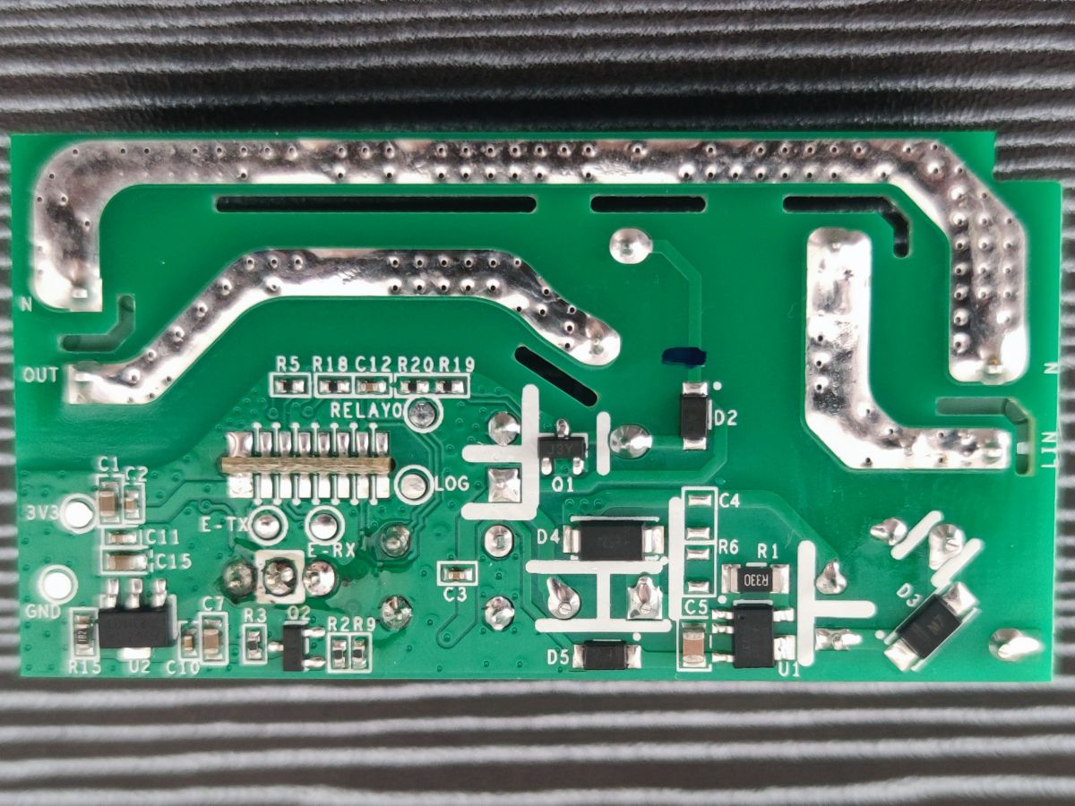

    This is a very interesting problem. I can't see any RF receiver on the board of the smart switch you've shown. Are you really sure it works with shown wall switch?
    They might be using WiFi module RF somehow?

    After several days of research, I have found that this remote control uses BLE instead of 2.4G RF. Because I can scan and receive BLE broadcast messages when I press the button,
    So my request for help became "Could this smart Wi-Fi switch work as a BLE gateway?"
    Thank you for your attention!
  • #4 20912560
    Posts: 14797
    Rate: 12954
    Okay, this makes a bit more sense, since BL602 indeed has BT capability. Now, do you know the details of BLE protocol used? BL602 SDK is open source and available on Github, but I haven't used myself BLE portion of BL602 yet.
