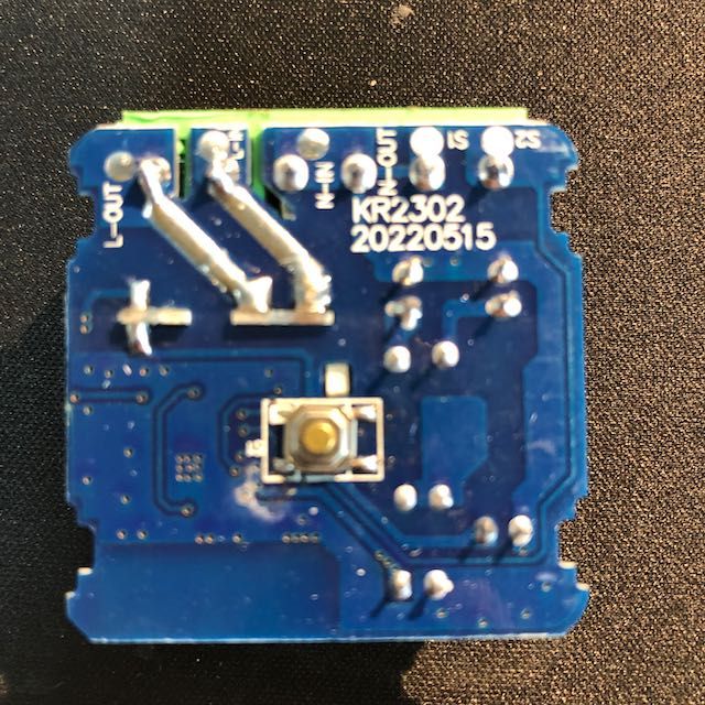

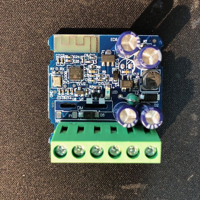

    Hi guys, I have a couple of new WiFi Smart Switches, not exactly the same as the existing ones in the forum, its cpu is BL602, glad to still be able to use OpenBeken, the basic structure below
    pin definition:
    relay:3
    LED: 20
    Button: 22
    Hope it helps you

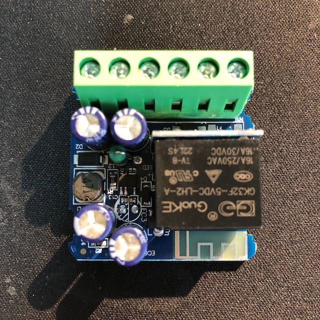

  • #5 20709482
    mmsdh
    Hello. Could you share with us how you removed the relay to gain access to the pins?
    Thank you very much.
  • #6 20709876
    Posts: 14755
    Rate: 12880
    I think it should be very easy if you use some extra flux, add some extra Pb solder to the existing pads and then remove all the solder with soldering wick. Do you have equipment to do it?
  • #7 20710179
    mmsdh
    I did it!
    Flashed successfully.
  • #8 20716466
    mmsdh
    Which pin is TglChanOnTgl?
    Added after 14 [minutes]:
    Replying to myself!
    By trial and error, it is P2.
    I hope this is useful.
    The full pin assignment is therefore:
